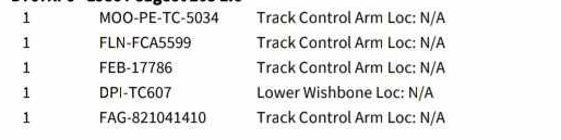

I asked a friend in a factors what they can get and these are their listed options. Febi and Delphi are known to have had the defect, I've gone with a Moog one. Let's see what turns up.
Any advice on actually removing the thing would be great!
Take the front bolt out first, wiggle the arm.
Of that list most are oem suppliers l, f.a.g being highest regarded
Yeah but FAG primarily makes bearing material ..
Demand for 205 suspension parts is a bit low , hence only a few are still made in EU and the rest being Chinesium repacked crap .
Moog on the pictures looks like the rest , aka item defective . Unless you get lucky and they send you an old stock wishbone .
At least be sure you can return it back on the spot if it's bad one .
From the lot on offer nowadays (most of them unknown) as said in previous post about it i'd try my luck with Teknorot .
They are in Turkey , and they produce specifically suspension parts thus least chance from the lot it'll be repacked import crap .

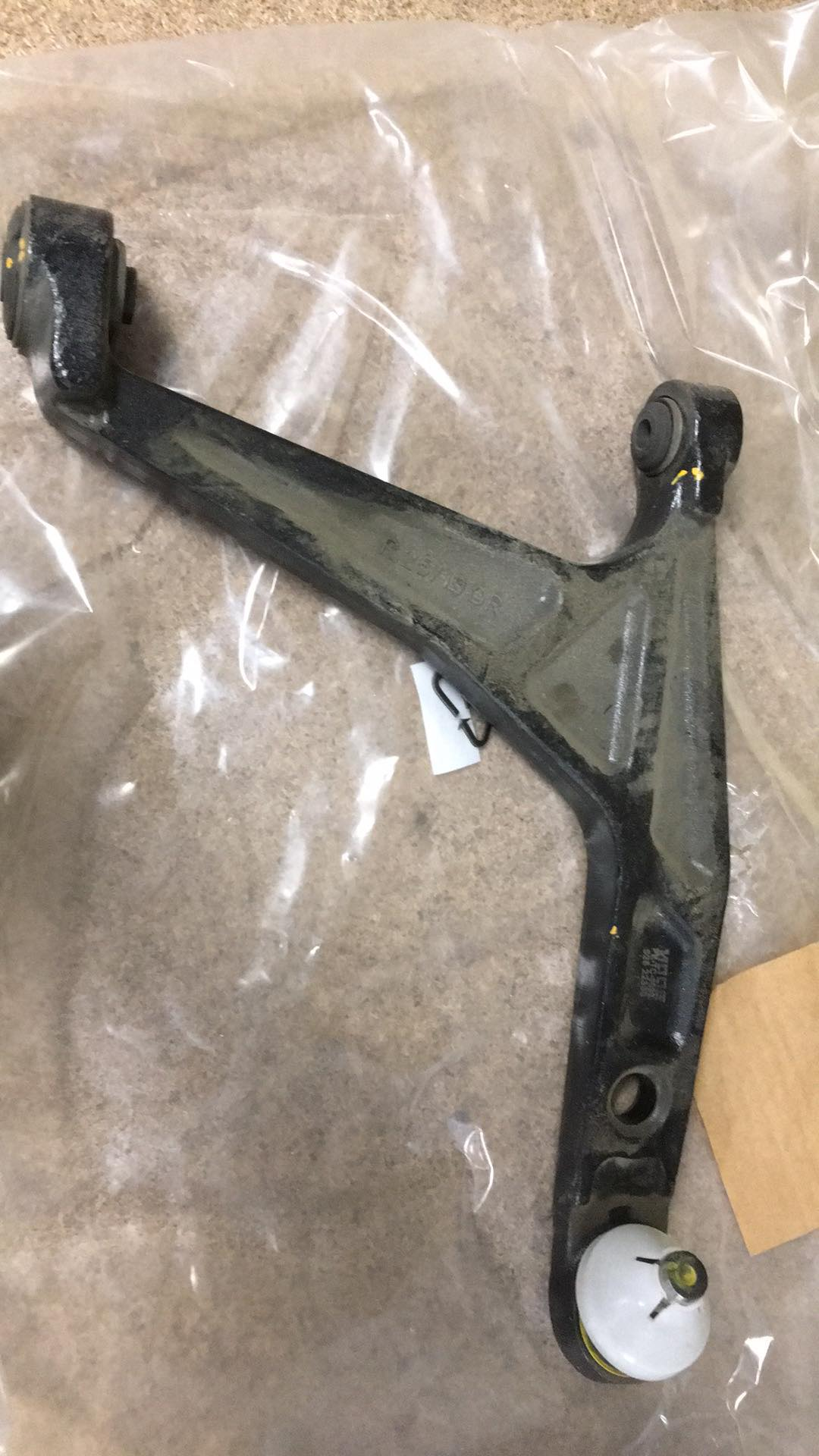

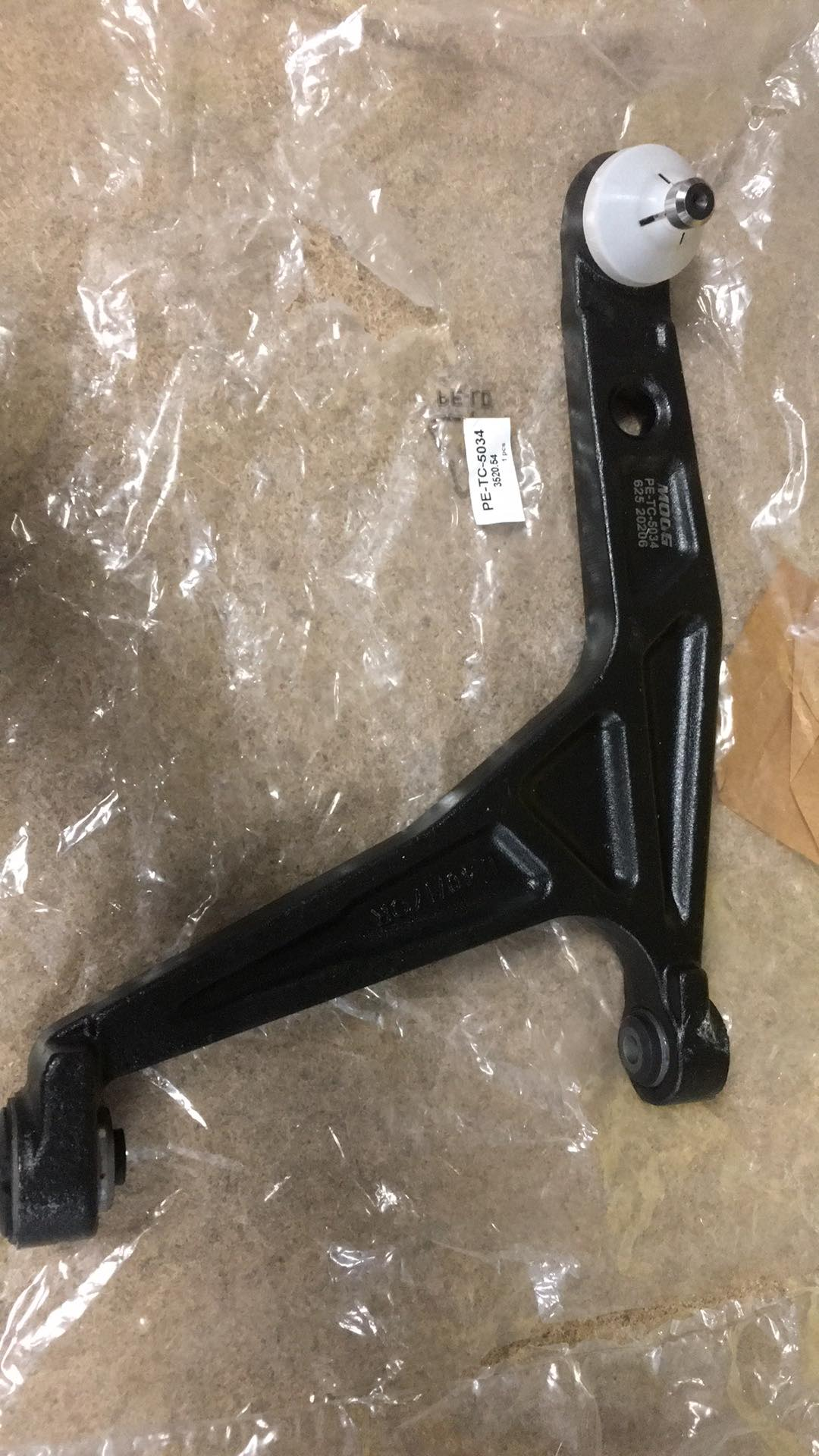

The FAG part is NLA. The Moog one just arrived to the factors (they ordered both NS and OS), I won't get it til Friday but they shot these photos over
Looks like NOS with the correct angle (to my eye) so I think I've been lucky.
Edited by artois7
chris 417 mi
Yep that looks like a good one

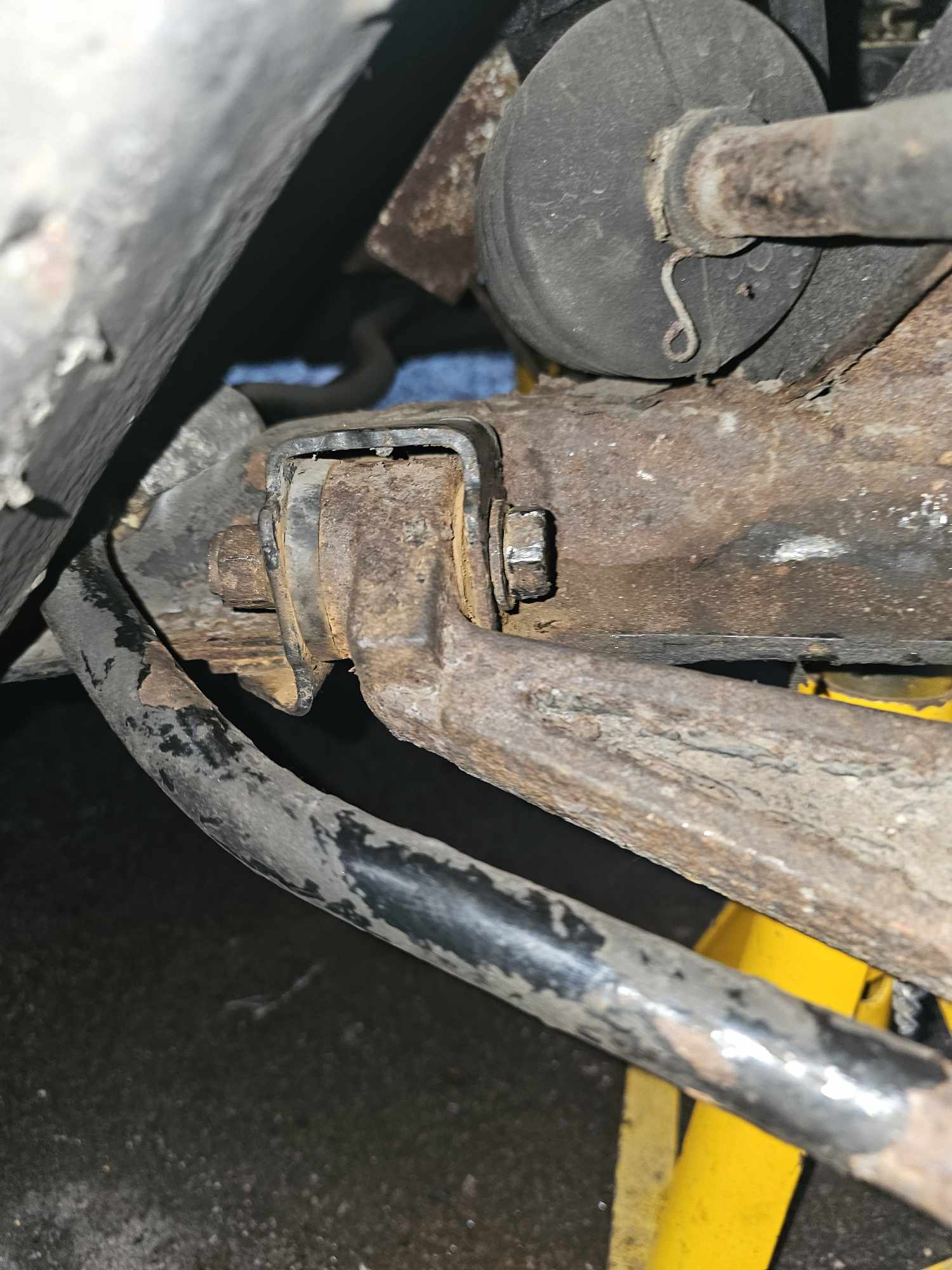

Struggling like mad to actually get that rear bolt out. The nut came off no problem but the bolt is stuck fast, I managed to shift it about 2mm by rotating the ARB up out of the way, then getting a long extension and a lump hammer on it. At this point I might have to cut the head off of the bolt and try to drift it through from the other direction.
Mental how much of a fight it is putting up. The front came out no problem at all.

Spent a good while doing that last night, It will rotate separate of the arm now but no outwards movement.
Has the bolt seized to the steel sleeve in the bush?
For what it takes it might be easier to just drop the subframe off the car, its only 20 min work.
drj545
Bit of heat with a blowtorch, or failing that cut bolt head off, tap through a bit, cut other end off, tap back in and then and slide out arm.

I believe so, yes.
20 minutes work for anyone half competent, I am 99.999% confident one of the subframe captive nuts will end up spinning off and I'll be in a world of hurt.
Annoyingly my blowtorch got misplaced during a house move, but cutting off both ends is a solid idea.
