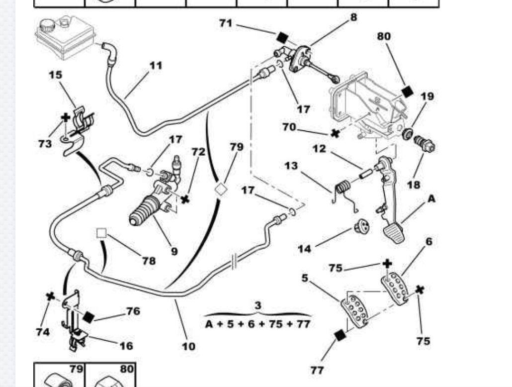

This is the BE4R parts from the 206 GTi, and possibly others. Is it possible to adapt that slave cylinder and arm to a BE3 box?

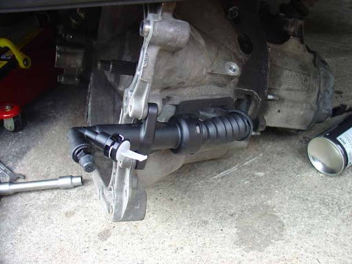

Some previous discussion here
Also a lot of the BE casings do have the mounting lugs at the front which would allow the 206 type slave to bolt on. Then use the BE1 style release fork.
From Google, but you get the idea.
