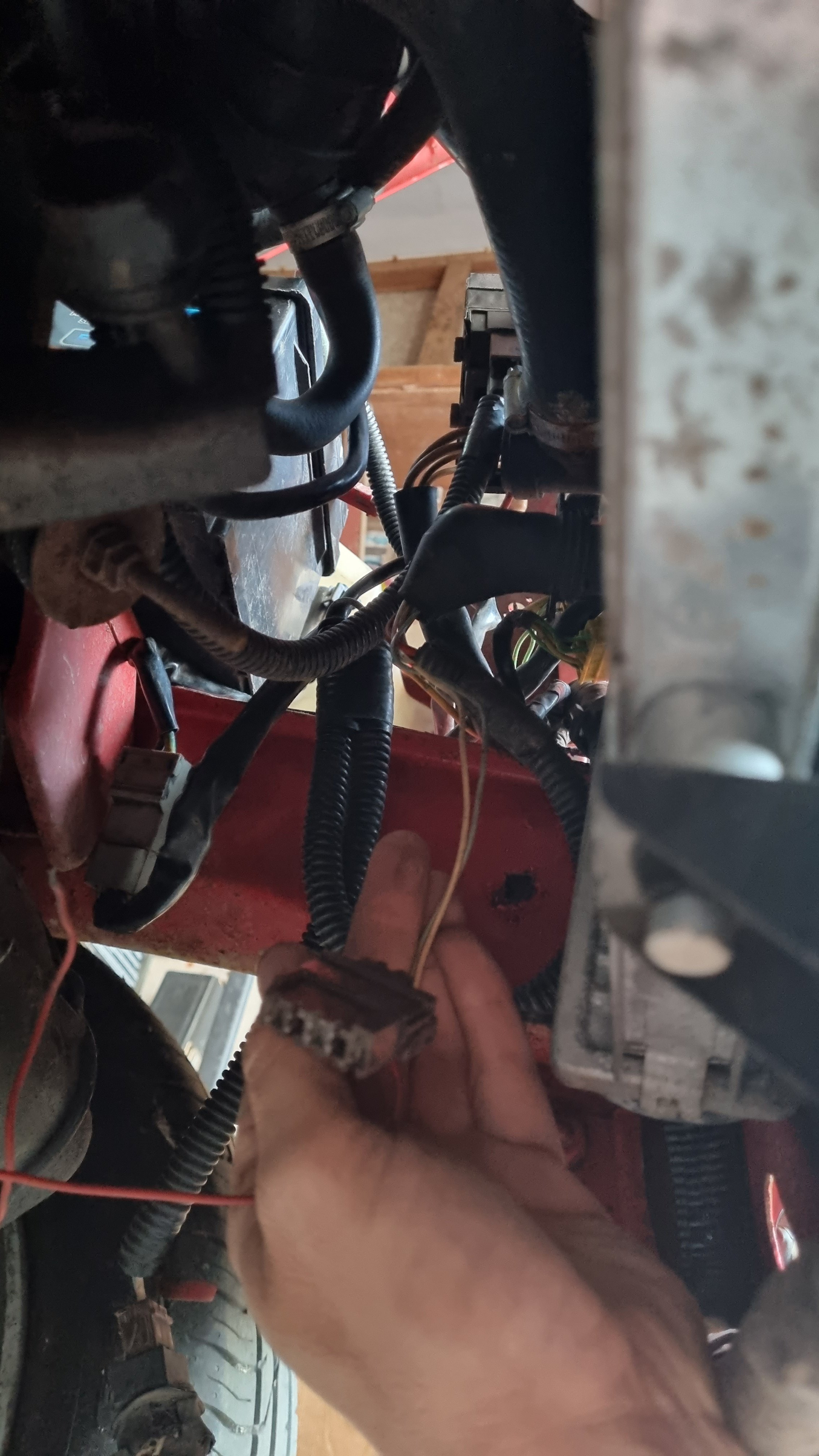

I have come across something which has stumped me, hopefully the pictures come through OK. But essentially, there is a brown plug which comes from the wiring to the radiator sensor, which I assume is the sensor for the fan to come in and out? Anyway, this plug is not connected to anything and in addition there is a red wire which is also doing nothing. My car runs, gets upto temp and the fan cuts in and out, but I am curious as to what this element of wiring is.
More than happy to get additional pictures and discuss further.
Thanks in advance,  Gareth
radiator fan test point, the centre pin is live all the time, low speed if you join one of the outer pins, high speed if you join the opposite.

Perfect, I had read about a diagnostic plug,but I just couldn't work out if it was this or not.
Guessing it should be up near, or behind the passengers headlight so it's out the way and there to access if required.
Thanks, Gareth
