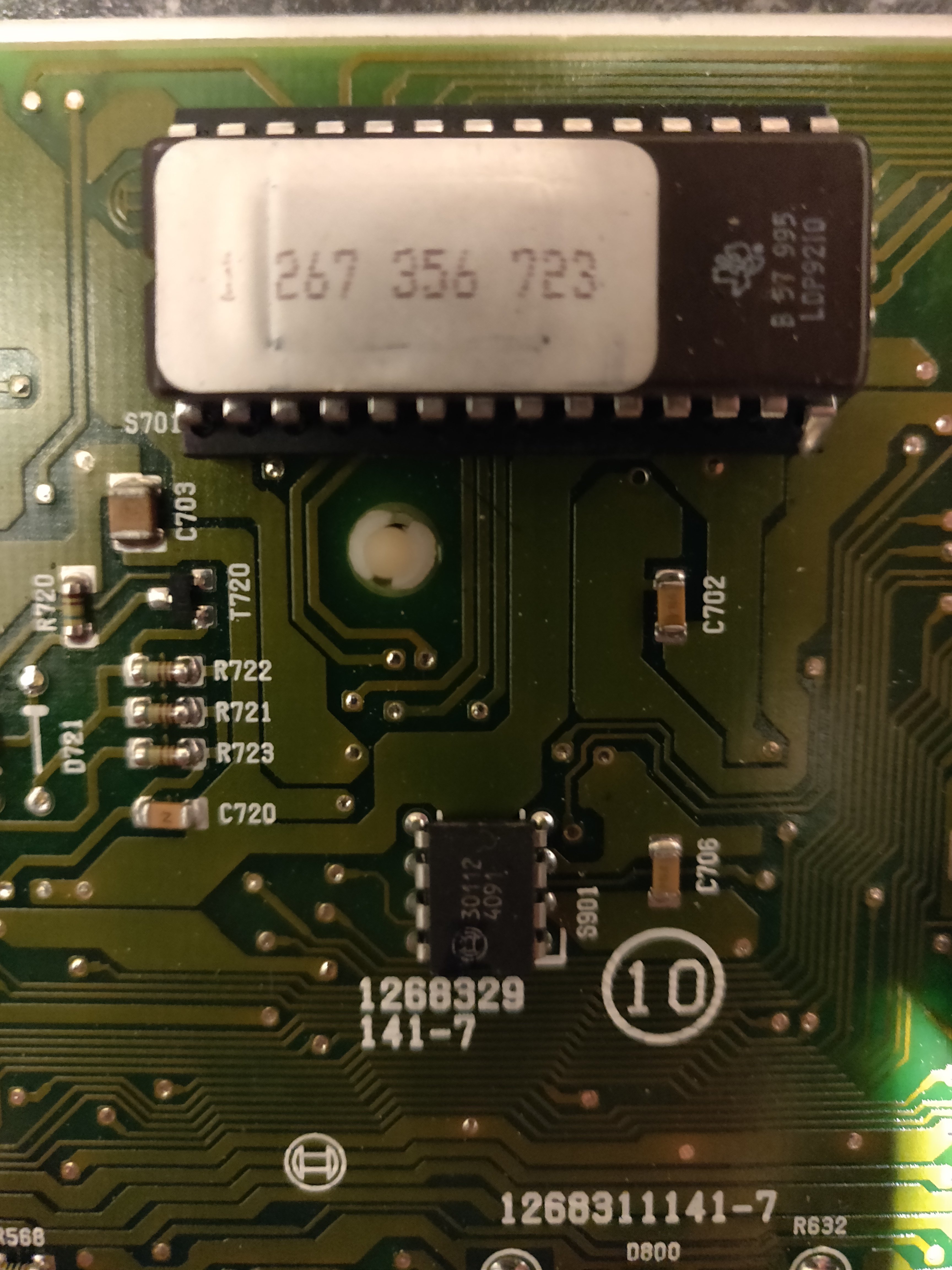

Was the EPROM original with a bosch sticker that has the software revision printed on it? A poorly modified EPROM should still have the original checksum and trigger the 54 "bad ECU" error code so it's a bit strange.
The image is the EPROM in the ZX *212 ECU. Not sure if that's original looking, as I've never had one apart before to be sure about them.
I'm wondering if someone has messed with the map on it possibly?. Which may not flag an internal error code but would make it run badly without logging an error. Not sure how correct I am with that.
Is there anyone on here that can write a new EPROM?. I wouldn't be able to do it but will check with ACT tomorrow if they still have the tools for it.
Edited by 309jazzpanda
SRDT
1 267 356 723, I even have this file so the sticker looks factory.
