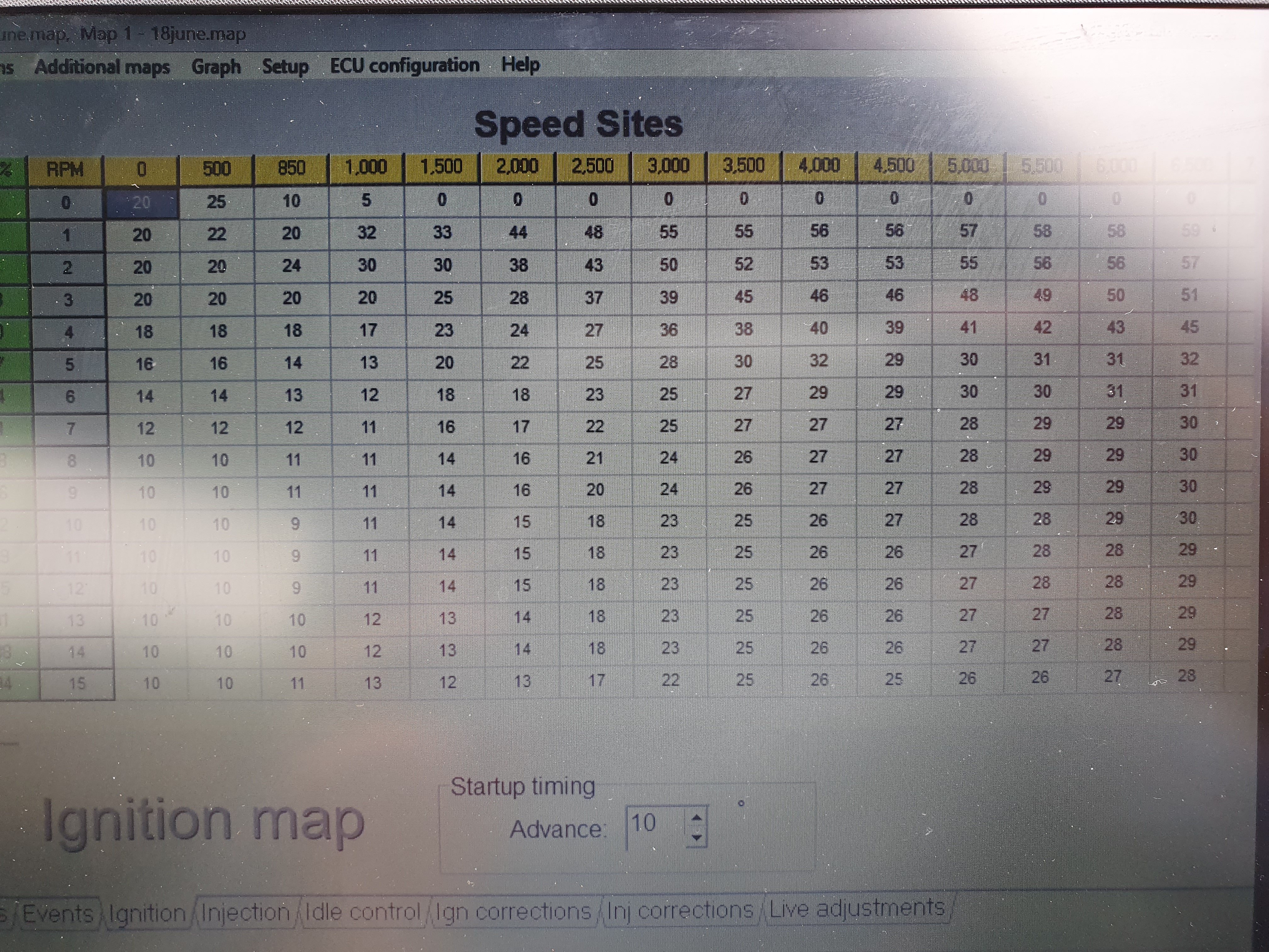

Sure I'll grab a screen shot off my laptop for you
On 6/15/2024 at 9:21 PM, Richie-Van-GTi said:
 Paul could you share a screen of your ignition table
  • Thanks 1
Richie-Van-GTi
On 6/18/2024 at 4:22 PM, Telf said:
Brilliant thanks, is the green column map or tps?
TPS
