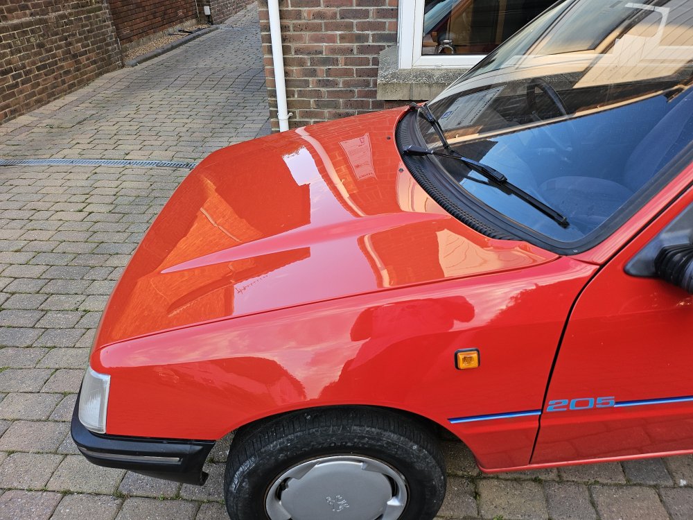

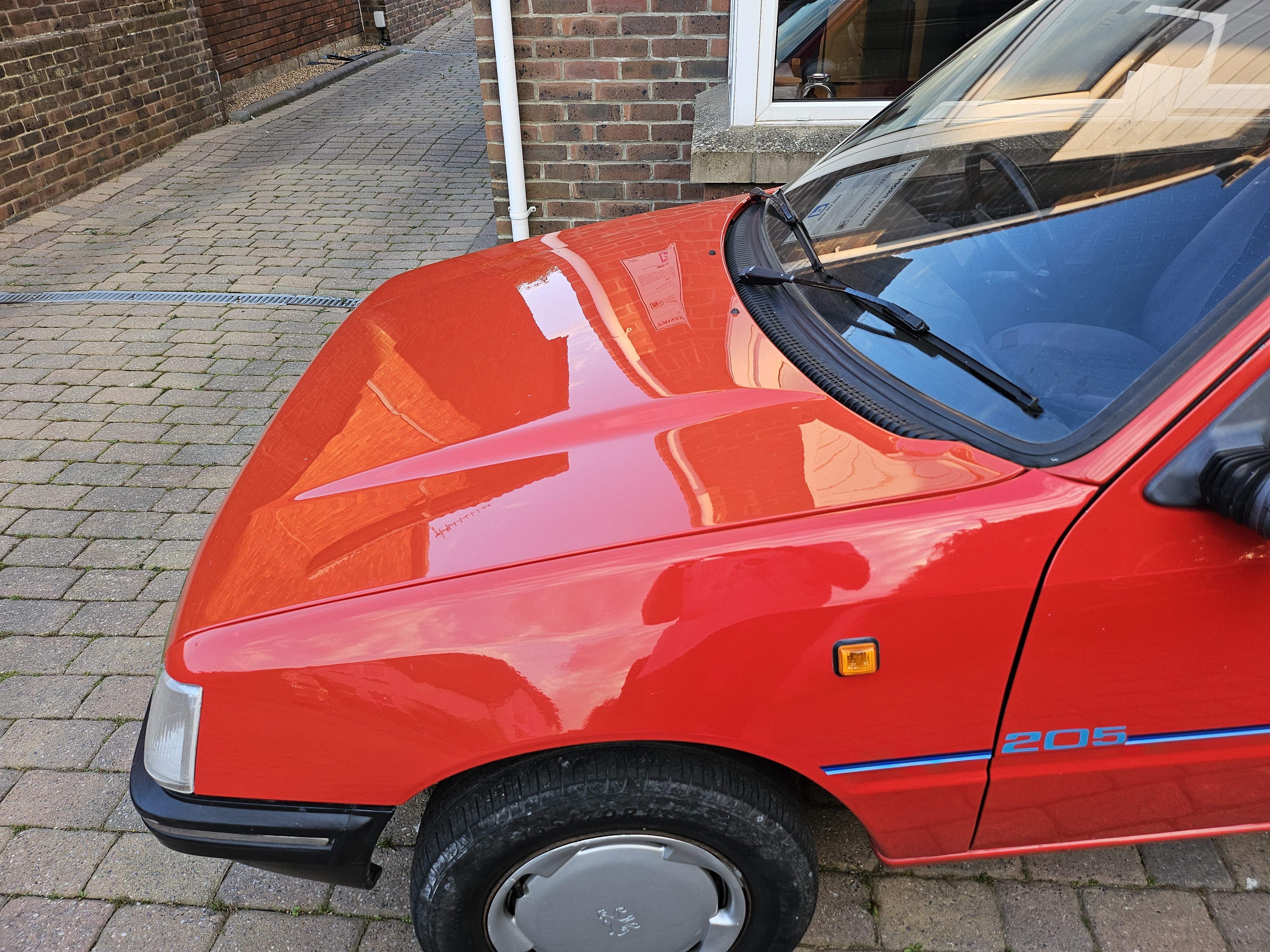

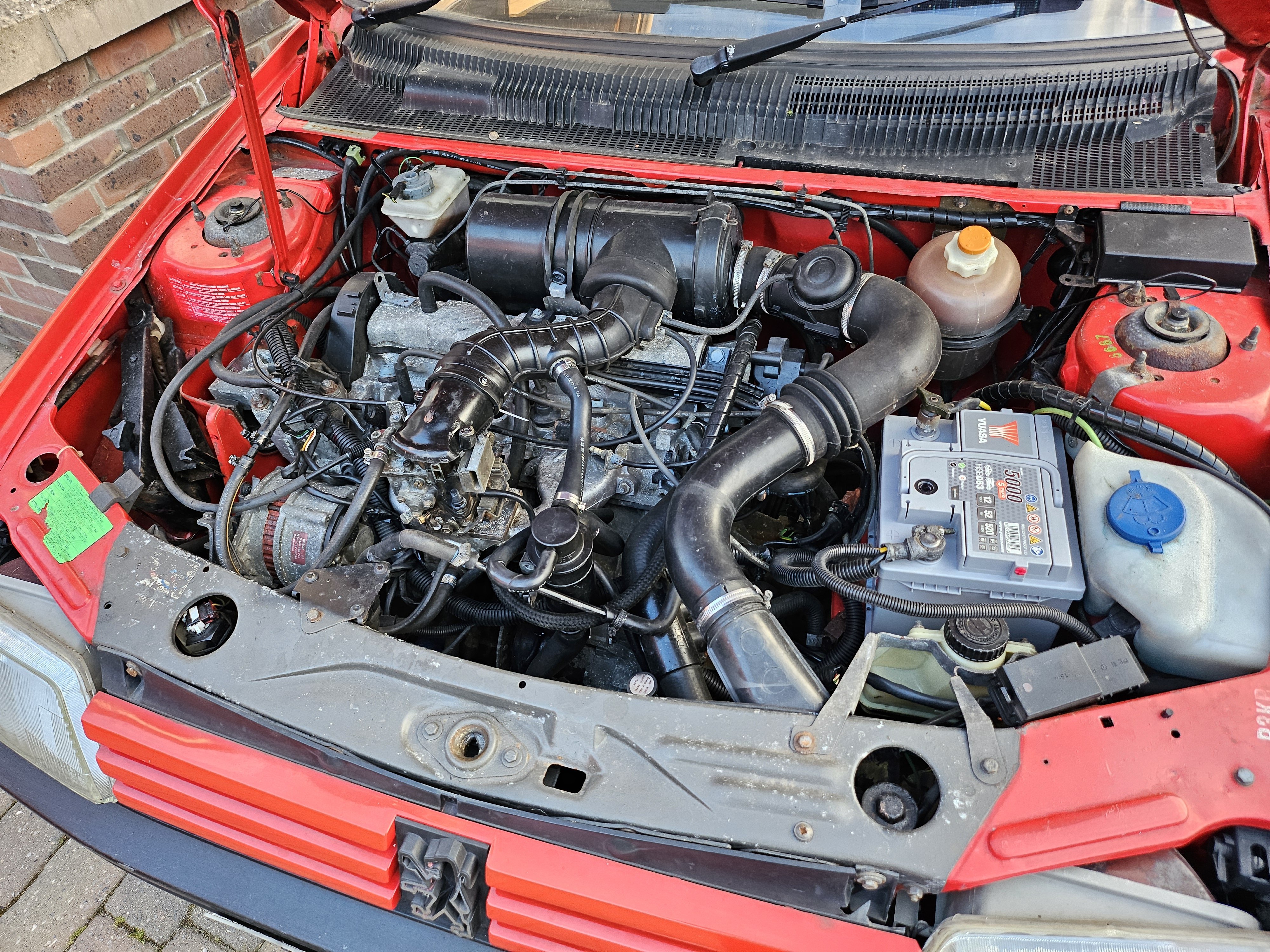

J_Steele 1 Posted June 6, 2024 Just got back from picking her up! Absolutely lovely after a good clean. So supposedly she's one of the last 205s sold in the UK, it's a Mardi Gras edition. Due to that it has a hump in the bonnet to fit a 405 overhead cam version so I'm told, it's also been converted back to a single carb from fuel injection due to an issue with the unit 20 odd years ago. I will have to rethink whether I want to upgrade the carbs or potentially go back to fuel injection. Other than that going to find some 13inch lightweight alloys if anyone can recommend? Share this post Link to post Share on other sites
SRDT 194 Posted June 6, 2024 The hump is for the carb/single point injection TB. The same engine with a GTI manifold doesn't need it. Share this post Link to post Share on other sites
J_Steele 1 Posted June 6, 2024 6 minutes ago, SRDT said: The hump is for the carb/single point injection TB. The same engine with a GTI manifold doesn't need it. So presumably if I were to attach a 1.6 GTI manifold, I'd be free to remove the bonnet in favour of a lightweight one? Share this post Link to post Share on other sites
SRDT 194 Posted June 7, 2024 Indeed, even the 2.0 iron block that is a bit taller can fit. Share this post Link to post Share on other sites
