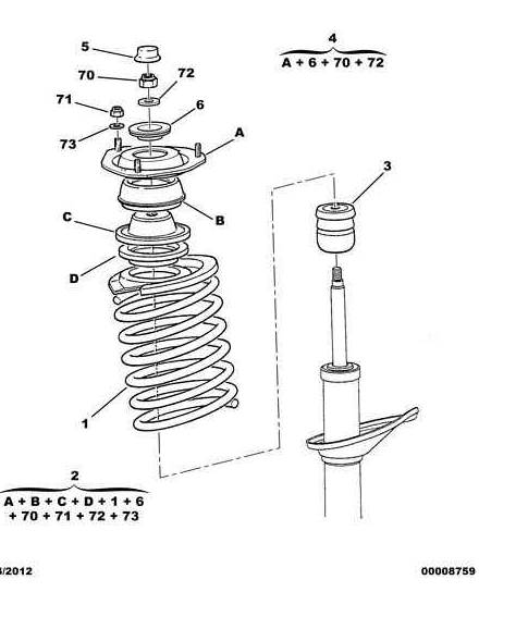

Hi all,
Been rebuilding my struts and I can't remember if the cone end of the bump stop points up or down. I fitted them with the cone facing the top but I have a horrible feeling they go the other way. Haynes is no help. Does anyone know how Henri and Pascal fit them? , thanks
There is a recess in one end for the large washer.

greenclaws1975
Thank you Gentlemen, looks like I'll be taking the springs off again.

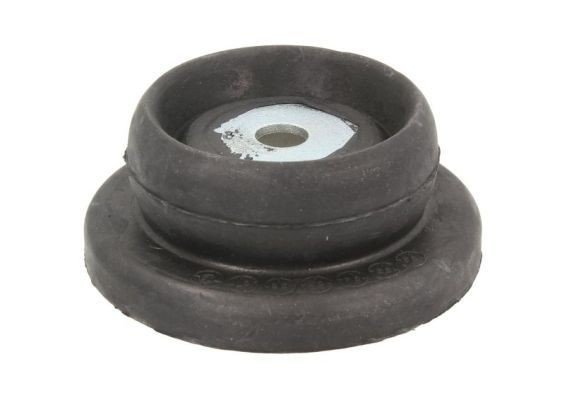

Are the aftermarket rubber mounts B softer than the originals?...I bought a pair from the motor factor's but they seemed softer and poorer quality so put the old ones back as they seemed fine...or maybe the old mounts have hardened and will make the ride harsh??
dunno, I've always re used the originals too !
i've refurbished 3 sets of struts while swapping springs from Petrol to Diesel, and the these rubber donuts (B) have all been in pretty good condition despite being 30 years old
the bearing (part C) have all been no good so replaced with Meyle sets
also, when reassembling your struts dont use your own diy spring compressors
do it the safe way and take em to a local mechanic that has a proper hydraulic spring compressor

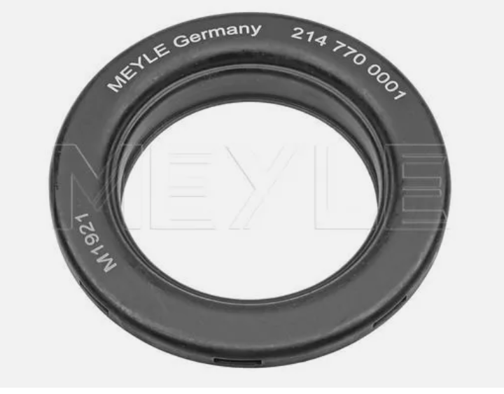

Gohn
oops, the bearing is part D
I weighed the old rubber doughnuts  this time I had them out and they are about 8% heavier than the new versions. So the originals went back in. Rather have old OE Peugeot than modern China crap.
Thumbs up from me for Meyle parts I got my lower suspension arms etc. from autodoc and they seem excellent.  Euro car parts were not very helpful.
