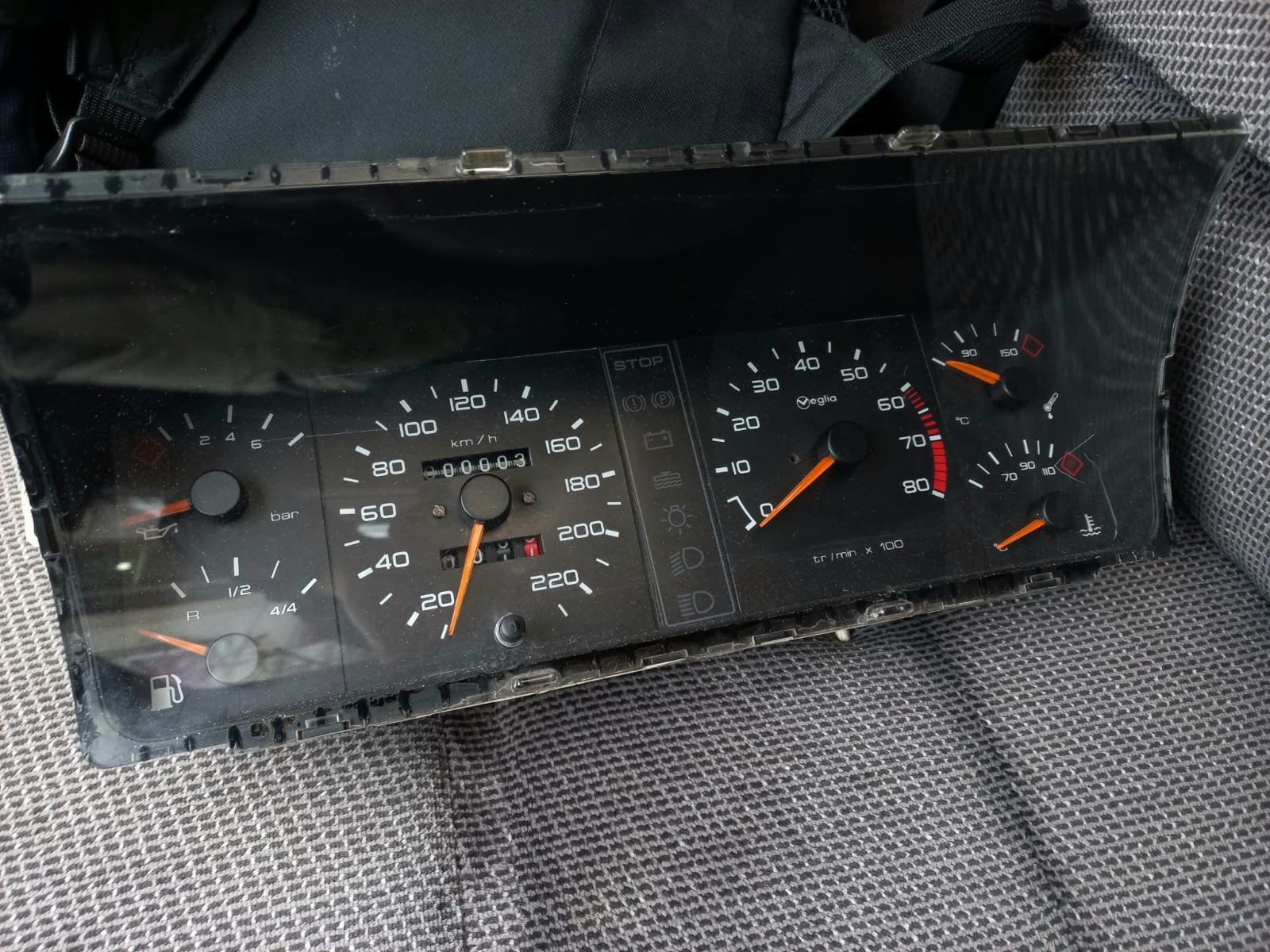

I've recently bought the GTI gauges and was wondering if it would fit my 205 XS with the carburated TU3S engine. What should I consider for the swap? Is it even possible?

It was done more than once, often on 205 Rallyes.

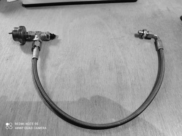

You need to look at your oil pan to see if you can screw the oil temp sensor, for the oil pressure sensor there isn't much room so it's often done with a relocating kit:
