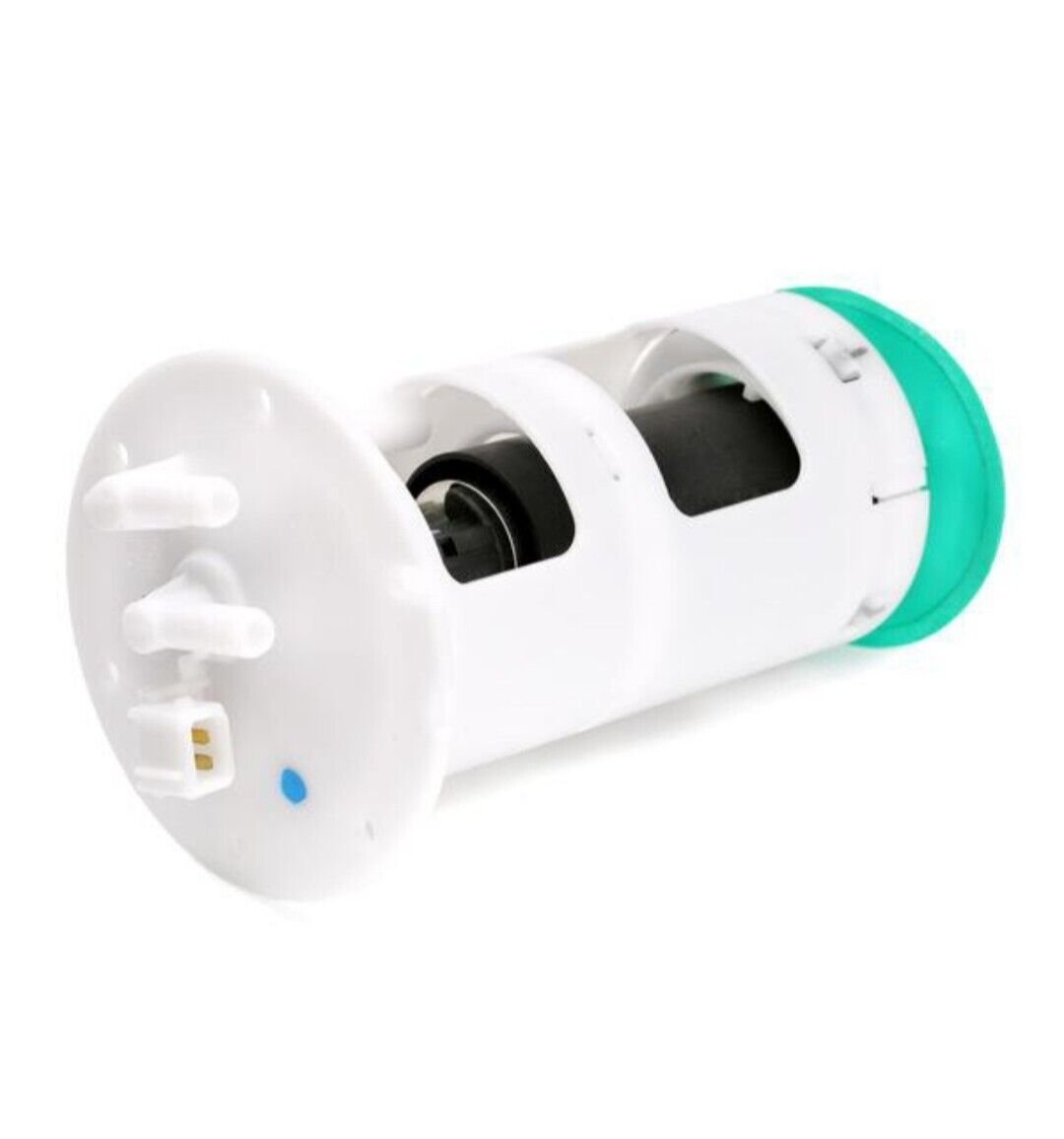

I recall reading on here that replacement pumps often need modification to fit, which I'd prefer to avoid. I've seen this recently on ebay, for sale here in France;
https://www.ebay.co.uk/itm/305536816767
  Also see picture of that one attached. The socket and inlet/outlet spigots at least look correct. Does this look correct and ready to fit without modification. Indeed has anyone fitted one of these? The vendor rather unhelpfully states "Brand according to arrival : Bosch, Meat & Doria, Stark ... Which probably means anything except Bosch!

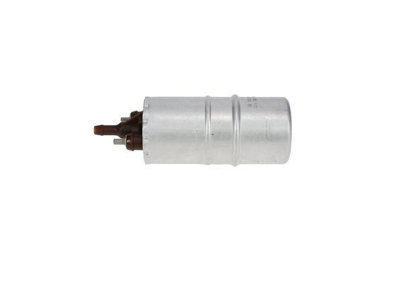

For a 1989 car with the black housing the pump itself is readily available from Autodoc for around £75 for a bosch unit, direct fit no messing.

 Thanks for reply, and yes, actually late 1989. Sounds too good to be true, and unfortunately that's the case ... Autodoc France : "Type de fonctionnement: électrique · Côté d'assemblage: dans le réservoir de carburant · Numéro d'article: 0 580 310 015 · Notre prix: 359,70 € · Fabricant: BOSCH ...
309,34 € · ‎Épuisé"  ... out of stock, and that's the same for Autodoc UK, except their out of stock price is £316.60.
Other vendors here in France also all state out of stock ... so clearly there has been a demand for these pumps, which means I would even more hope someone can also respond re:

What Mei said , non Ph2 205's have different pump and housing type , as well as the fuel tank - pump type goes along with the corresponding tank as an pair ie. you can't fit late Ph2 pump in early Ph1 or Ph1.5 tank and me thinks vice versa too ..
Yours being '89 model it'll have pump in a black housing , with bigger "roller cell" pump inside , part No. for just the pump (housing you do not need unless broken/damaged) :
0 580 464 993
0 580 464 998 (this one is often around 20% cheaper than the *993 variant , they're both the same so pick one which is cheaper ..)

  Good news is I can see both versions you mentioned available, however the images show two screw terminals. Mine has a plug socket terminal on the casing ... can I take it that it will have this two screw terminal unit inside?!
Laurence
0580 464 998 is £76 on autodoc,  i have fitted a few, swap the terminals from the original pump, same as you do on the earlier coils.

Hmm, have I got the right pump?! Now have the Bosch 0 580 464 998, and I've removed the "original" pump from the tank. Construction looks pretty different to the one depicted in the Haynes manual, furthermore a previous post by Mei stated "black housing" ... my "original" is beige, and it looks very much like the one pictured in my first post, even down to the blue paint dot. It only has one cut out section in the casing. It has Lucar (spade) terminals for all 4 internal connections, whereas the new pump has threaded terminals. Also the outlet is central on the new pump, but offset on the "original".
I'm reassured by comment that different Phases'pumps are not interchangeable, but is it possible the entire tank was replaced? The "original" pump, as mentioned before, isn't the one fitted when the car was built (late 1989) ... it is dated on the side 1/92. The Bosch number impressed on the top is 0580310003. Looks like this:
 So, is this Bosch 0 580 464 998 correct to fit inside that?!image.png.4974756f673867b0417bbef67ae11b54.png
Edited by lagonda
include photos
If your pump is that white housing, with a JPT style plug, its a phase2.
in which case your new pump body will not fit,  you need a replacement which matches 0580 483 052     (had a pump out of a 92 cti in my hand yesterday)      apparently a systec   GSS342  walbro pump will fit, they do need the additional sleeve some are listed with as they are about 4mm smaller o.d.
