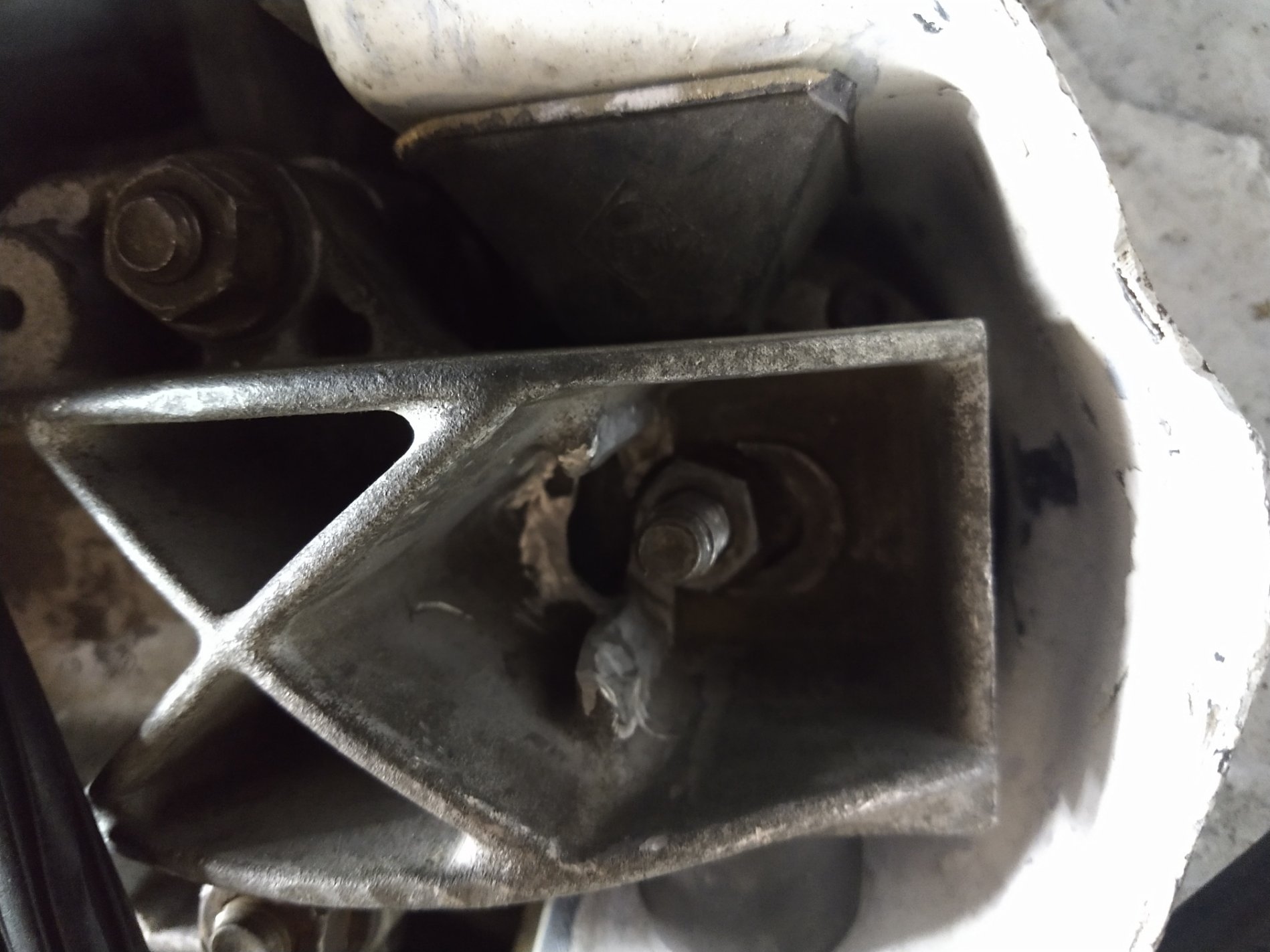

The engine moving is achieved by slotting the upper engine mount, its crude, but the only solution that has allowed the car to keep racing, when you look at the photo, remember we have to allow room for a socket.  We also have to fit a spacer behind the battery tray.

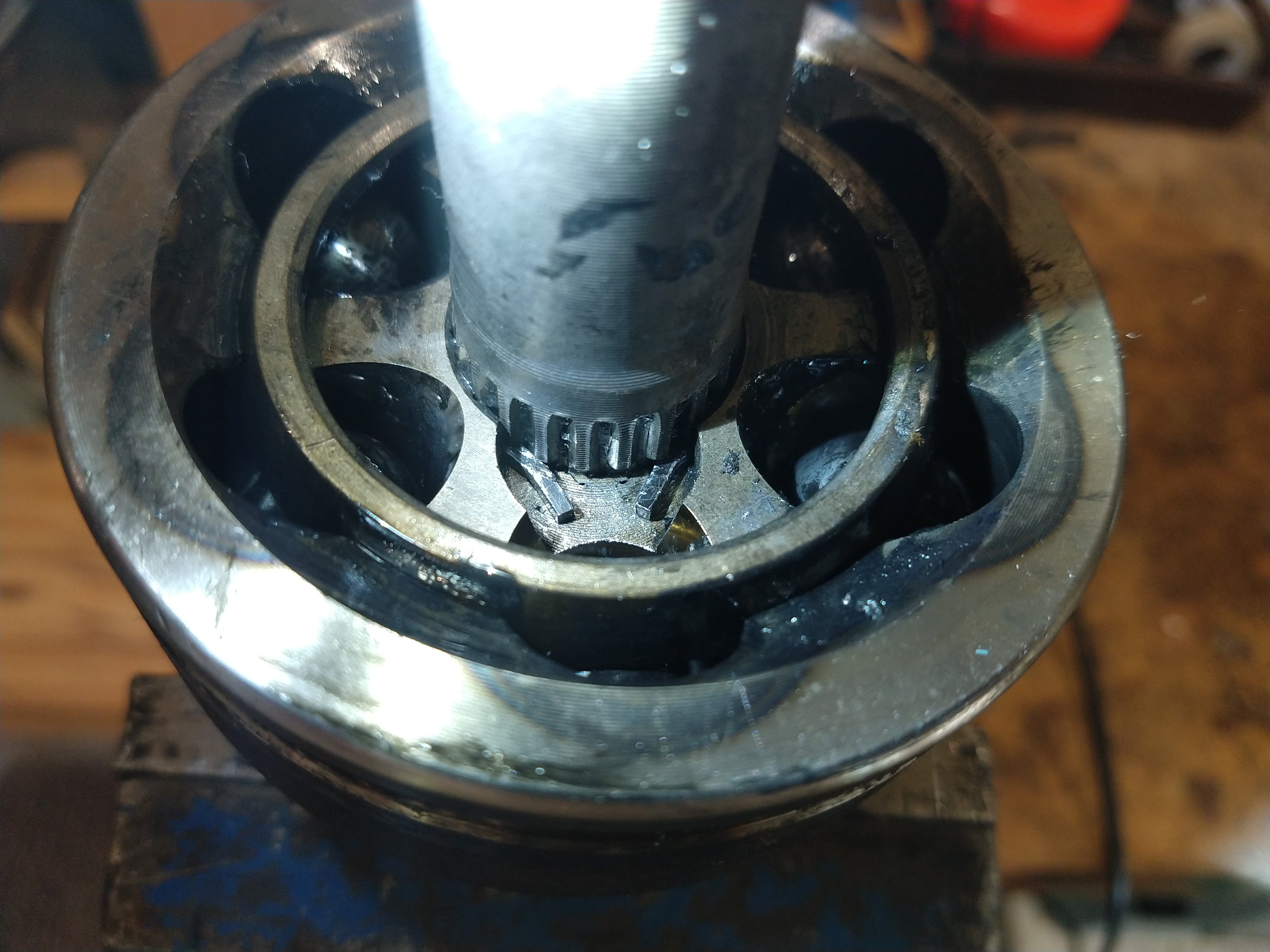

I now have a plan to shorten a drive shaft, but need to strip it down completely.  I am baffled by the strange circlip on the inboard joint, rather than 'eyes' it just has two 'horns' , The circlip moves very freely, which is good, but I'm finding it much more awkward to push those horns apart.  I've struggled with long nose pliers, but still can't slide the spline.  Am I missing something?
ArthurH
I thought I'd better include a picture of the circlip 'horns' I was trying to describe.  Is there a particular technique for holding these open?  While drifting out the spline....
I'd try a pair of external 90 degree circlip pliers and try to open the clip up with those.
  • Thanks 1
ArthurH
Thanks Tom, I did as you suggested and it made all the difference, I had the shaft out within a few minutes.

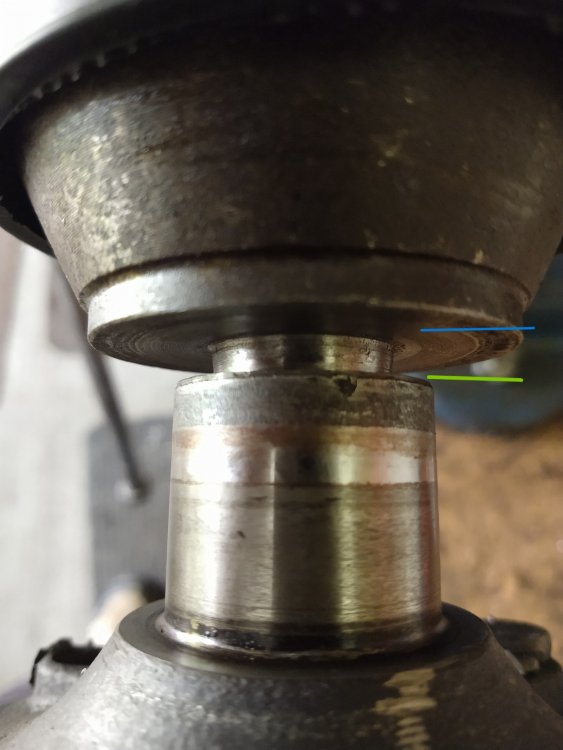

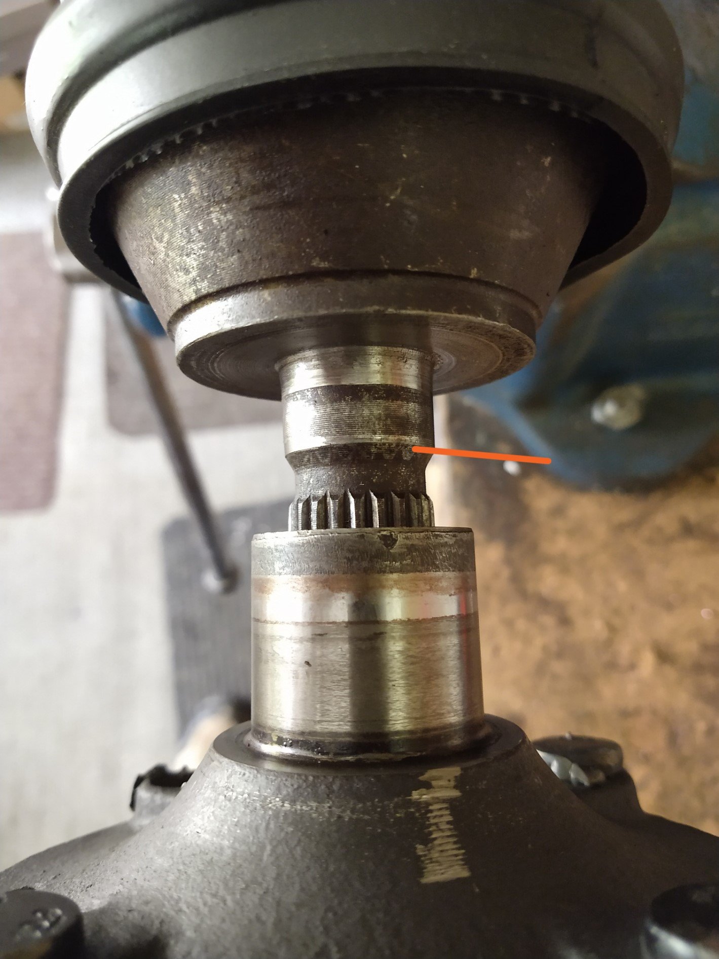

I have been thinking a lot about how these components bolt together, and I do appreciate the bearing isn't shown in these pictures, but I am still concerned about which surfaces are clamped together when the hub nut is tightened.
I had expected the end of the flange (green) and the end of the DS housing (blue) would be the two clamped surfaces, but the first photo shows it as far on as it will slide.
The second photo shows what is clamped, the internal splines press on the raised edge (orange).
IMHO this is not good design, there is little control over how much those hardened splines will sink into the housing edge.
Have I got this wong?
Yes, they clamp the bearing.
The drive flange and register on the cv joint clamp the inner race of the wheel bearing.
ArthurH
Ah, thanks guys, the (QH) bearing width is listed as 34mm (albiet mine is a fraction less), but the current clamped gap between the back of the flange and the front of the (modified) DS housing is 38mm.  I will need to relieve the edge I marked in orange by 5mm so that it clamps the bearing properly
