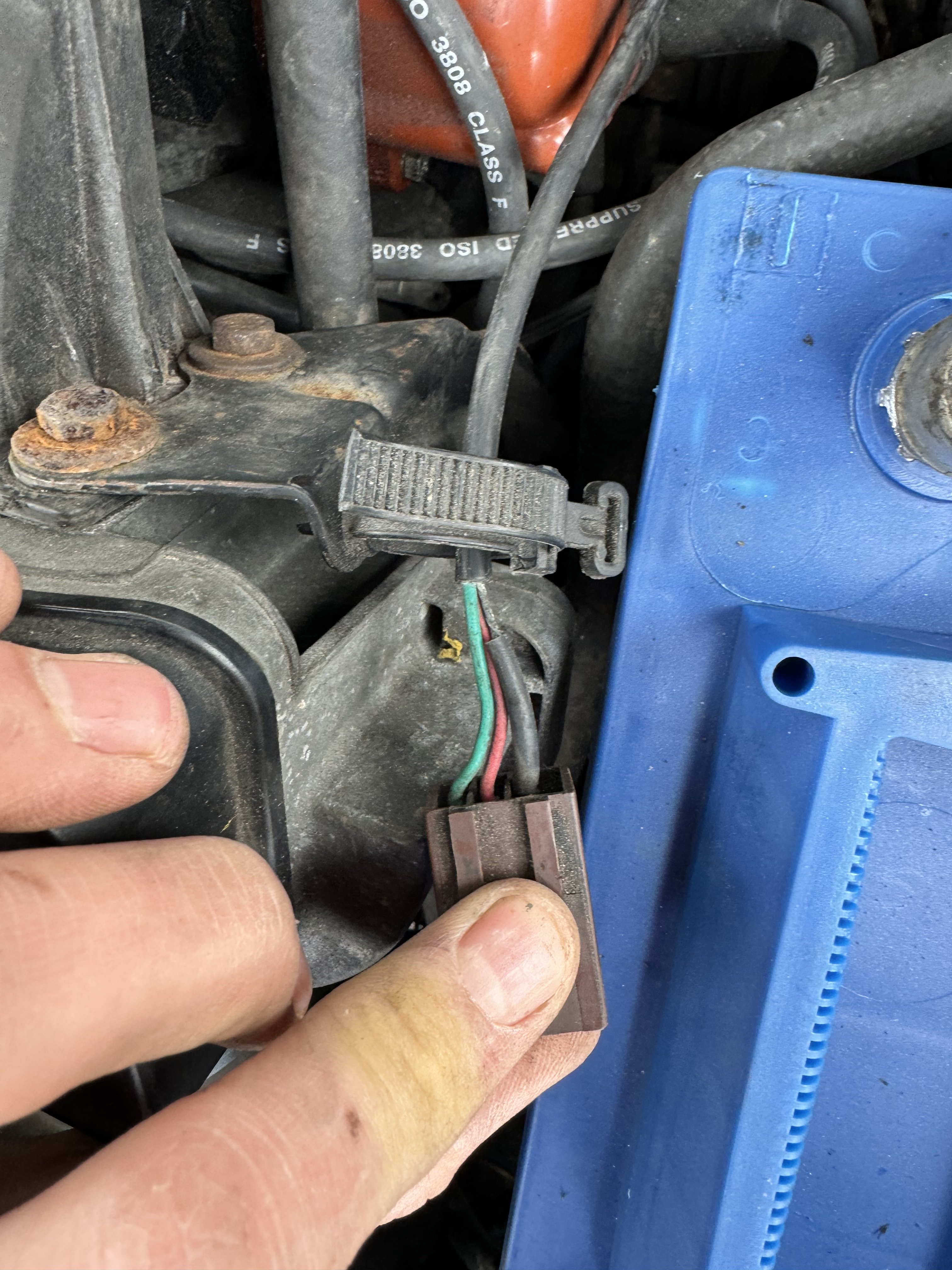

Oscar12345 0 Posted March 31 Thank you for the speedy and very helpful response. Is this plug you mean. This was disconnected at back right of engine. Share this post Link to post Share on other sites

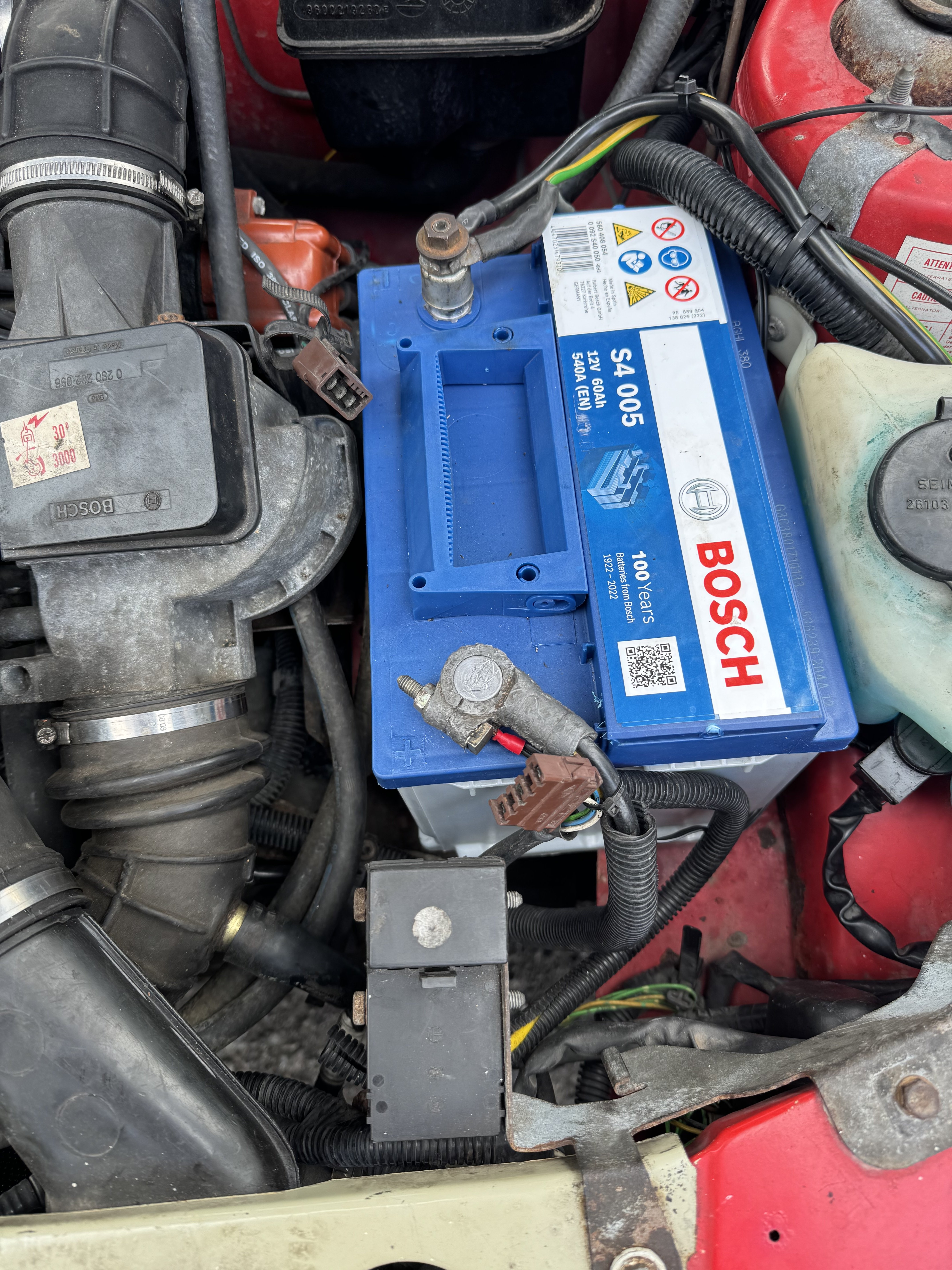

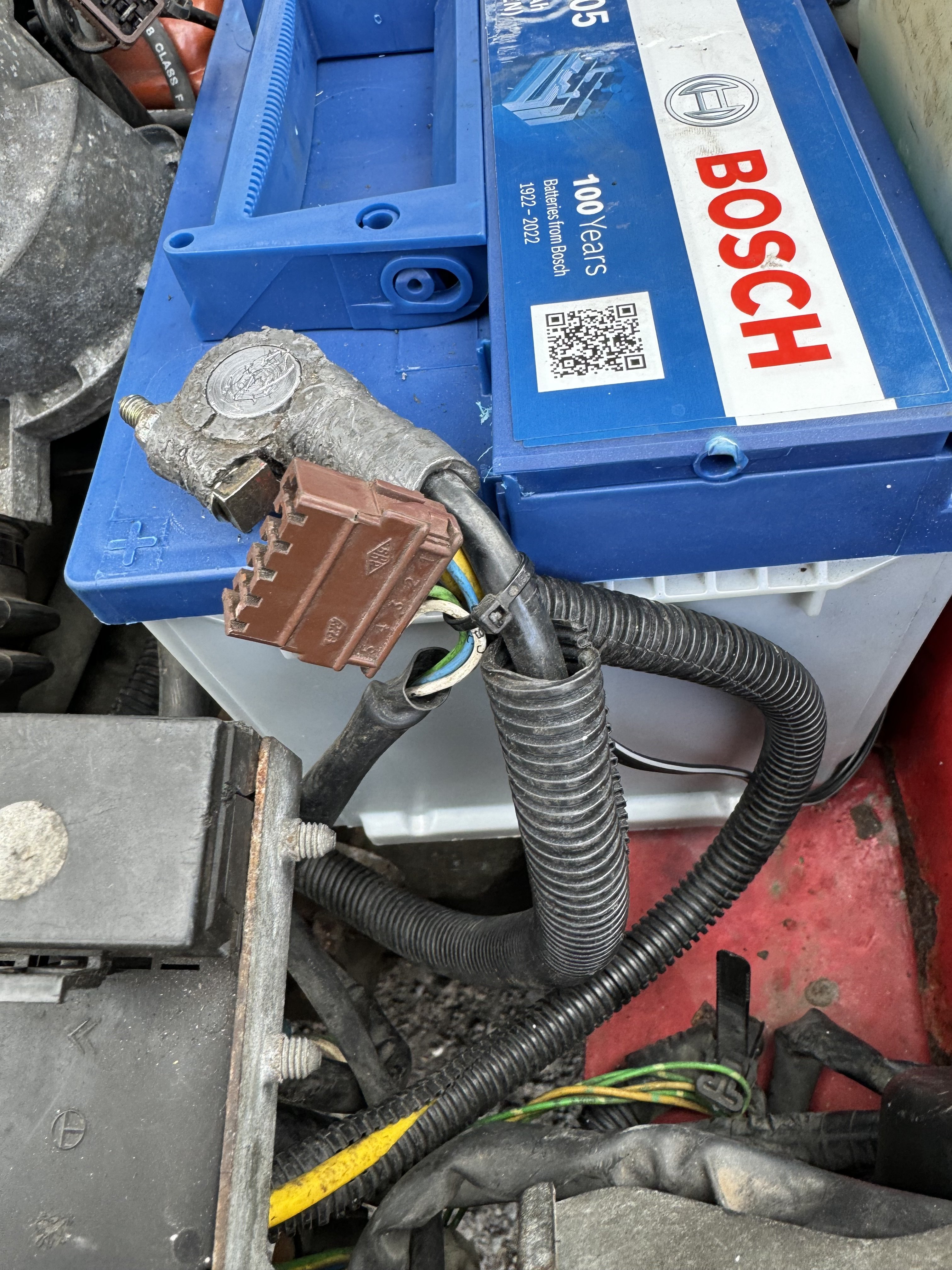

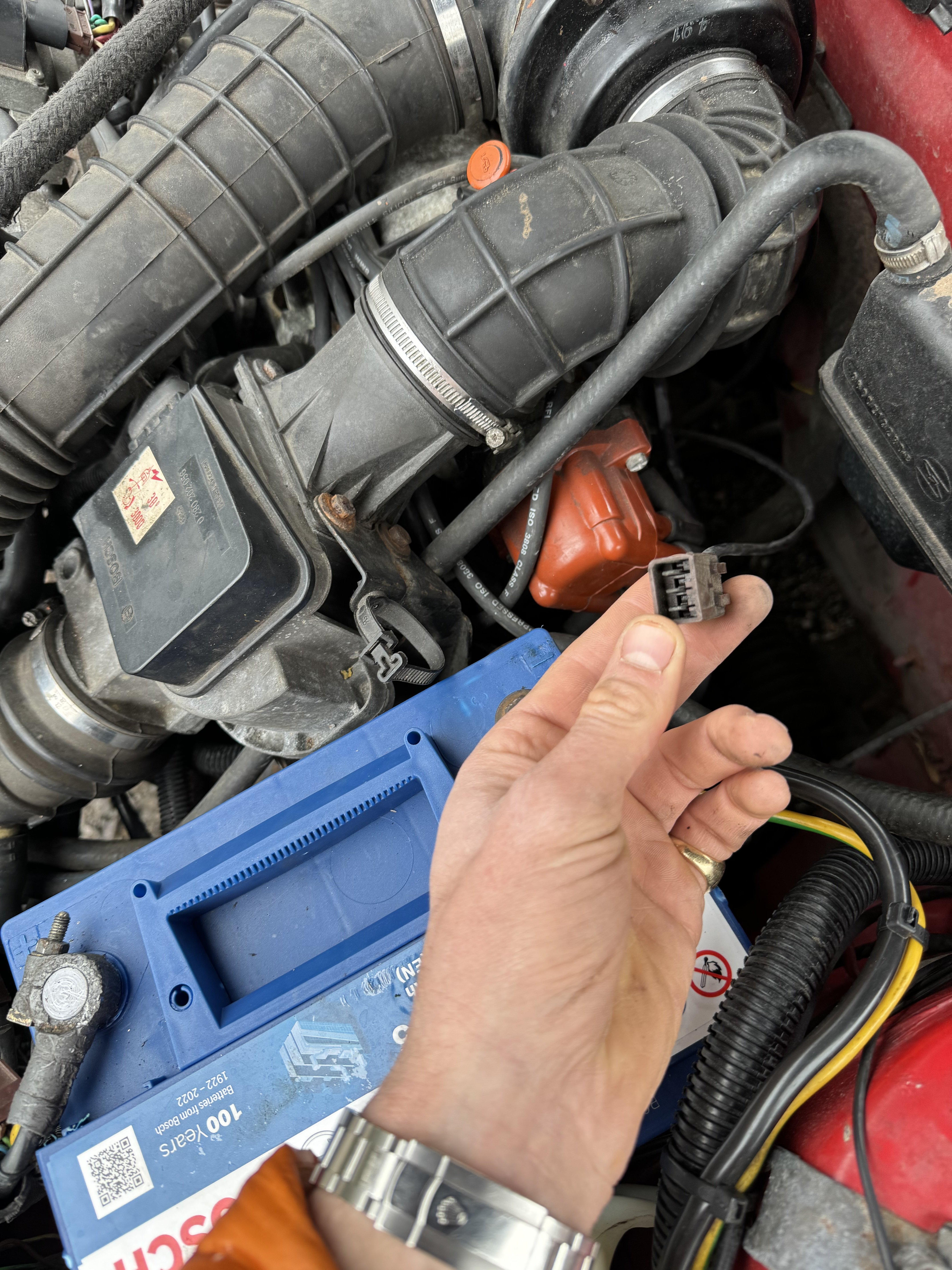

Oscar12345 0 Posted March 31 Also, a few more connections I’ve taken pictures of that are not connected to anything. I’ve also noticed there is no horn also. I guess one of these cables could be for the horn. another question is can I fit any horn or does it have to be a specific 205 Gti? Share this post Link to post Share on other sites
welshpug 1,650 Posted April 1 (edited) Both spares, the one by the battery is a cooling can test point, shouldn't be tied to the battery lead really! The other is an unused engine speed sensor used for old school diagnostic tools. A 1.6 gti would have an electric horn below the left headlamp, the earth next to the headlamp is a common cause of electrical issues. A 1.9 has an air horn in the same location with an electric compressor, run through a relay. Edited April 1 by welshpug Share this post Link to post Share on other sites
