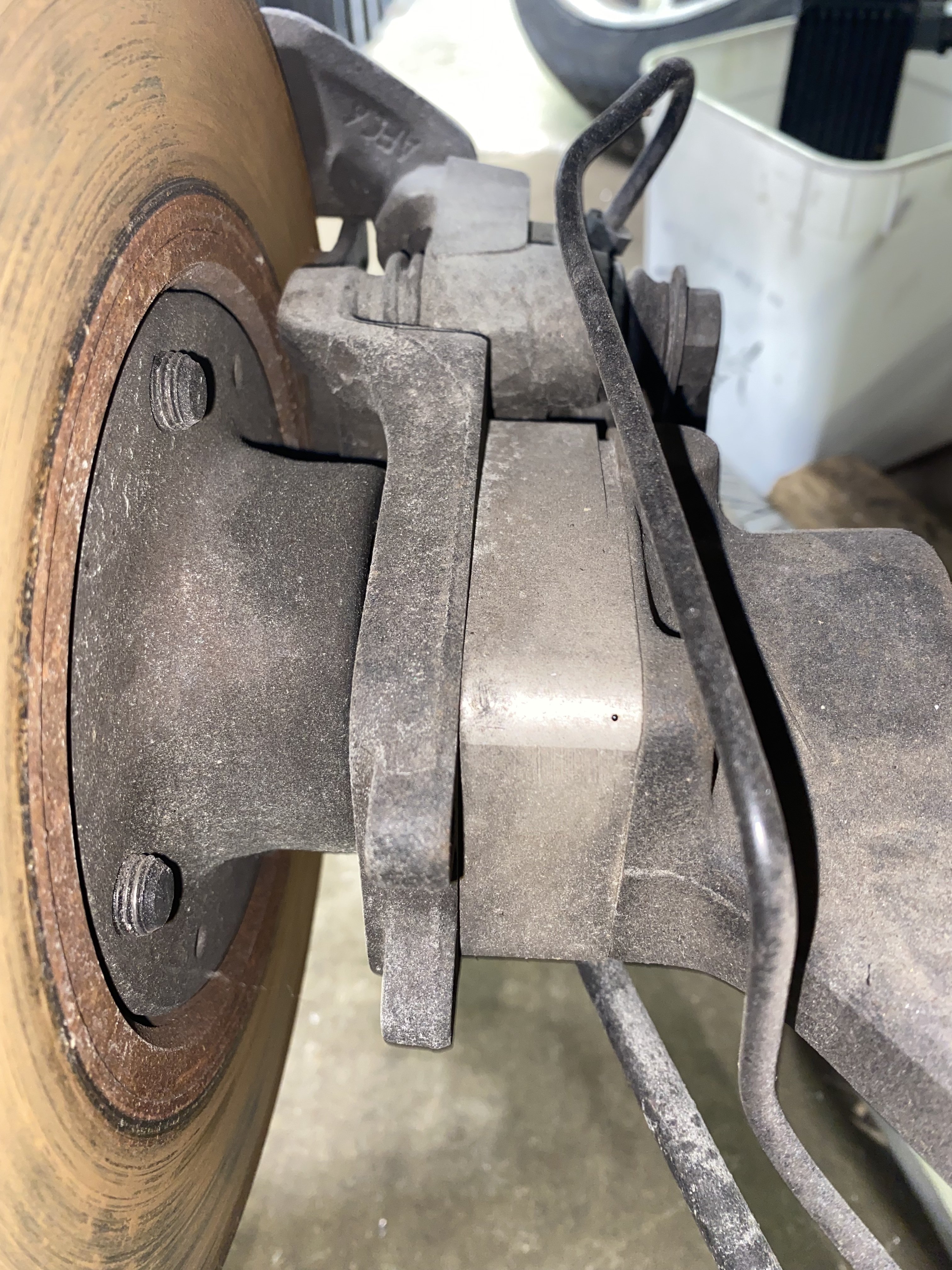

A pair of 207/208 rear wheel swivels with discs and calipers can be adapted on a 205/309/306 beam:
Richie-Van-GTi
What does this gain? Guessing it means drill the trailing arms, what about brakes?
jord294
Very shortly I'll be supplying 309 width 205 axles
SRDT
It should be a bit wider and it's easy to make a spacer, brake caliper bolt on part n°6.

Here is my solution. I lengthened the axles by 25mm and added the same thickness spacer. It's easy with the Bridgecraft arms, as they bore out the hole to Ø29 (from Ø25) when changing the camber/caster. It would be easy if you just wanted extra track width, as you could get someone to bore them straight and enlarge slightly to remove the spline damage. I'd take the opportunity to add some camber however, which does complicate the job.

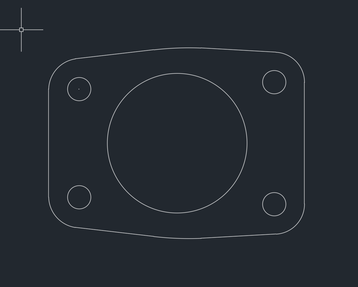

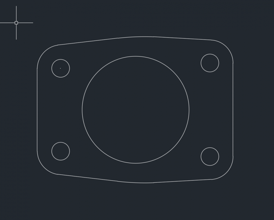

I'm guessing you'd like a copy of this DXF file?
Richie-Van-GTi
I wouldn't say no, saves me measuring it. Is yours just aluminium?

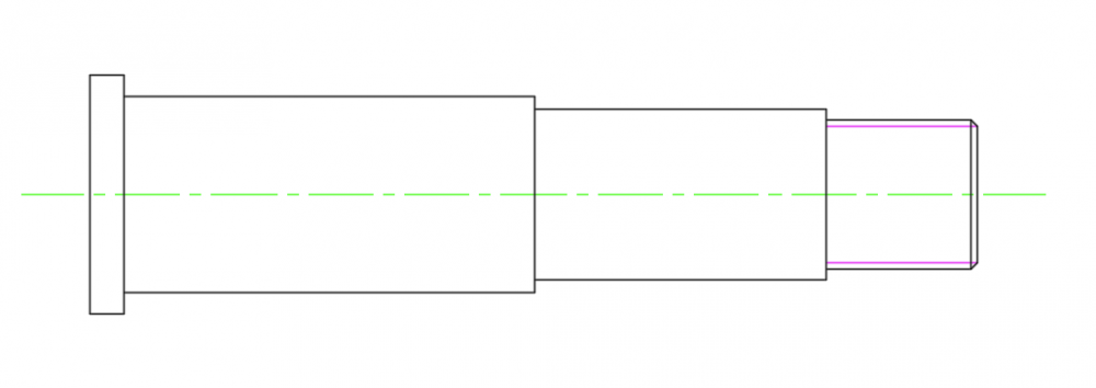

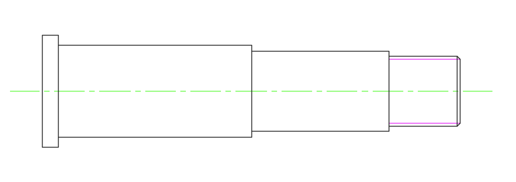

Did you out a sleeve around the shaft as well for the bearings to butt up to?
Axle looks like this. So no sleeve needed.
