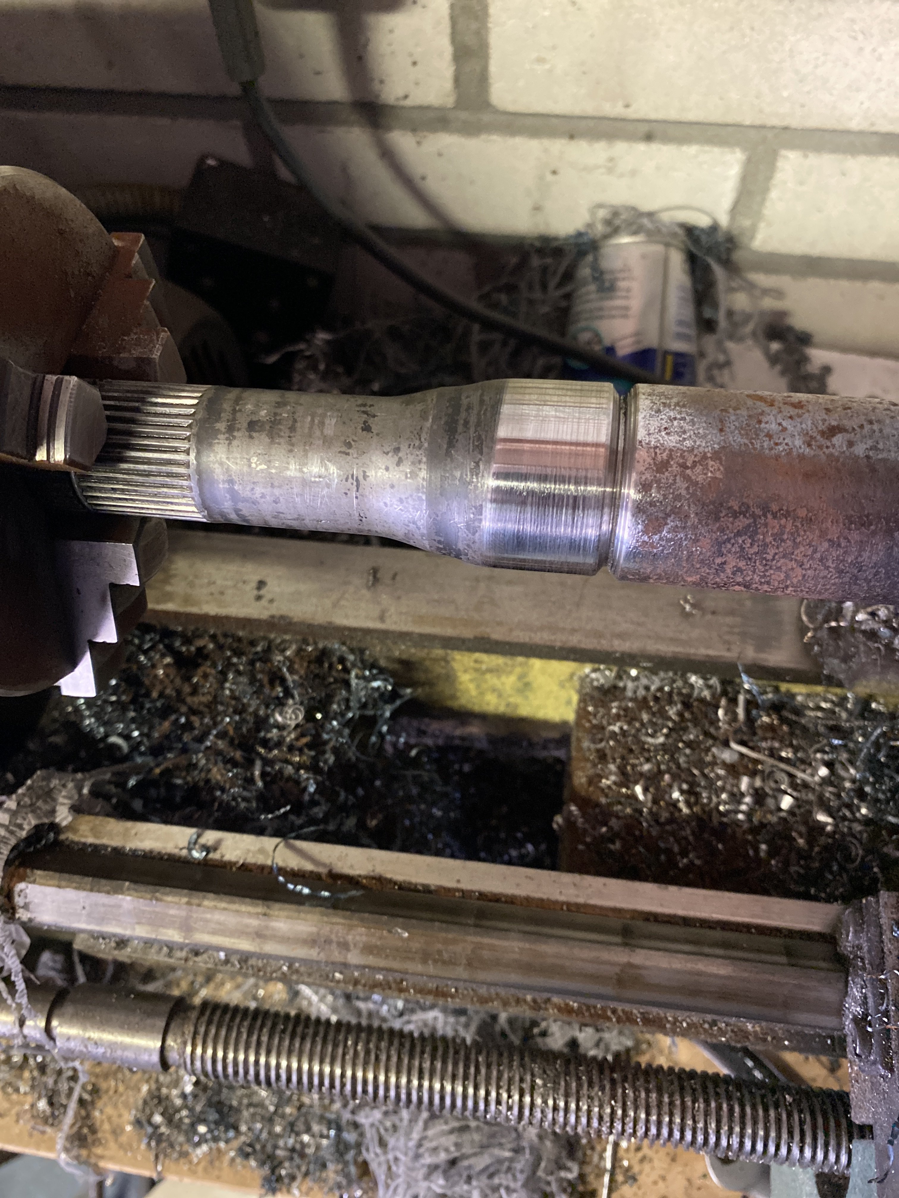

Arthur
Yeah. I just done the my trailing arm out of 25cromo4 and welded that with cromo rods. Didn’t seem too hard. But shaft seems even harder. I will try with good pre heating and see what I get. Is there a database of how long these shafts are this inners section alone.
Edited by Arthur
SRDT
Not knowing what steel PSA used it's better to assume you need to preheat and also let it cool in sand or inside an oven if you have a big one at hand.
A pressed sleeve and plug welds will add a lot of mechanical strength even if it turns out welds on the mystery steel are prone to crack over time.
Arthur
A sleeve was the plan indeed as soon as I found it to be hollow. Plug welds, I had to google. Underneath sleeve is just s*it metal but helps enormously to get it concentric. But I guess for good plug welds I need better steel sleeve as well. It would be a pain to drill as well this.

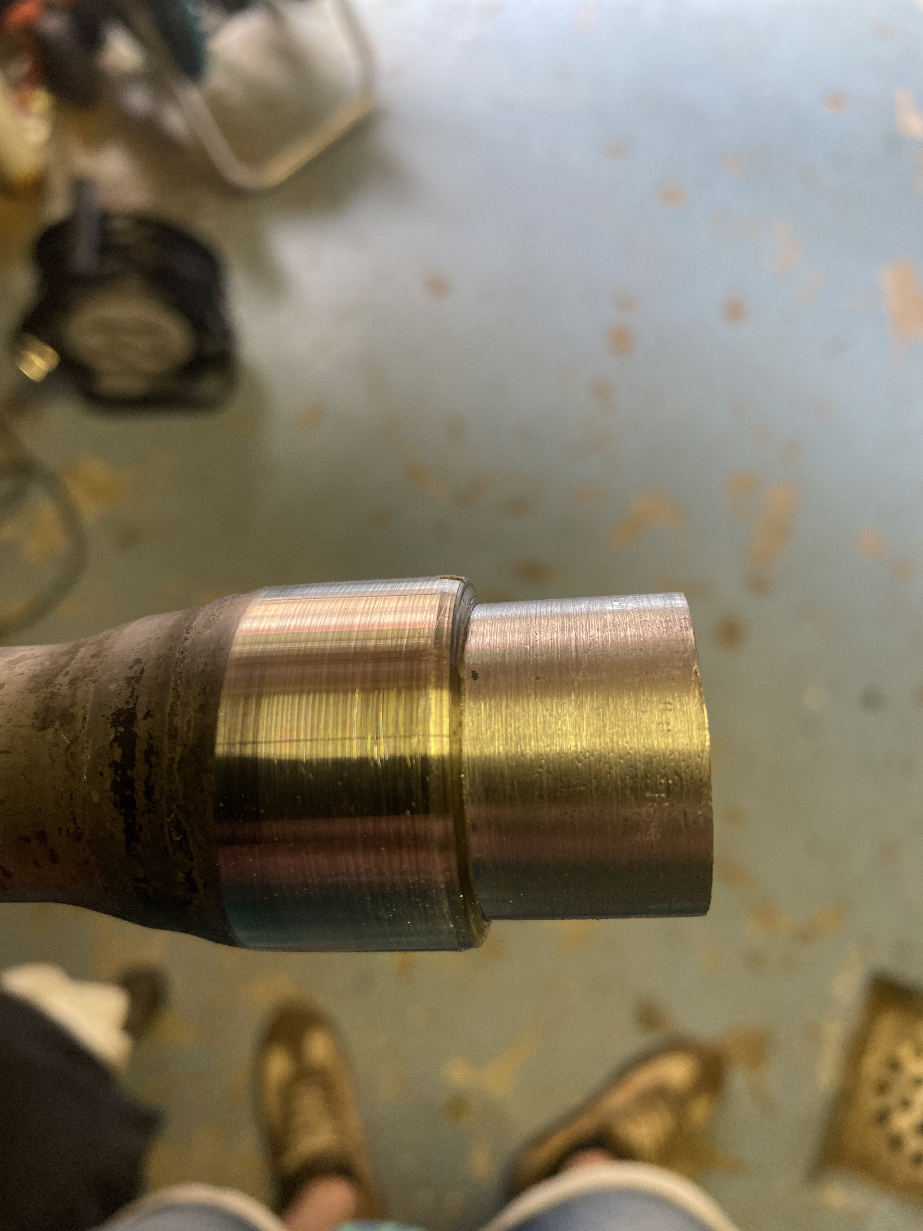

Arthur
Could try it like this.
Maybe make sure there is a 1mm gap between the shafts so the root pass penetrates into the sleeve?
Edited by petert
Arthur
Yeah, figured that myself and did exactly that.

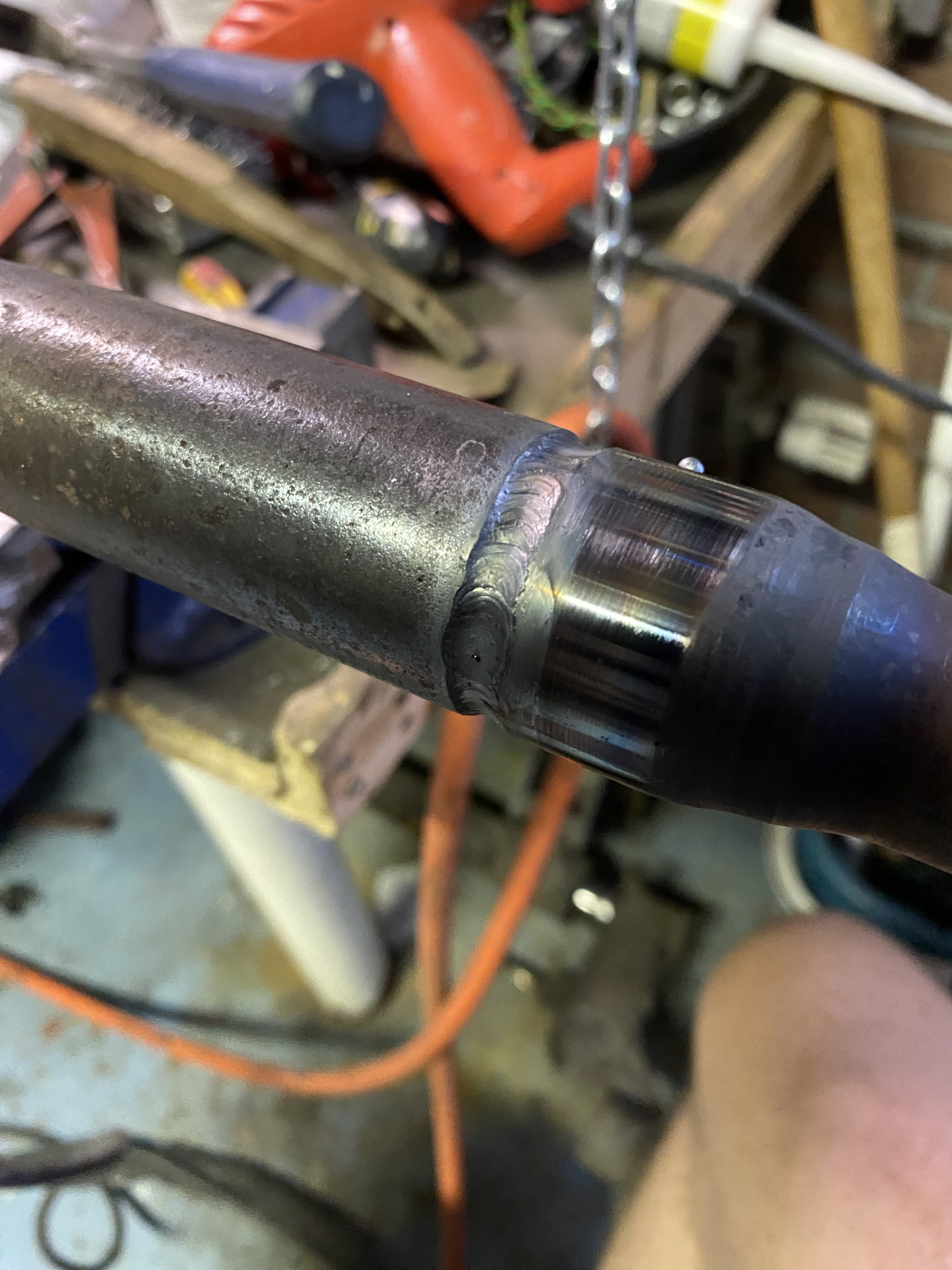

Arthur
Not realy time to take pictures but I got 2 passed like this.
Arthur
:(  The welding did not feel much more difficult then even before but it warped more than expected. Now it’s 1/2mm bend.
Edited by Arthur
I have done this before, now put it in a press and press it straight.
Arthur
:P Cleaned the weld up to check all low parts and all seem to be welded through. The clamp of the boot is on the weld so extra safety there.
