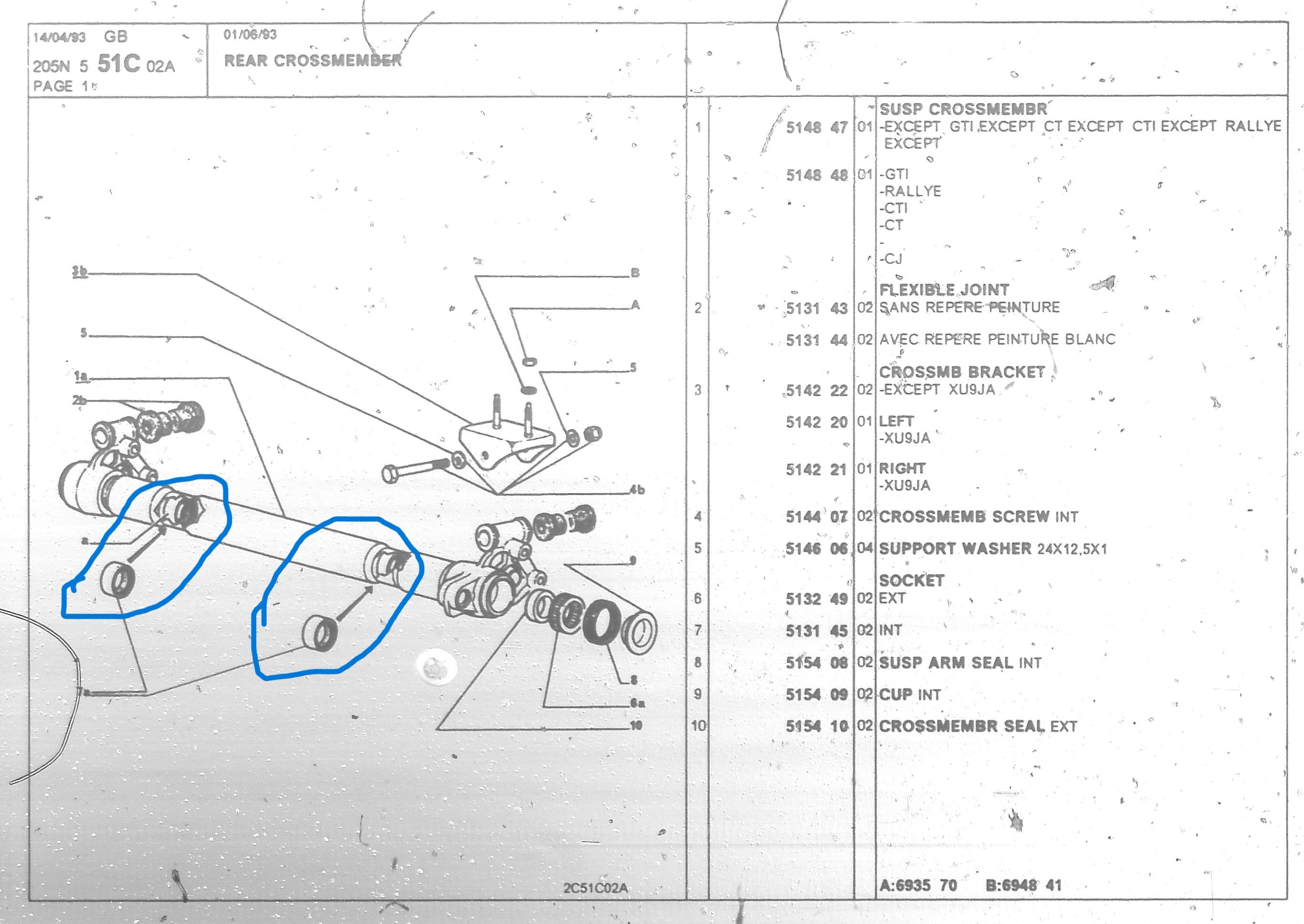

Hi All, I'm just back into the fold after losing interest in playing with cars for a few years now. I picked up a refurbed Bronze bushed rear beam ages ago was just staring to build it up but have noticed the inner beam bearings aren't there. Both circled in the picture. Are they required and if so any idea of the part number, or can one of you Gents supply?
Cheers

Gohn
yes
Cheers
5131 45 Socket, is the bearing, as is 5132 49 (inner + outer)
g

You'll need to remove the outer bronze bush to fit the inner bearing.
Can't believe someone only did half a job
