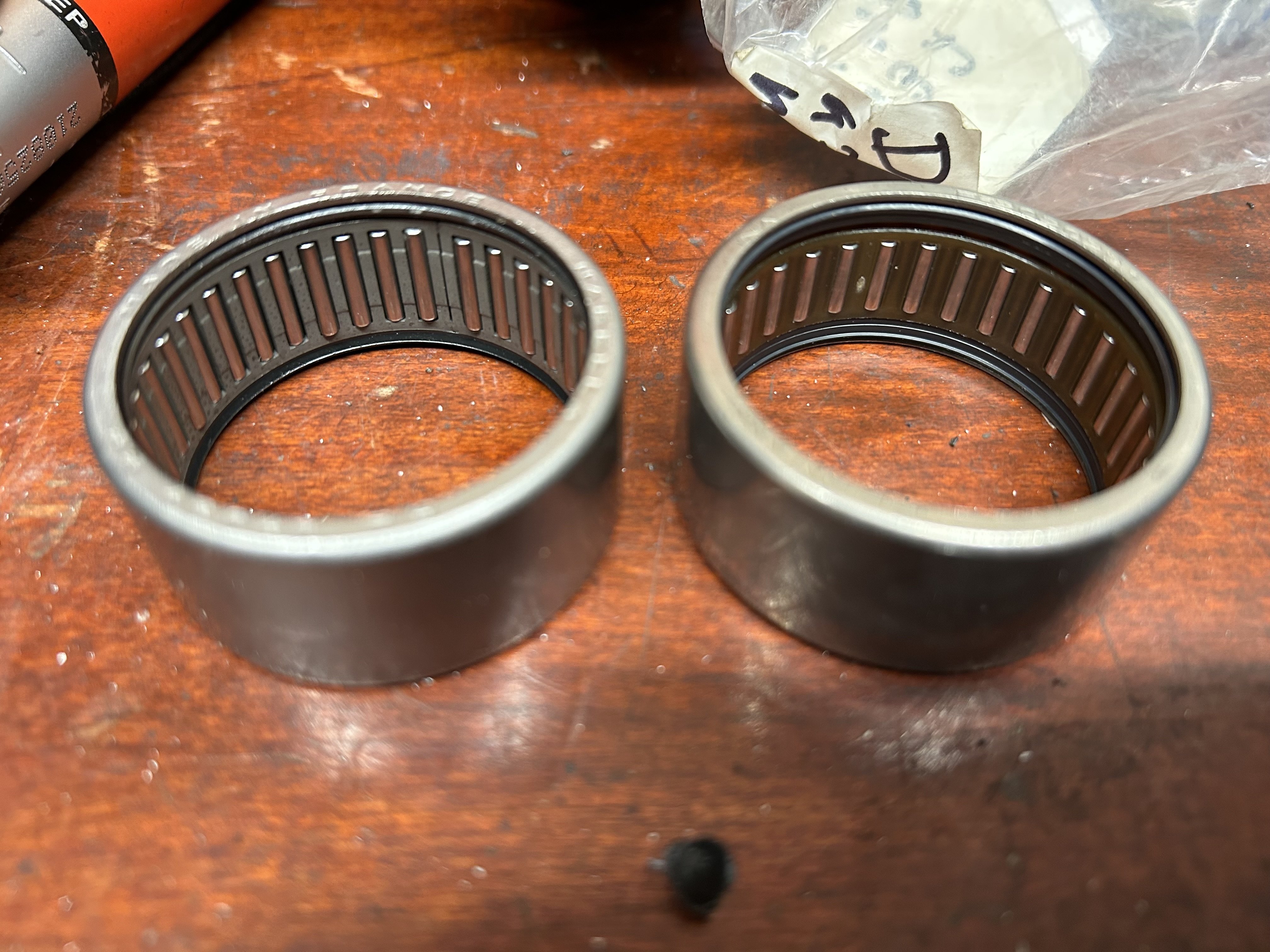

SweetBadger
got hold of some.
Nadella (left) vs SNR inner bearing
Nadella has wider needles and more of them, quality is noticeably superior.
jord294
2 hours ago, SweetBadger said:
got hold of some.
I did say earlier in topic that snr are poor quality
SweetBadger
I didn’t doubt you, just though a pic to show the differences would be useful!
jord294
If I could post pics I would. Tried so many times. Even the metal finish of snr bearings is poor compared to proper oe bearings
