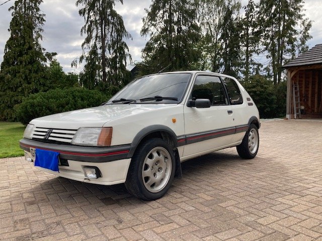

Hi the injectors are yellow. The riveted label on the engine is not present but the chassis number is VF320CD6223672302. Its definitely not an auto or CTI model. I have attached a few photos for reference below.
wilson9068
Since these photos were taken I have replaced the air intake hose, the one between air filter and AFM and the one between AFM and inlet manifold. As mentioned earlier I have also replaced the Fuel Pressure Regulator.
The reason I asked is that in my experience you need the injectors that match with the air flow meter. Yellow injectors are correct for 128bhp 1.9 GTI. I once tried a 1.9 AFM on a 1.6 car with its blue injectors and it did not run well. The correct 1.9 air flow meter ends 109.
The bad idle is probably down to bad setup tbh. Not many people know how to set these cars up properly any more.
