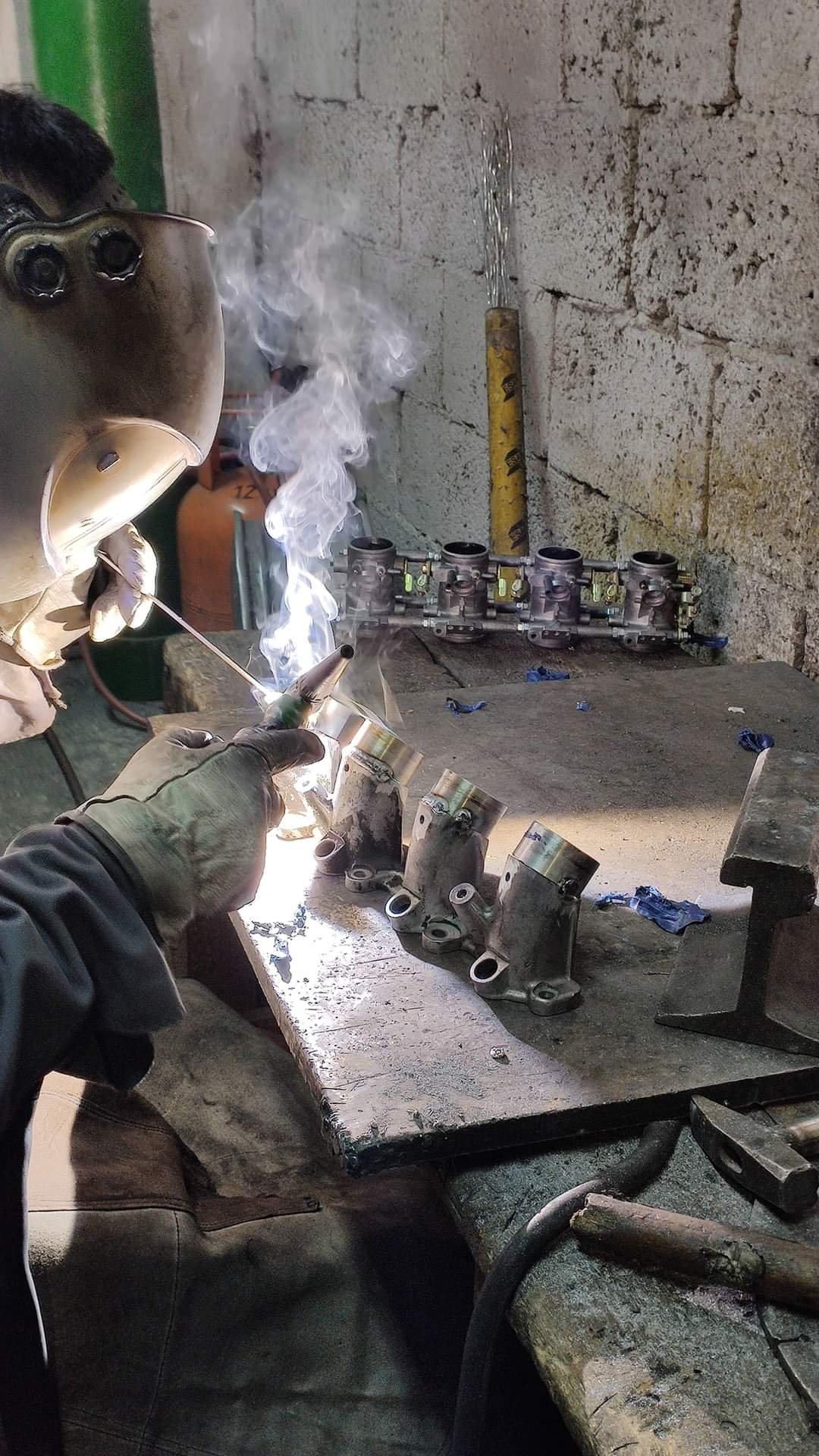

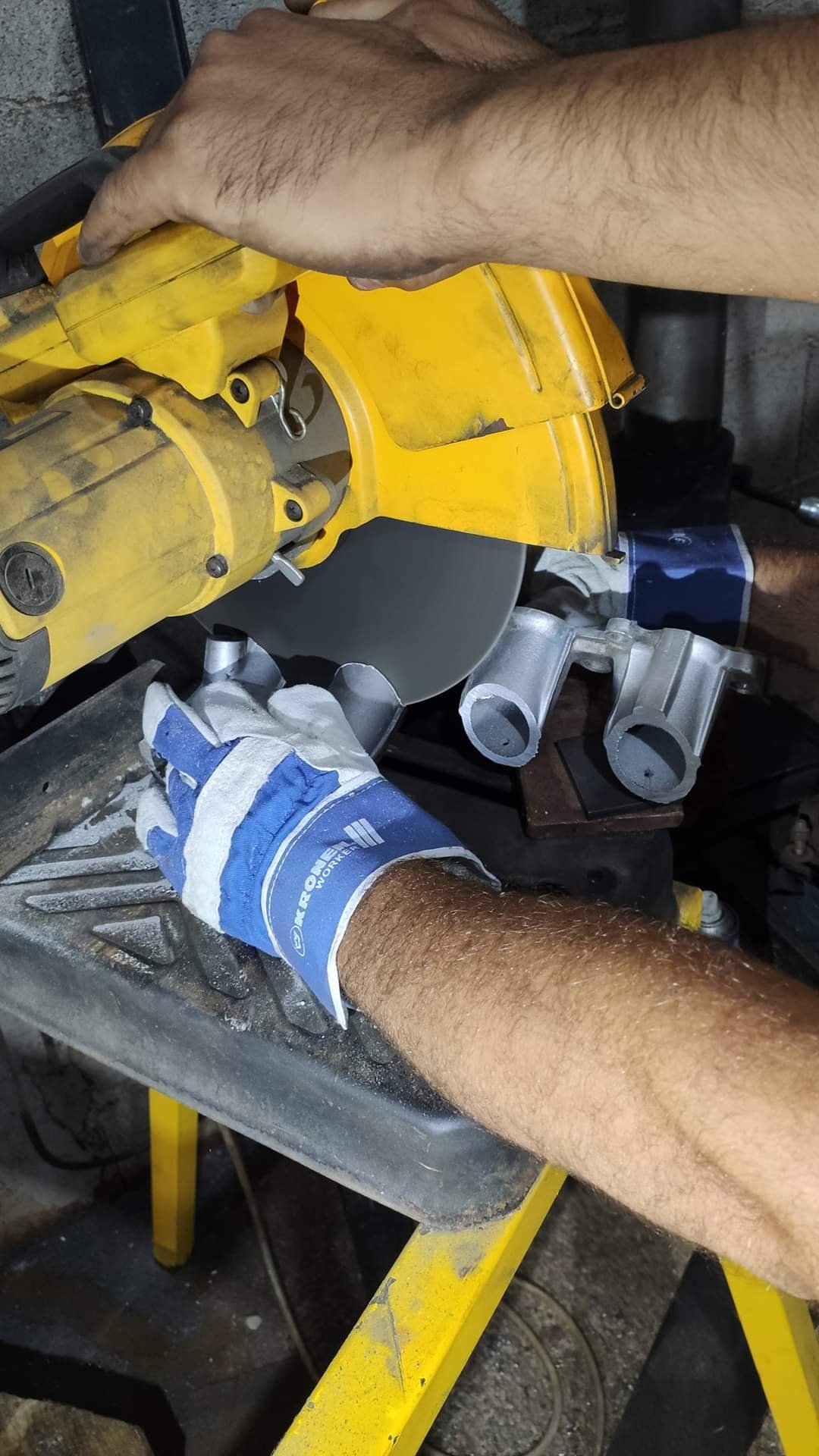

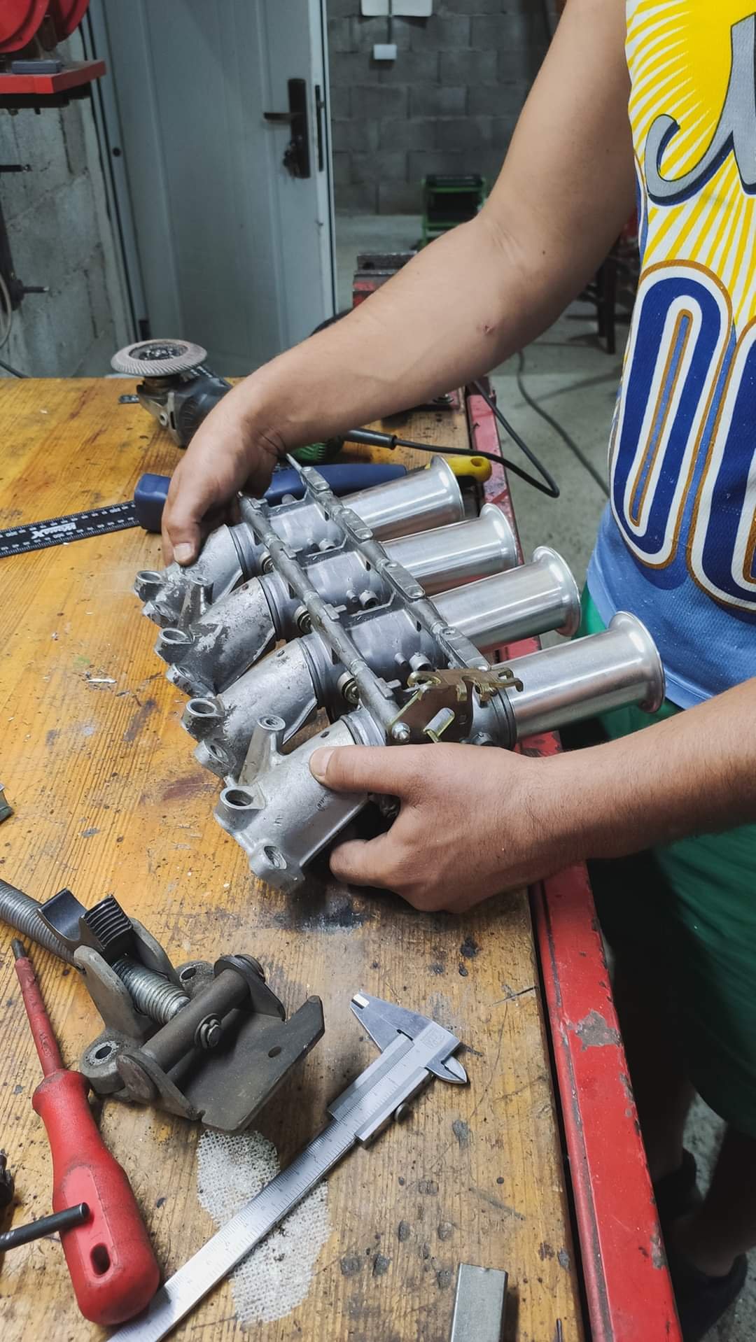

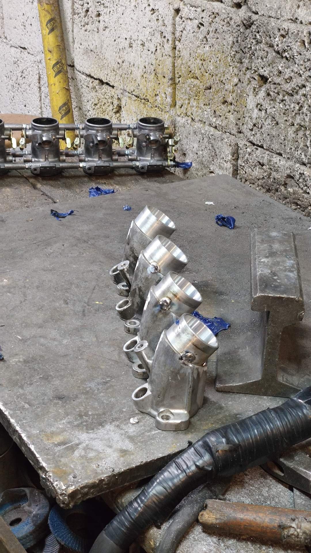

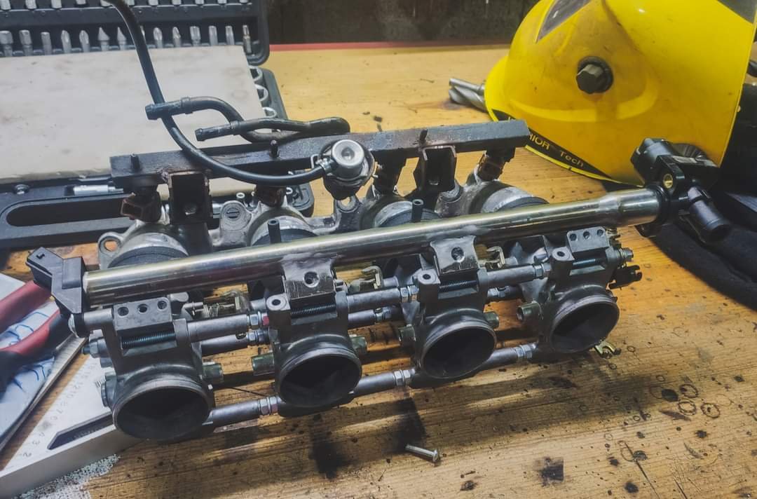

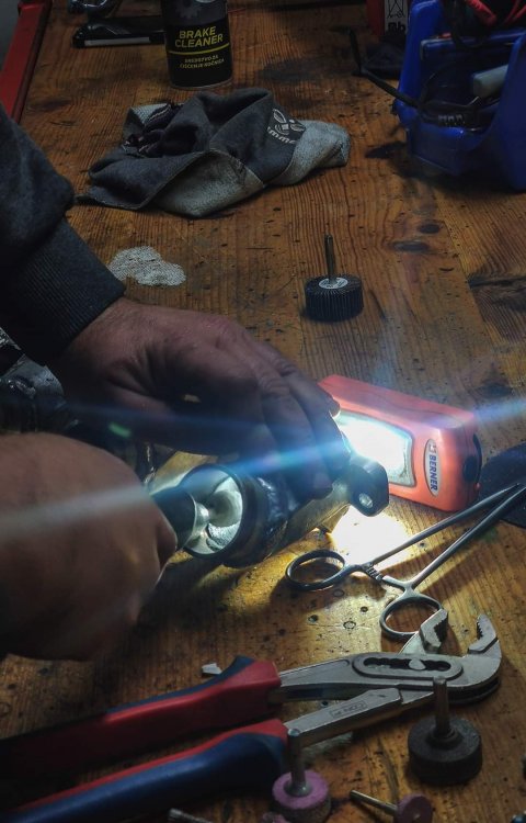

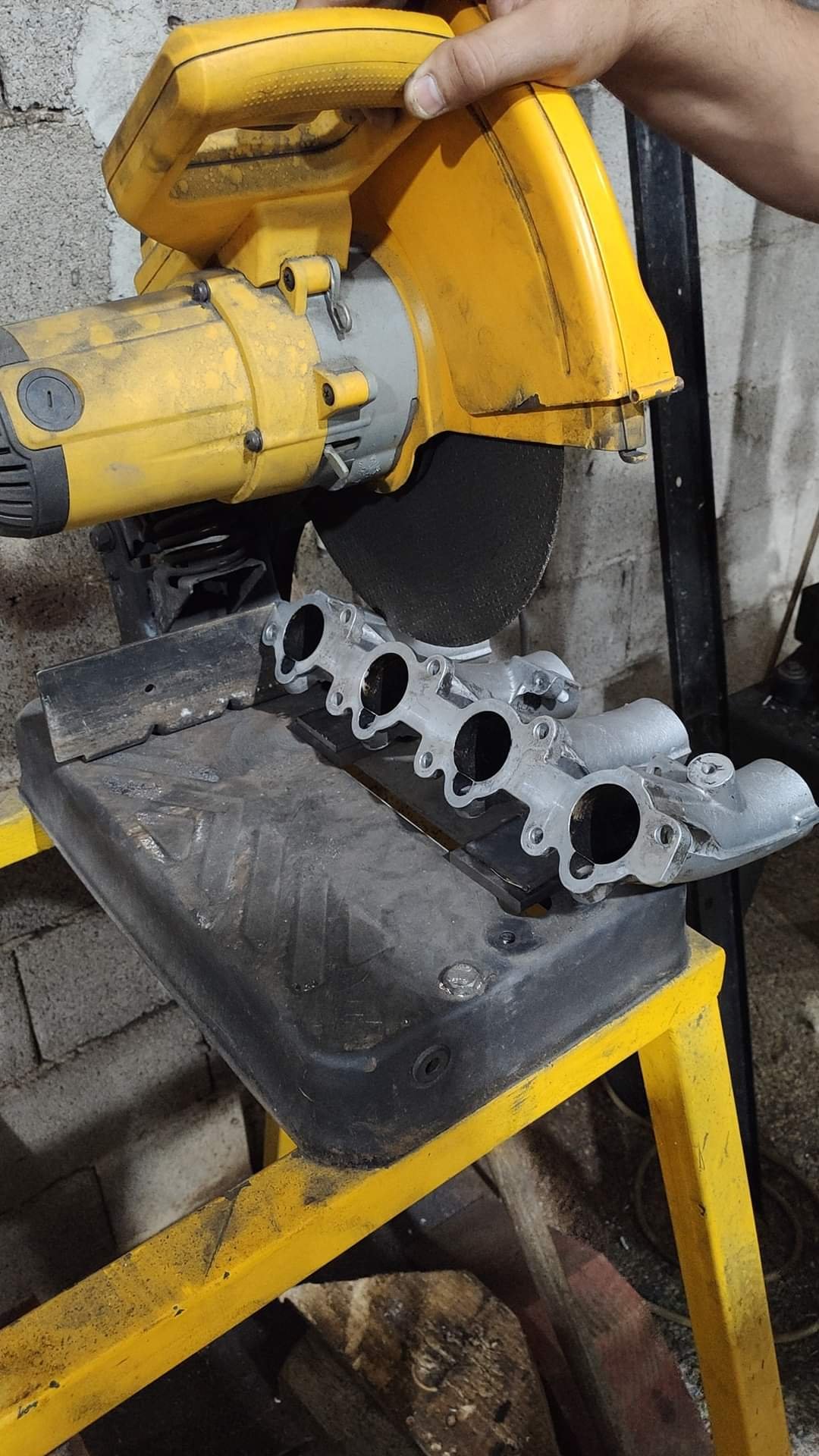

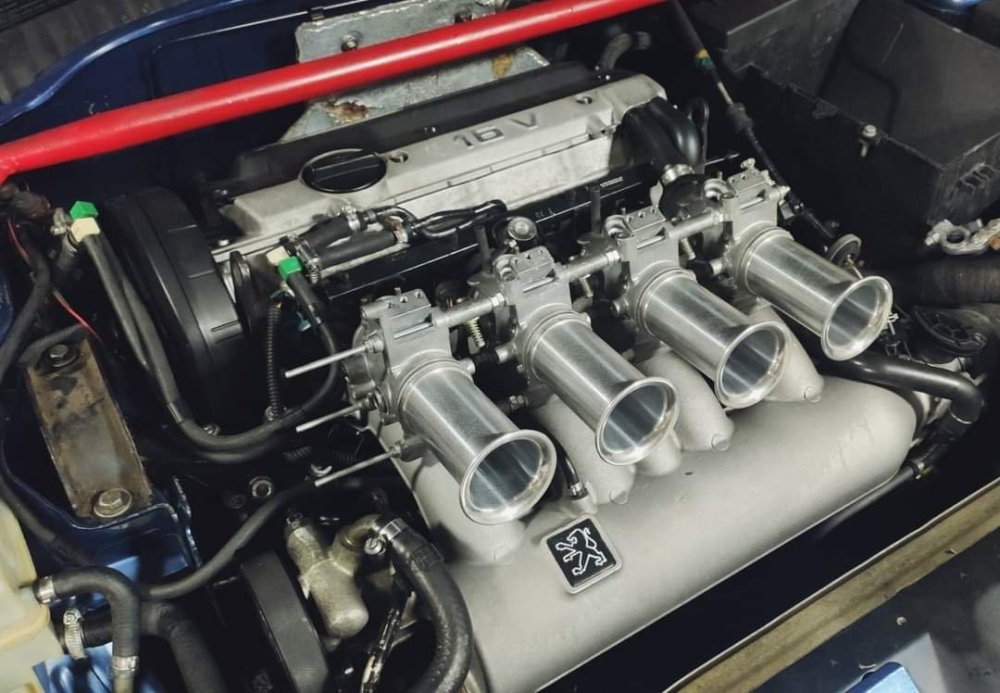

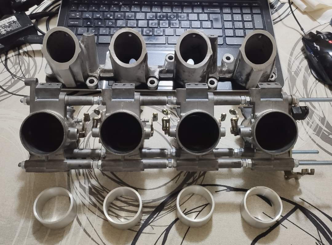

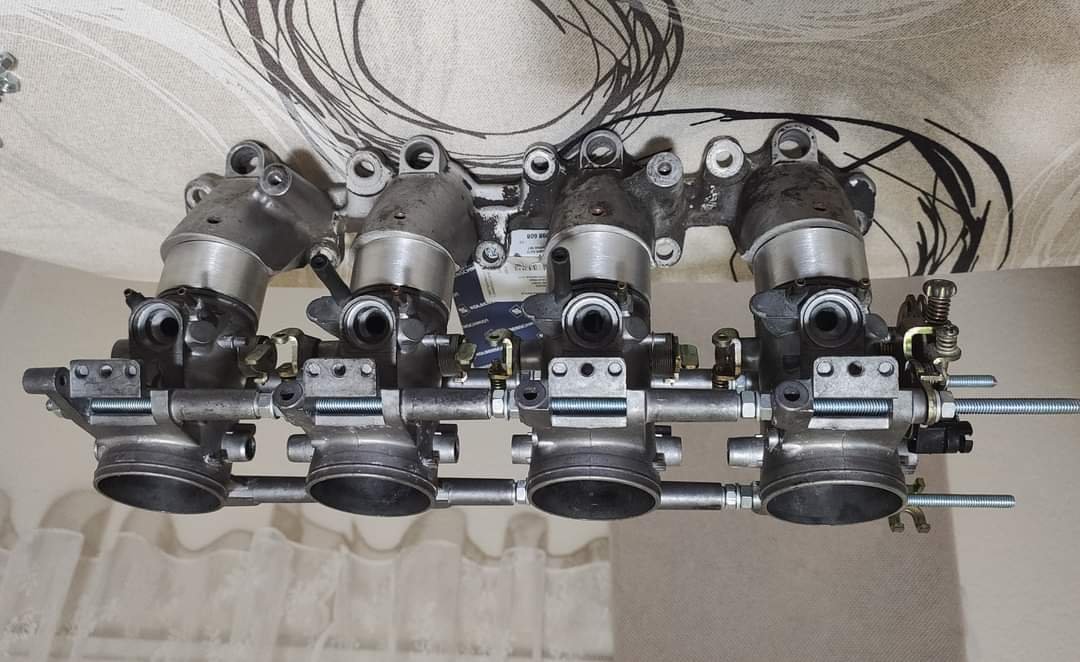

wladimir031 8 Posted March 6, 2023 (edited) Hi i would like to show my ITB work from start to finish.. enjoy I cut my original GTi inlet manifold Testing angle I made vacum colector for Map and steper motor... to work with oem Ecui instal saab 2.3 turbo injectors (370ccm) Edited March 6, 2023 by wladimir031 1 Share this post Link to post Share on other sites
wladimir031 8 Posted March 6, 2023 First try ... idlee excelent on oem ecu. YouCut_20211212_224109876.mp4 1 Share this post Link to post Share on other sites
wladimir031 8 Posted March 6, 2023 i play with tps sensor because i must use stock gsxr tps .. and then i try again with some trottle. VID_20220510_172452.mp4 Share this post Link to post Share on other sites
wladimir031 8 Posted March 6, 2023 and finaly ROAD TEST.. use headphones hahha sounds great YouCut_20220626_104510688.mp4 1 1 Share this post Link to post Share on other sites

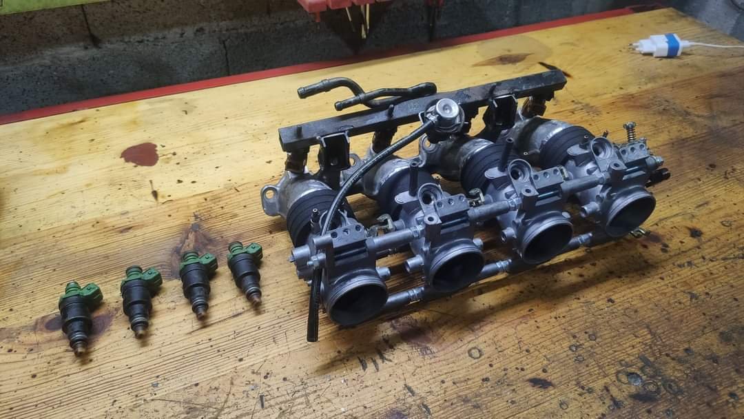

mmt 15 Posted January 1, 2024 Really nice work. Looks mint. are those injectors a straight fit with the 306 rail and connectors? They look just like the original 306 gti6 ones? Share this post Link to post Share on other sites
wladimir031 8 Posted January 2, 2024 15 hours ago, mmt said: Really nice work. Looks mint. are those injectors a straight fit with the 306 rail and connectors? They look just like the original 306 gti6 ones? litle shorter , i cut/shorten and weld rail holder where two 10mm bolt goes .. connectors is the same. Share this post Link to post Share on other sites
