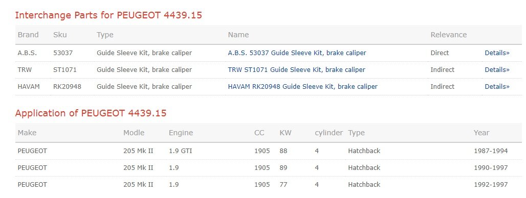

Anyone know of a good supplier for front sliders for 1.9 girling callipers. Bought a couple of sets off of eBay and both have been the wrong size.

TRW : ST1494
ATE : 24.0101-4806.2
Frenkit : 810001
Autofren Seinsa : D7125C
.. all complete kits : sliders , bolts , boots and an pack of red rubber grease .

4439.15 should be the oe part number you want to find the comparable part for.
