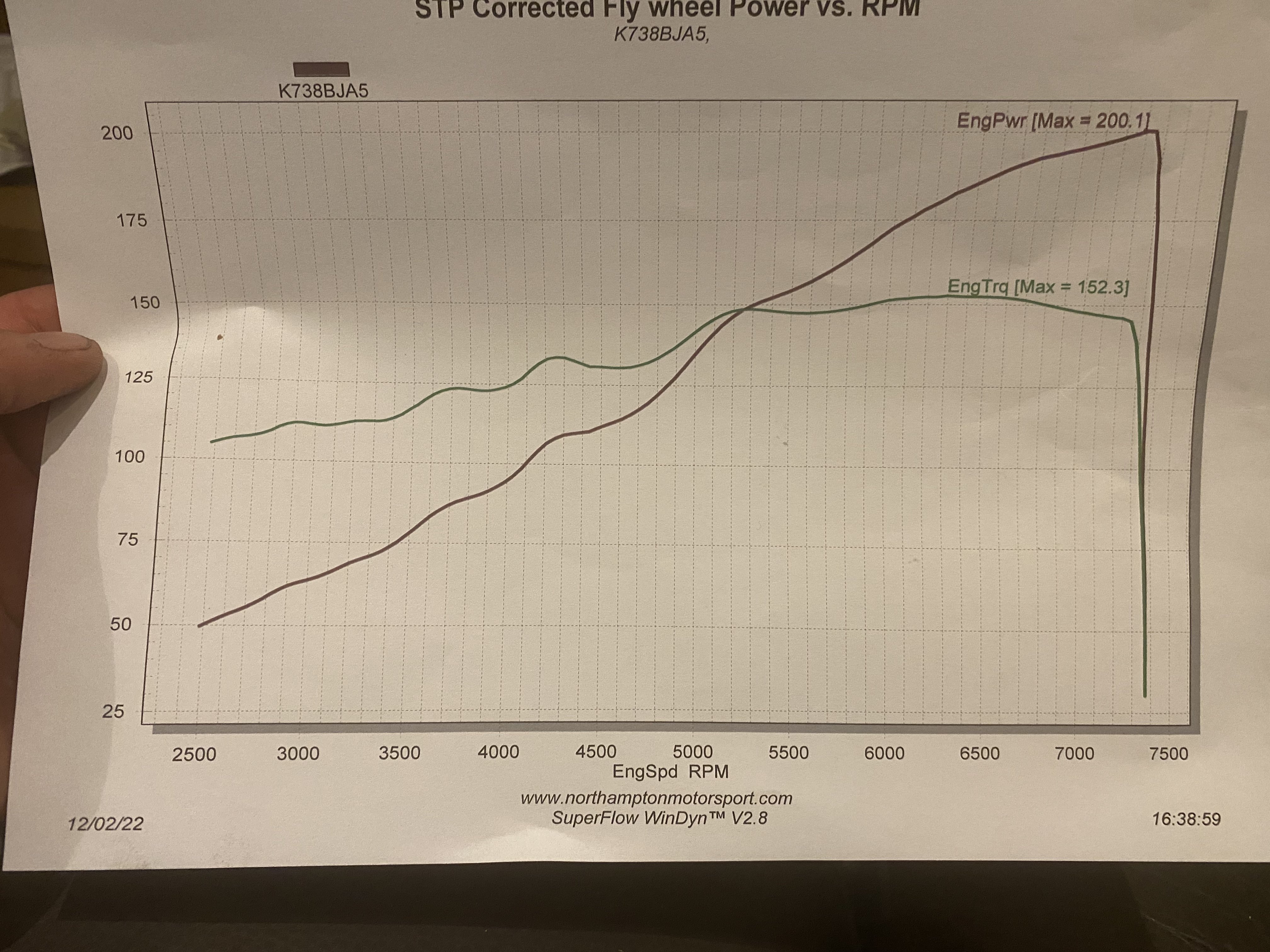

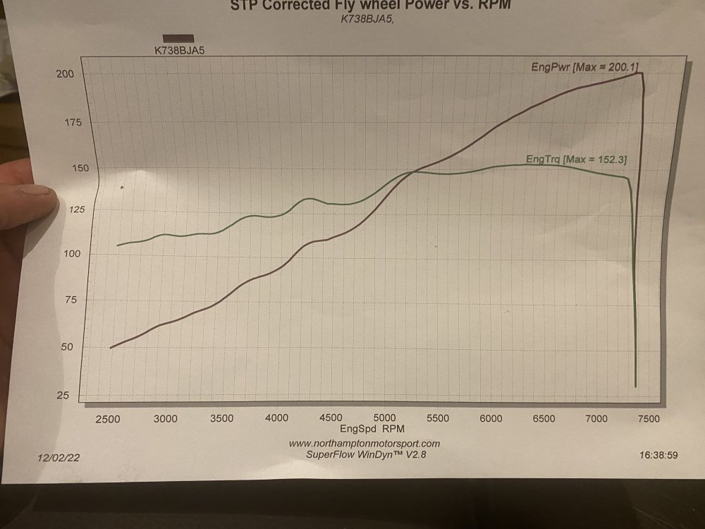

Is it me being daft or is the torque a little low?

Sorry Tom my bad. IT’s gti6 engine with cat cam 106’s, jenvey 45s with satchell inlet .
Hey bloke, the reality is you’re trying to fudge flywheel figures derived from the wheels, with losses from tyres and gearbox. Rubbery figures at best. Take them with a grain of salt. If it goes better after than it did when driven in, you’re on a winner. Unless you have multiple runs from the same session, with data verifying the changes made between runs, the figures are somewhat meaningless.

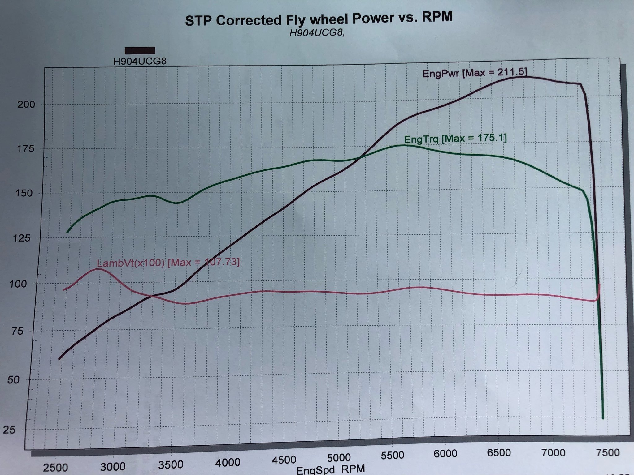

Here's mine for comparison, on the same rollers
My spec is
XU10J4RS engine (gti6)
Newman phase 2 cams with some head work
Jenvey throttle bodies (330cc injectors)
Jenvey inlet manifold
Pug racing exhaust manifold
Forged rods
Forged high comp pistons
but like Peter said, if it drives better dont worry about the figures as they are meaningless 6071EC67-C642-4E96-A93A-069526610D3D.thumb.jpg.04ee4efe300fb8e2621b962d6f588648.jpg

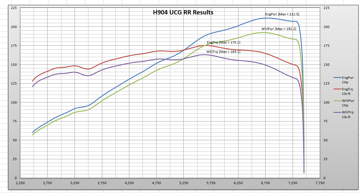

I plotted the figures in excel to show the wheel HP/torque from the actual readings.

Hardly arrogance is it... either way your cam timing looks no where near right, I bet that feels flat under 5k, which is probably why you're here asking the question. Compare it to porters graph.
Are you on standard pistons? What about exhaust? Have you checked valve seats?
If you're on standard pistons you're probably close to the valves kissing the piston, or to avoid contact they're massively retarded, particularly so if the heads ever been off for a skim. Timing up cams properly isn't the easiest thing to do, but it's worth its weight in gold to get right
For comparison a friend made more power with less cam, and has a far healthier spread of torque and power delivery. Same inlet manifold, bodies, gti6 exhaust manifold.

Completely understand your point thanks Peter. It now seems to go mental at around 5.5k revs compared to 4k. I think it’s just going to take a bit of getting used to it as it’s obviously quite different now the cams and ITB’s have been fitted

That’s a brilliant comparison thanks mate. Your torque seems to peak a bit before mine which I’d prefer because as much as I enjoy thrashing it, I don’t like to do it :-) I just think I’ve got to get used to the changes I’ve made pal

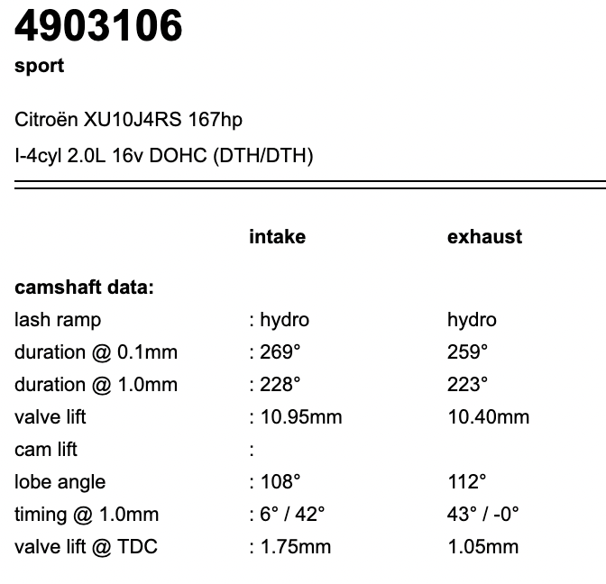

The recommended LCL for Catcams 106 inlet is 108º, which I'd agree with. If you've installed the cams on the oem positions, you're probably at 112-114º, which is definitely less than ideal. You're giving away heaps of torque and not getting any more top end. With standard pistons you couldn't install the inlet at 108º (1.75mm lift @TDC) without risk of bending valves anyway.

I was told that these cams were designed to maximum lift without having to pocket the pistons. (As long as the head hadn’t been skimmed). What is the minimum clearance needed and what clearance would we have if the cams were set at 108 degrees at TDC? I know gasket thickness would play apart and as we are talking very small figures I understand that you may be able to give an accurate answer.

My safe limit for a std RS engine is 0.055” lift at TDC. What I consider safe and what others think might be two different things. 1.75mm is approx 0.068”. Just 13 thou more?
You could take the risk and set it up at that. It may run forever. Either way you’ll have to take the head off to fix it eventually.
