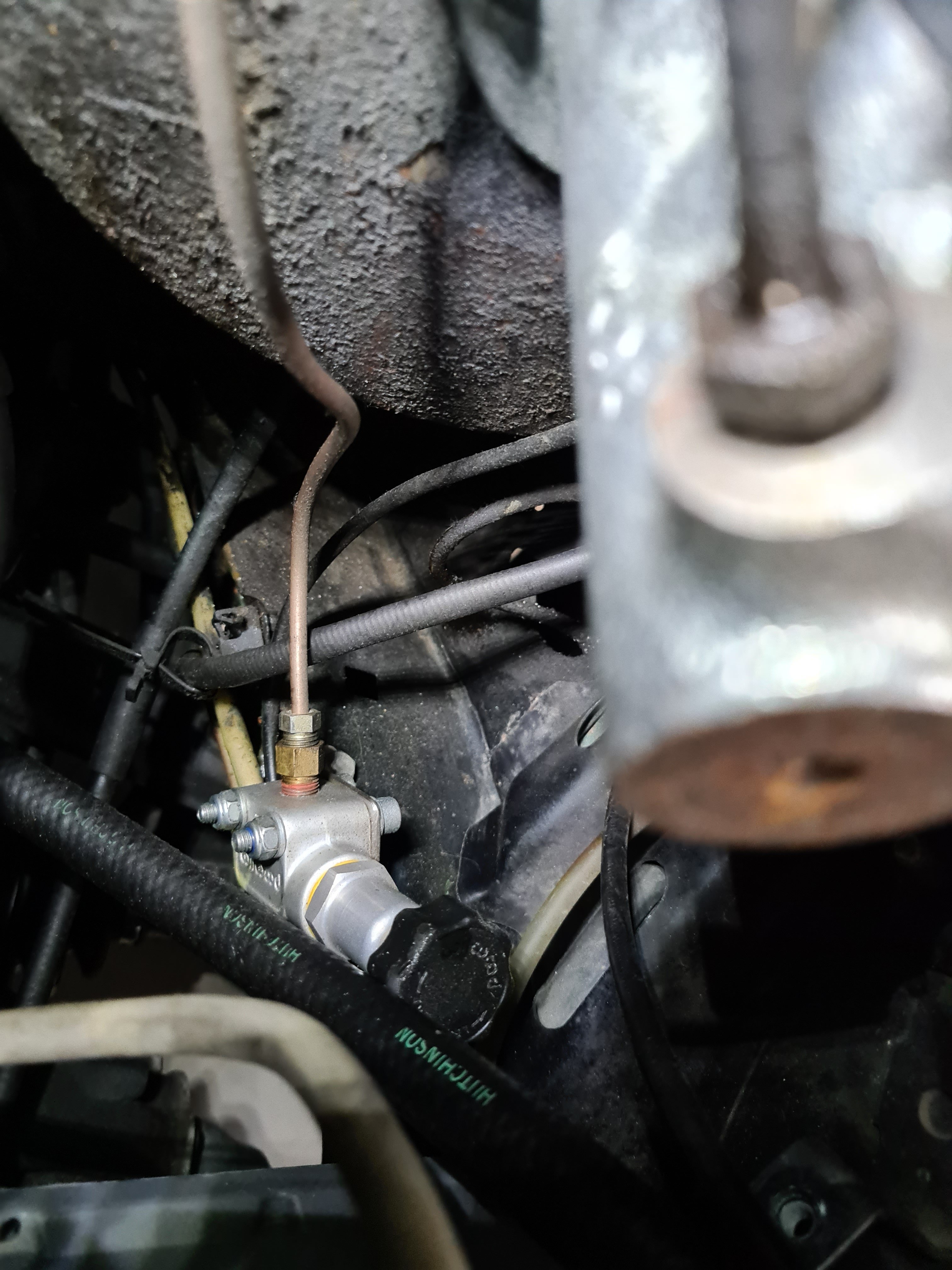

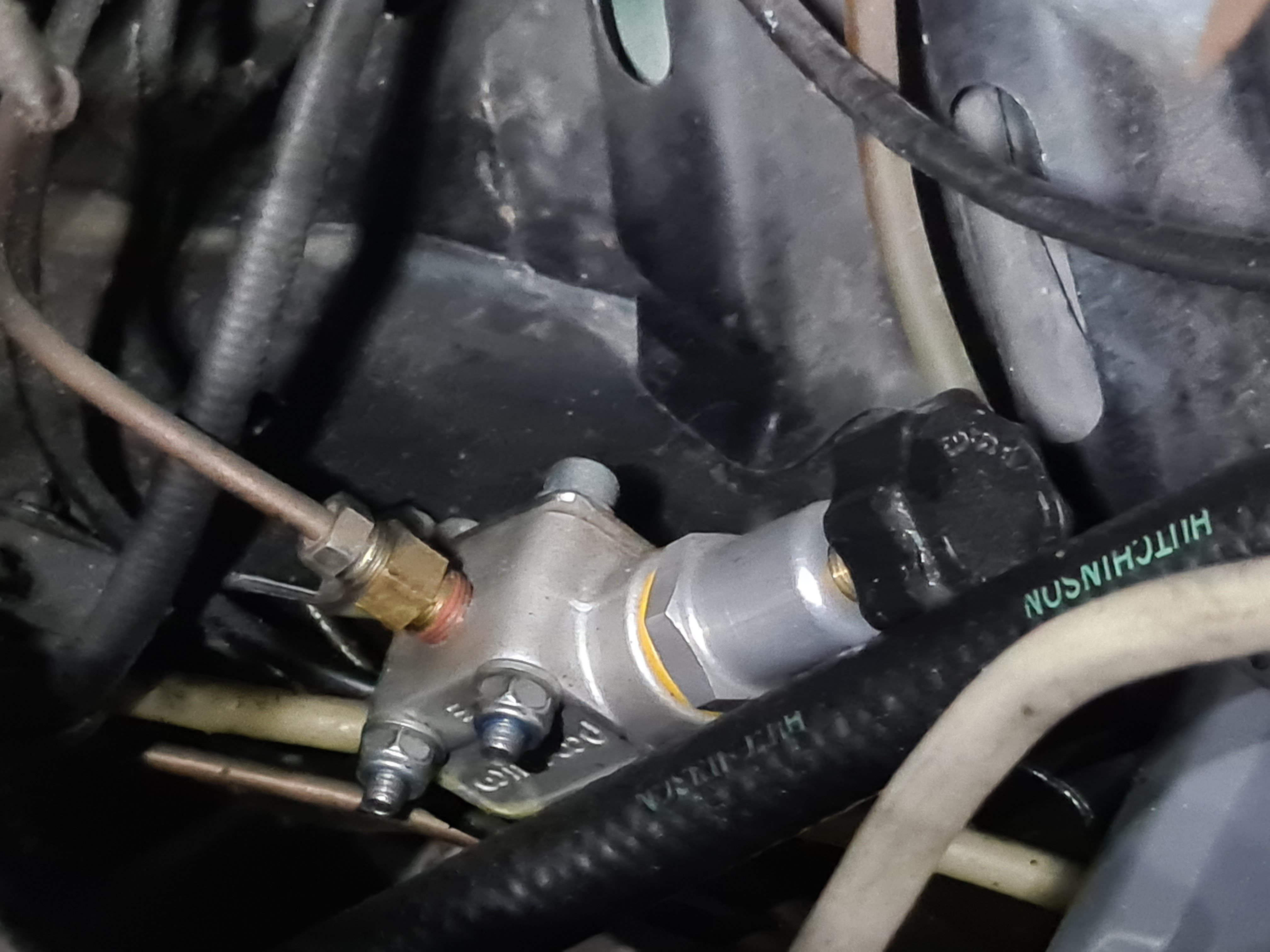

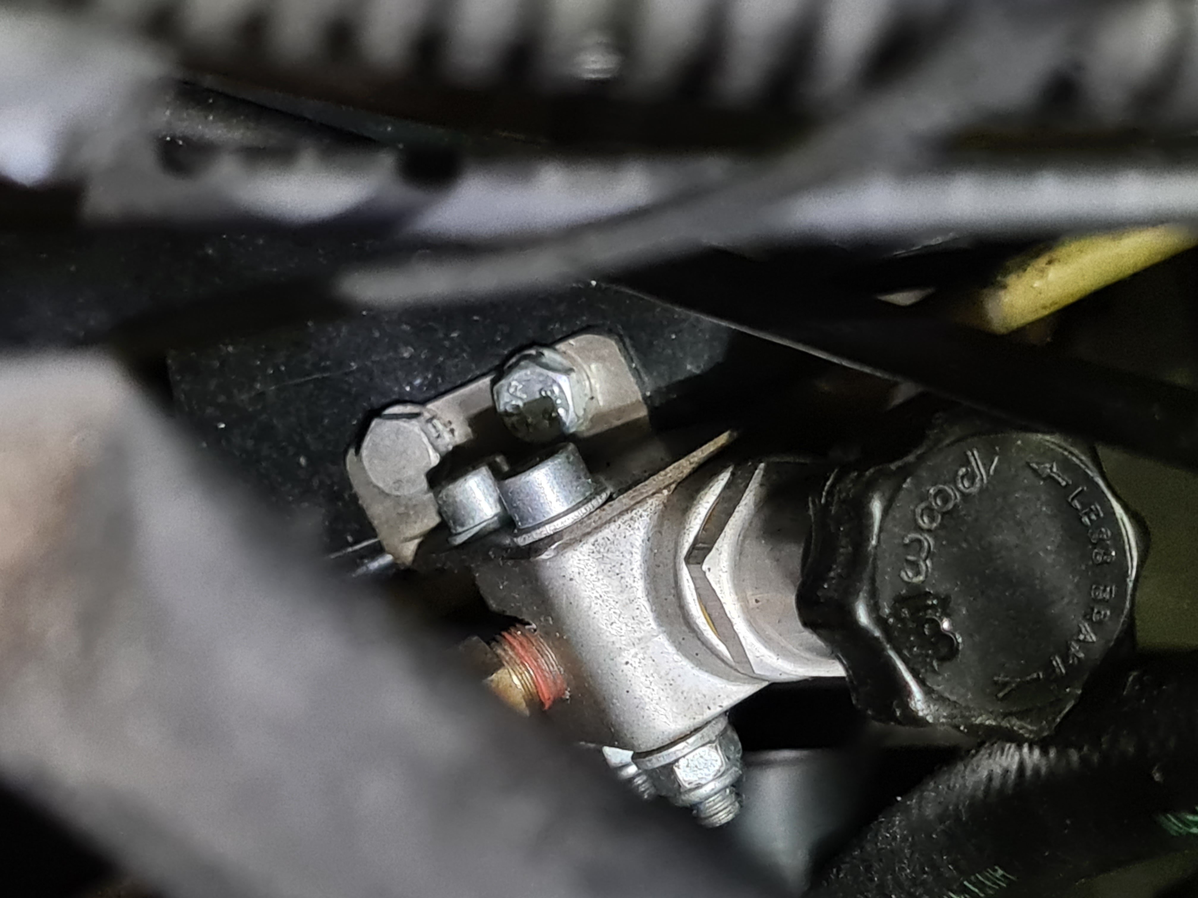

Kobayashi
I am just realizing that what you intend to do is very, very similar to what I did 1 or 2 years ago. I am not saying that you nee to do the exact same thing, but I'd like to offer any Information (including my conclusion in the last post) that was collected back then:
Kobayashi
1 hour ago, Arthur said:
 Ending up with too much rear pressure wouldn't really mind when I add an adjustable racy aftermarket compensator balancer thingy imo. Maybe a bit over overdone for a street car, but oké. How do you mount those anyway? Just drill a whole in the bottom and get the knob inside but leave the business part out? (did that sound like I think it does?)
Here is how i mounted the limiter - hiding away in the engine bay,   behind the battery, yet accessible when you need to adjust. The holder is a custom one.
