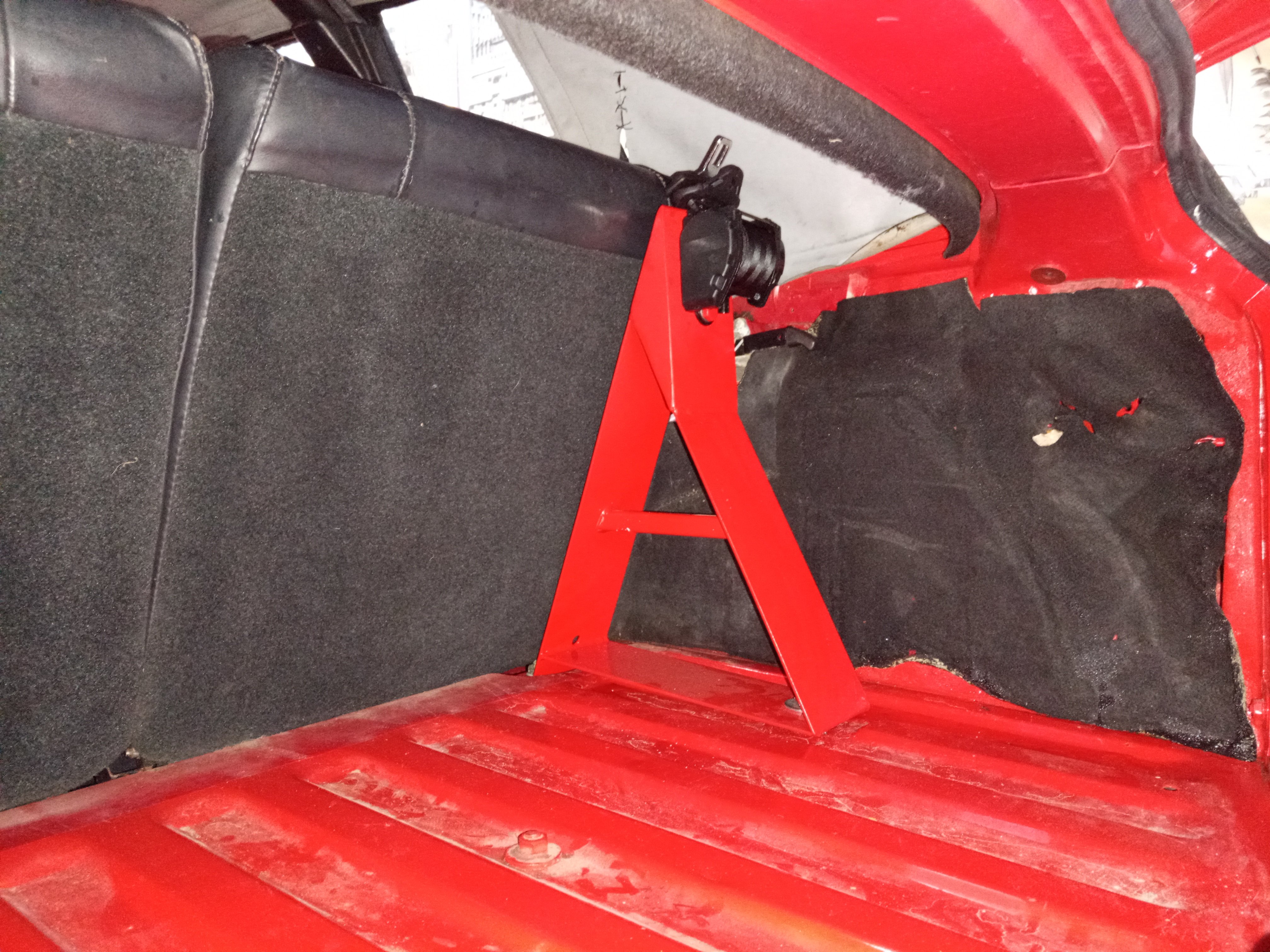

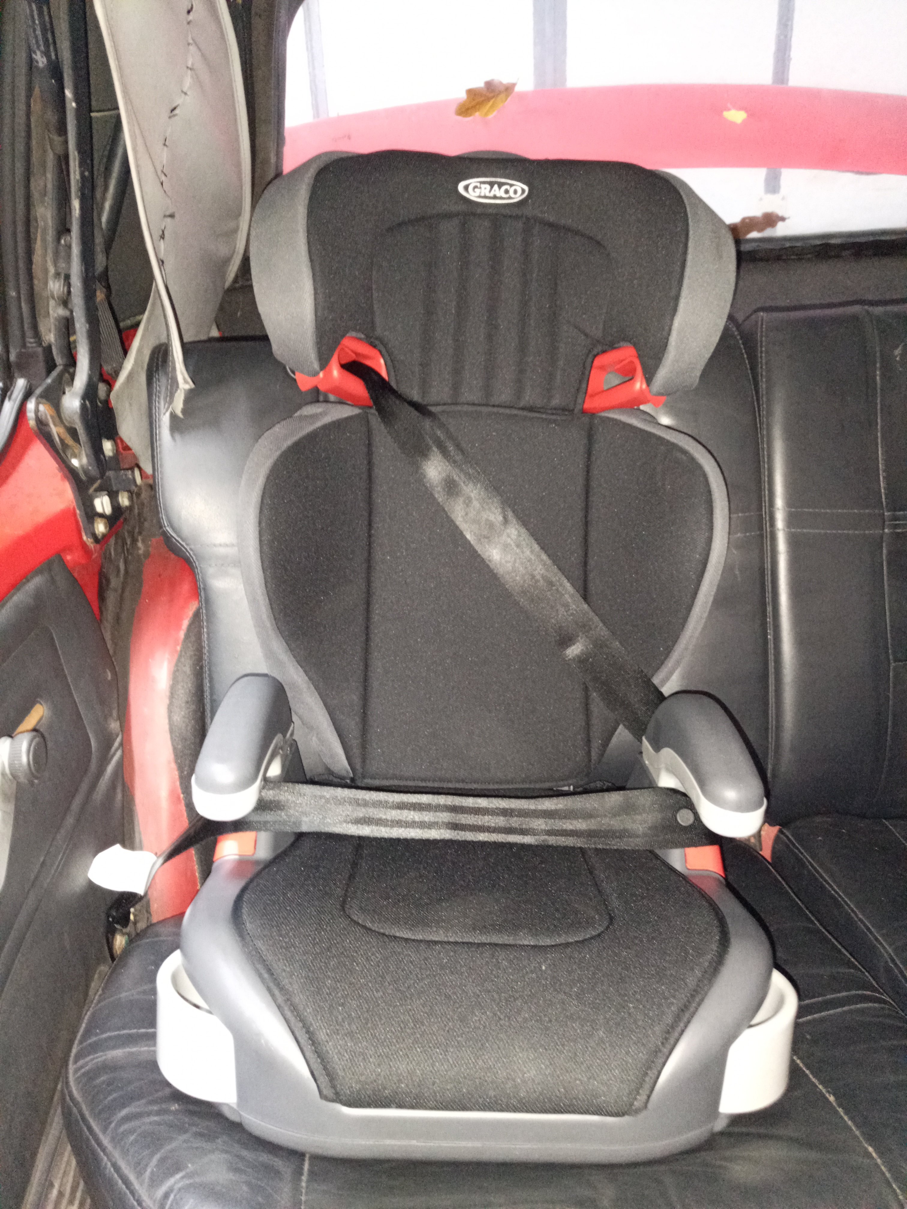

I finally completed revision 1 of the 3 point seat belt for a CTI/CJ.
The "bracket" has a gusset and a steel bar to ensure it's structural stability.  The belt is from China and has a consistent and reliable ability to be operated by the kids.
The bracket mounted in three points to the rear axle points using a coupler for the rear and the pre-existing bolts for the front two connections.   The belt is mounted using two of the original mounting locations.  All bolts are high strength and locktighted.  The belt itself is bolted into a nut that's welded into a plate.
I'm after feedback / suggestions.  One thing I realize I didn't do is a way to stop the belt twisting on the mechanism, I can easily fix that by drilling a small hole and sticking an M6 through.  I'm also mindful if the nut that's welded into the plate is stripped then it will need tapping because it's not a serviceable or replaceable part.  I've had a mate who does MOTs check it over "off the record" and he said he'd pass it but you know how it is with mates and MOTs!
In total it cost 2 fish butties & 6 bottles of Hobgoblin for the fabrication and £48 for the powder coating...  I don't intend to make these commercially available.
I do max 5 miles trips with both kids and this in, all local traffic and never exceeding 30 mph.  Other kid sits in the front FWIW.
Go ahead and critique away so I can get the motivation to do a revision 2!

I would mount the top of the bracket, at the height of the belt, to the chassis with a bracket or a strip.
Can you elaborate a little more on this?  I did consider a strip running across the width of the car as a brace but I'm not sure that's what you are trying to describe?

Consider what happens to your bracket on an impact sideways... You only focused on impact on the front.
With respect to side impact; the cover for the hood frame is missing and you have some exposed hard metal stuff 30cm from the head of your kid.
