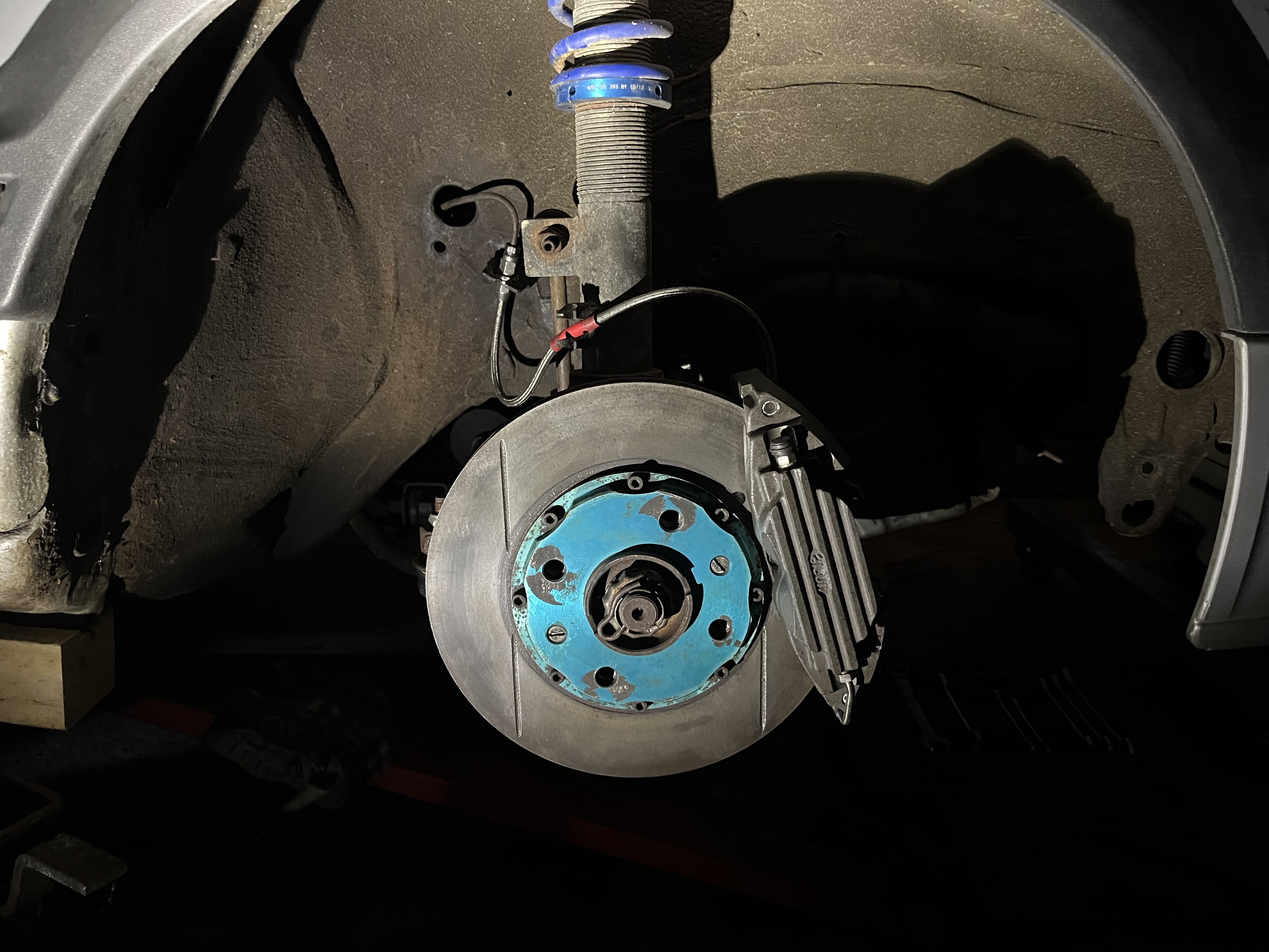

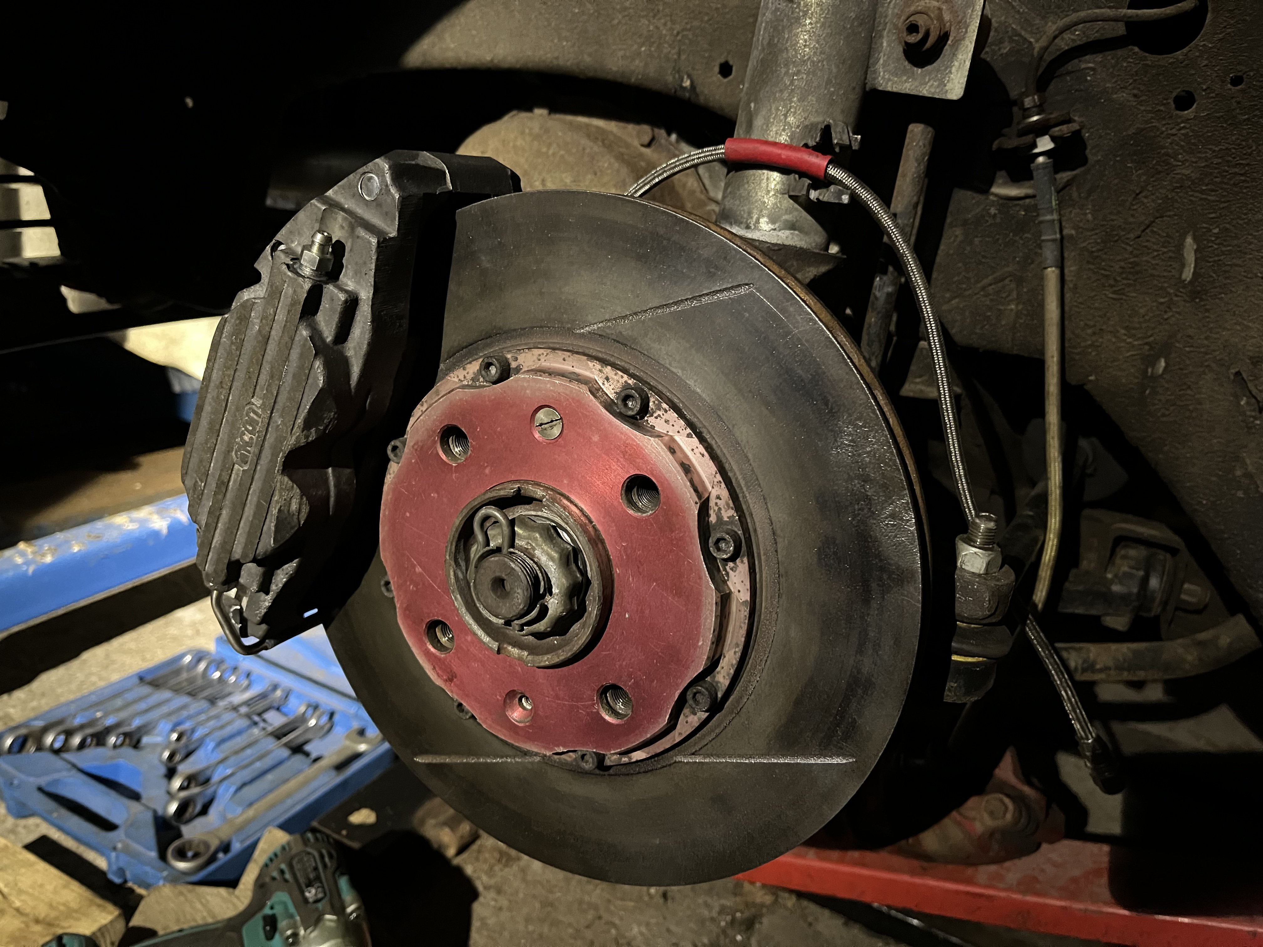

Hi,
I bought and installed a nice set of Gr. A Alcon 4-pot calipers for my 205 GTI Turbo racer.
Refreshed the calipers, new seals, bolts and rvs brake line adapter fittings.
The used bells/discs, pads are also fitted.
So far all good, all works and looking great!
I want to use them during the next track day, so went looking for some fresh brake pads… Do they still exist??
Does anybody know where I can find them?

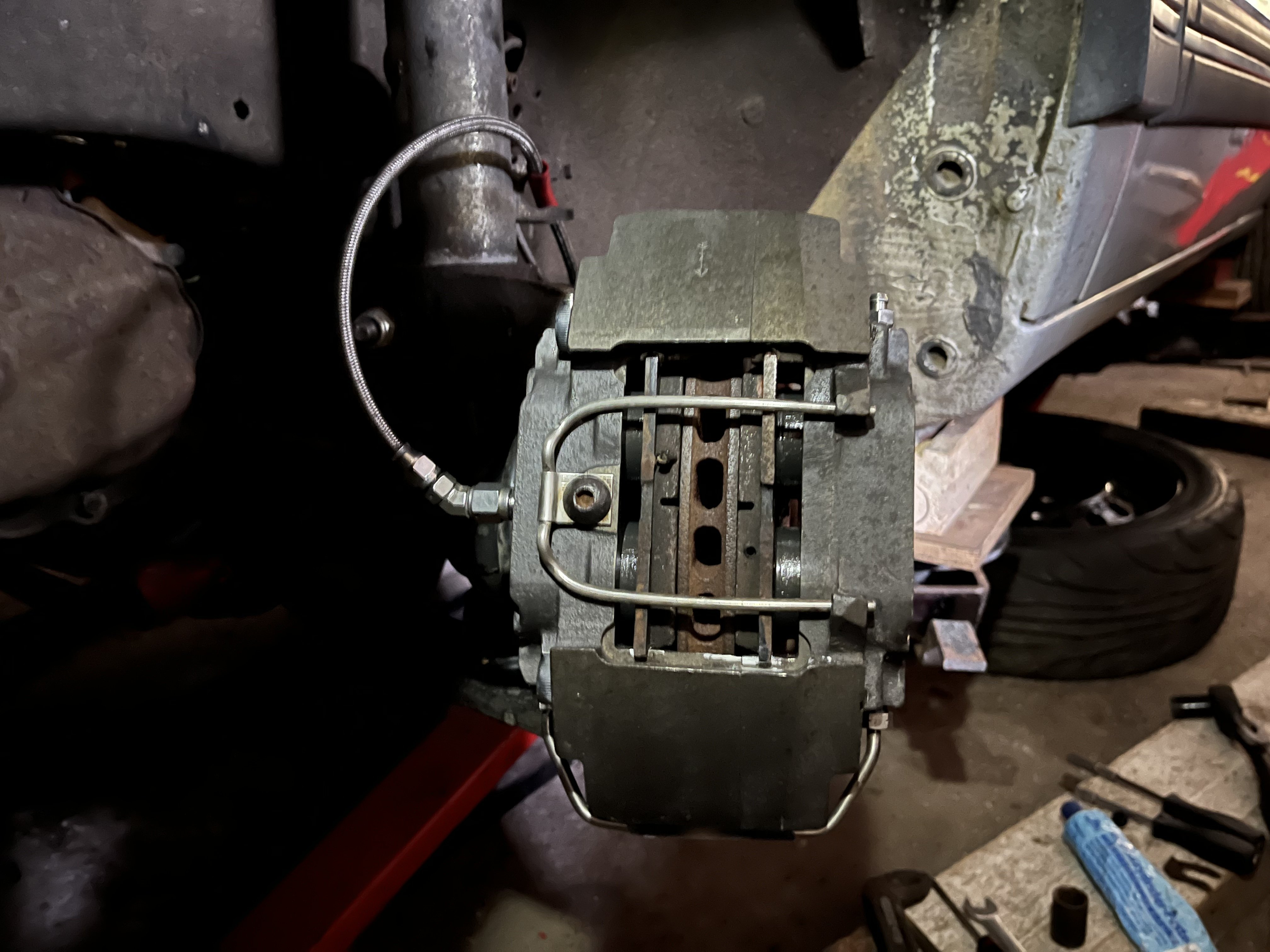

Or can tell me what the true dimensions of the brake pads are? (The ones I have almost look homemade).
There is so little information I can find about the set.
Any help, ideas or information about the set is welcome.
Greetings, Job

I forgot to mention that there is a part number on the pads I have, 3434F GG
Google showed no results earlier.
Today I searched for Ferodo FRP101 pads and found an Alcon brake pad cross reference list. First pad on there is the 3435, which has roughly the same dimensions as the pads I have.
Biggest difference is that mine are right-angled and flat at the bottom.
This makes me think that the pads I already have do have the original shape, but are nowhere to be found anymore.
I quess a FRP101 type pad will be the closest to an original spec one.
