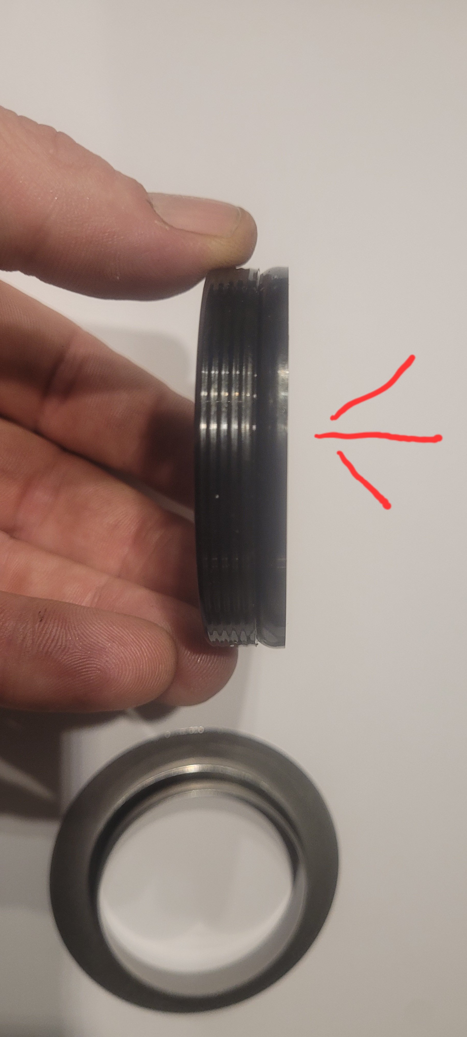

Gavin Waddell
Back with same question about the main seal , which side does the this side go ( red arrow) against beam tube or against trailing arm.
Gavin Waddell
Just spent 5 min looking at the seat and i think the ribbed part goes into the cup and the flange goes against the trailing arm  top hat. Am i correct ?
Leslie green
Red arrow is to trailing arm top hat, ie lip of seal touches trailing arm
