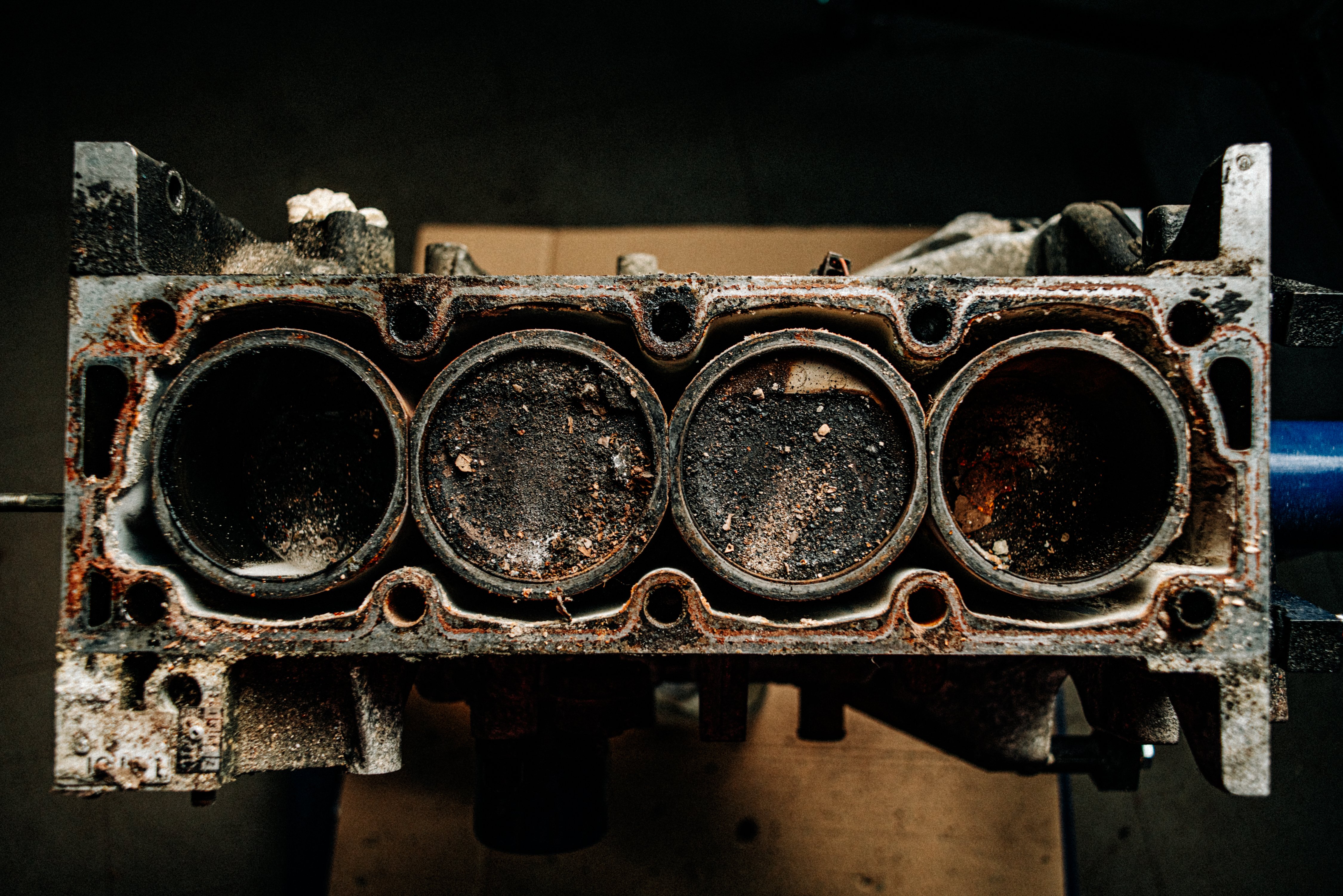

Hey together, my very first post here but feels like home. Have been reading about half this forum in the past three weeks as I dove head first into the 205 world.
I wanted to purchase a regular 205 as my new daily as it seemed to be a reasonable addition for the winter time (been rocking a restored Porsche 924S widebody as only daily for about two years and winter is noooo good). As chance would have it the Green I wanted to buy sold immediately (price was hot apparently) and when this 1.6 GTI popped up just 15mi from my place I knew I had to at least look at it.
Obviously over budget given I wanted a regular one and off the road for a good decade I did my due research and loved the prospect of parts for 1/3 or less the cost I am used to on the Porsche and being the first guy to go and look at it I had to have it.
Now I am no stranger to tools and while not technically a restorer I have space and tools through way too long a story to be told right here. With 240k-km on the clock a long list was made and I got to work. Wasn't so great on pictures, but the whole story is living on video. Ultimate plan is reliable, OEM-spec and sub-10k€ excluding some weird ideas I have.
Before I leave you with this: I need a set of mud flaps. Rubber, don't care about a model insignia or anything but have to be for the 205. Searching for weeks and found nothing. HELP!
Anyway, enjoy - new episodes should be dropping weekly, wanna drive the thing!

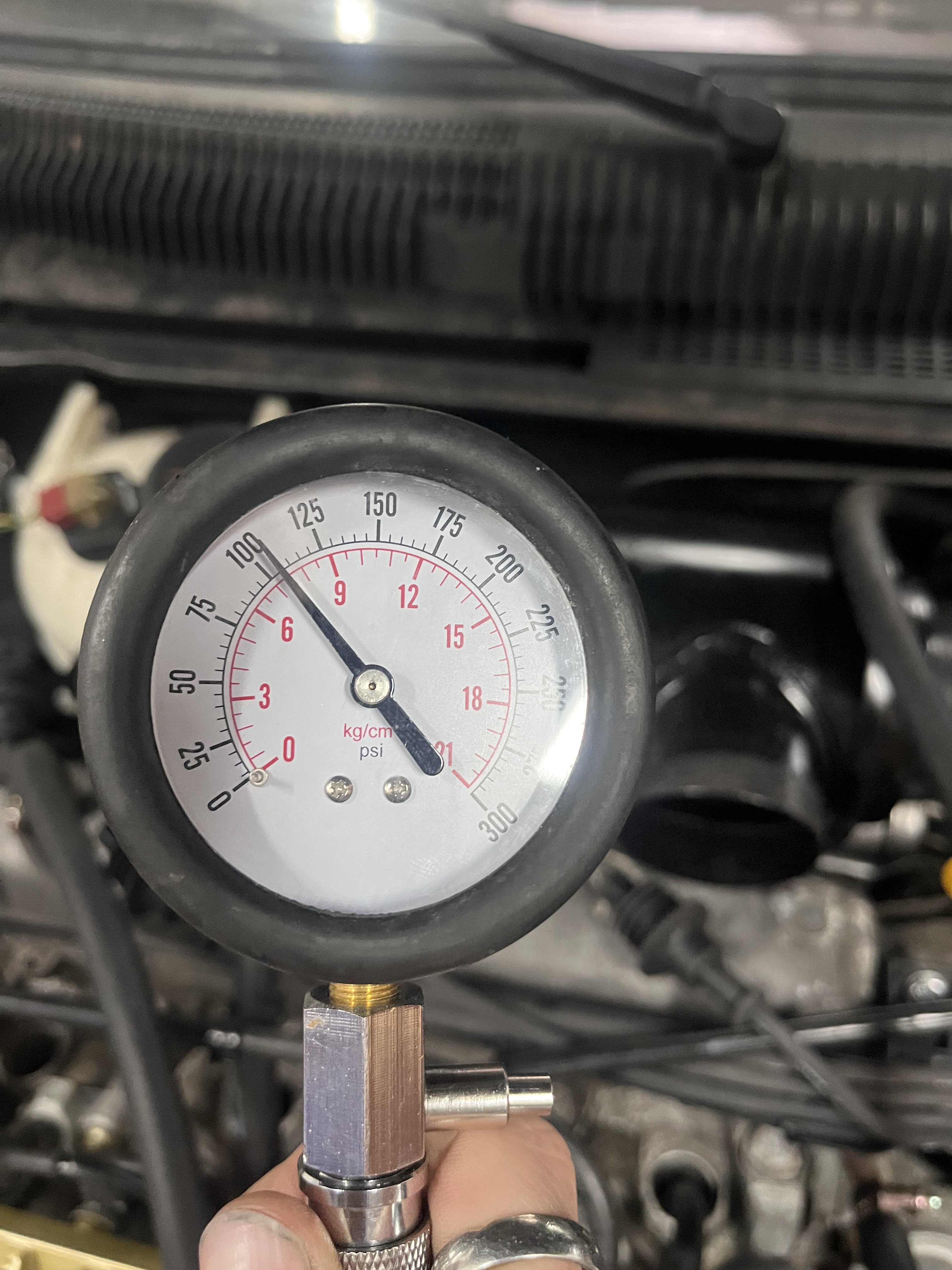

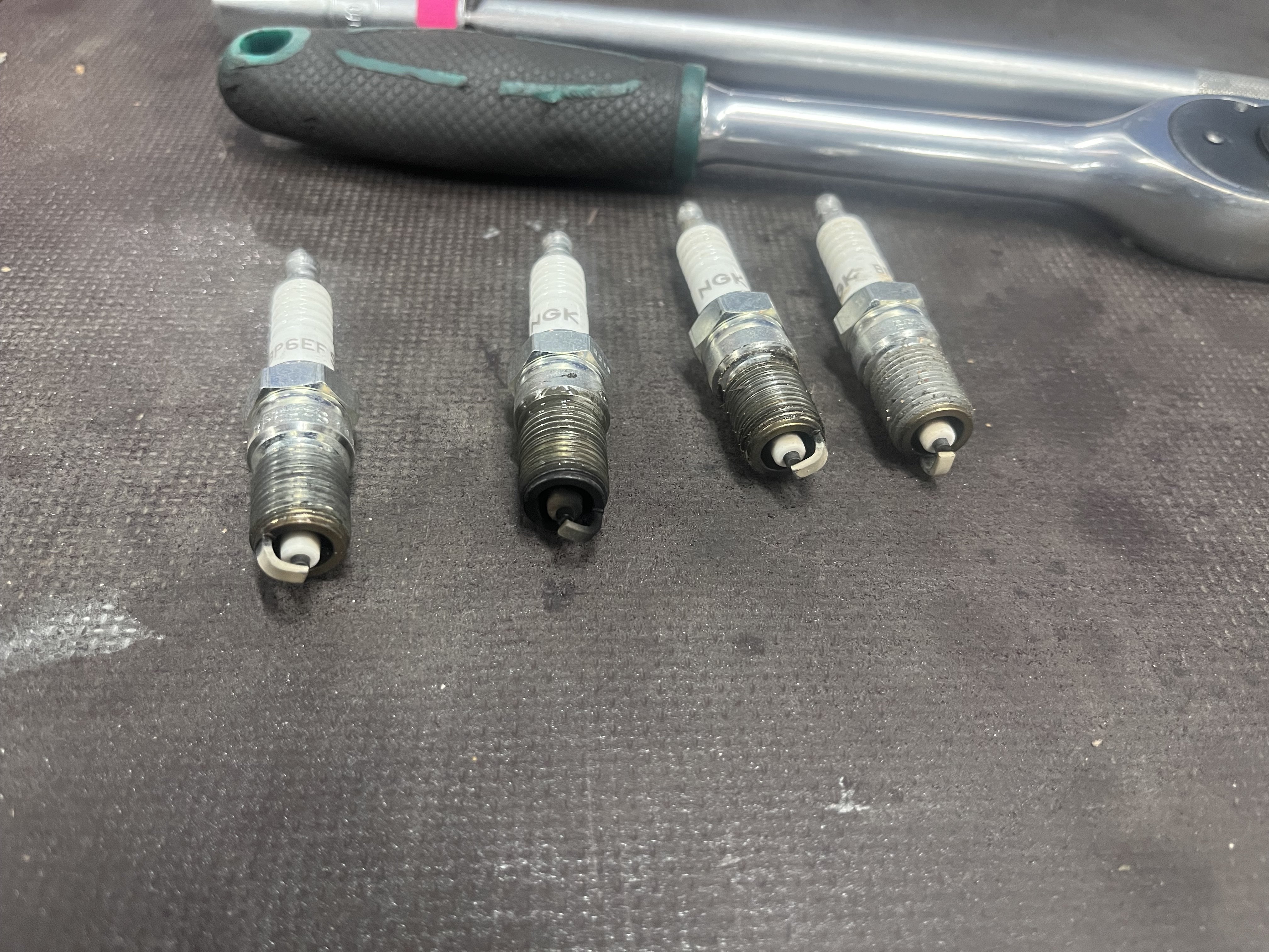

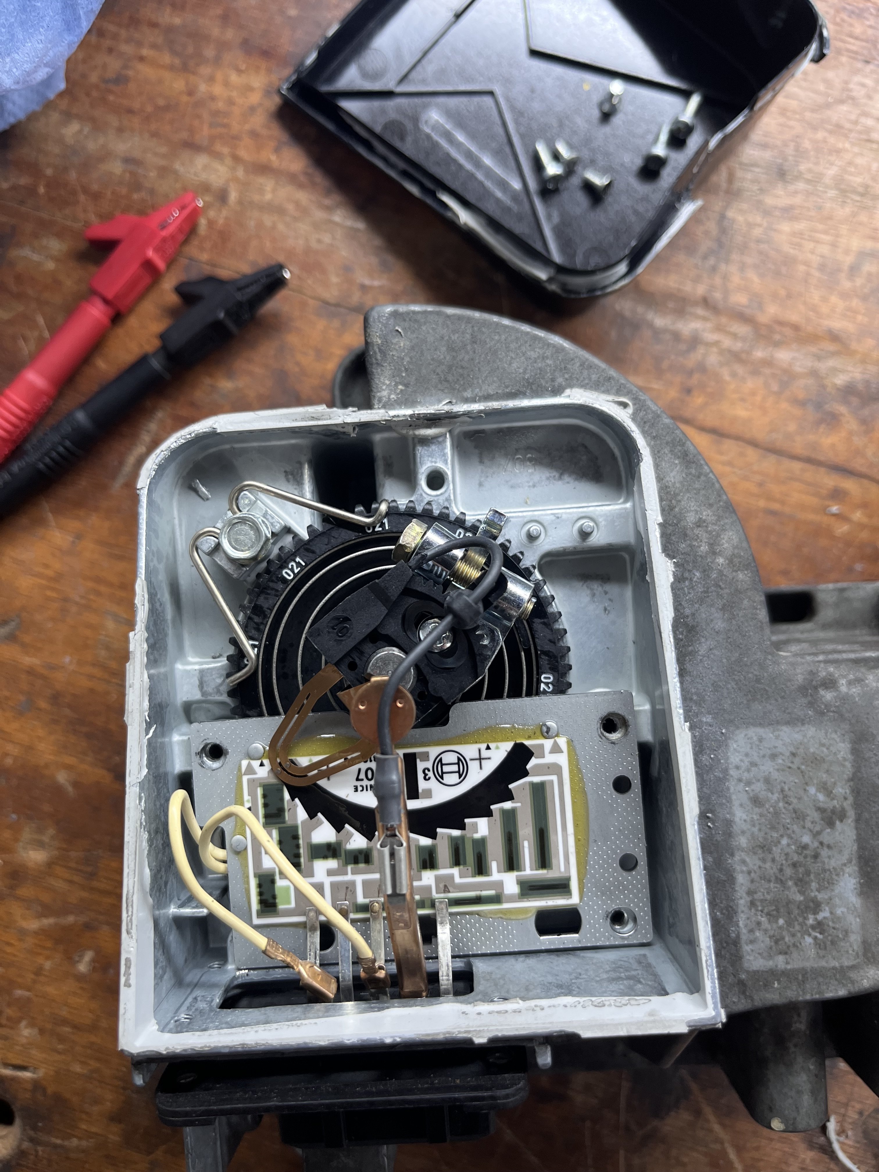

Uff after running through the forum I reckon I ask: After a work-related break from figuring this thing out I finally got it running last week, with quite a few niggles left.
The big one however is fueling related. I read almost all there is on here regarding rich mixture and AFM. My '87 is running a .333 ECU, .056 AFM with a 180A engine (was put in at some point, I have the original 180Z (103hp with Pulsair) one too - looking like a boat anchor).
I have done extensive exterior maintenance on the engine, timing belt, water pump, new alternator and starter, new distributor seal, thermostat, oil pump gasket and so on. Internals are unknown in age and condition. The job was poorly executed and I had to redo almost the entire vacuum and breather setup, which is now new and correct.
Earlier this week I did a full idle setup according to Haynes but struggled to achieve the correct CO (cheap tester but worked flawlessly thus far). The adjustment screw on the AFM did almost nothing (.2 maybe over 8-10 full turns) and I left it with full in and 7 turns out, but significant smell of petrol. Today I drove the car hard for the first time, revving to 6k occasionally and with what I'd consider decent power. Straight after I went to a shop nearby and they quickly put the probe in - 2.5+CO with the pulsair-system unplugged, adjustment screw doing nothing. I then measured the AFM and had 120-ish to 490-ish mid range and down to 380-ish at full open.
Removing the spark plugs gave me more trouble, it seems to lean out a bit more than I thought at higher revs. C2 is also oily over the same white and after a compression check C4 seems very weak (other three sat at just above 150PSI). Both unfortunate but could be ignored for a while, the "rich" mixture though is driving me nuts.
I am going to order a new Bosch coolant temp sensor even though the dash readings are spot on (couldn't measure resistance yet) and likely a used AFM. There was no fault apparent upon disassembly. And just to be safe I am going to take the spare original engine to parts and likely rebuild it.
What am I missing? At idle the AFM should fuel at least somewhat correctly (120 reading vs 150 stock) and why won't the adjustment do anything? I checked for vacuum leaks with brake clean but all seemed well.
You have one sensor for the warning light on the dash, another for the temp gauge and yet another one for the ECU so dash readings only means that the actual engine temp is fine.

I am less and more knowledgable now! The AFM seems to read okay now and matches a used unit I bought with the same part number. The old engine coolant temp sensor oddly seems to be alright too, now that I fitted a new one. I narrowed it down to a faulty injector on C3 (now that I know the engine counts from clutch end...). Unplugging it while up to temp drops the CO by over 1vol% whereas the others each make no difference at all. Let's for once hope that is progress towards a smoothly running thing.
