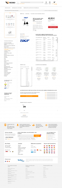

lagonda 42 Posted August 6, 2022 Tom, the CV joint is starting to get noisy, so I doubt a new boot would fix that. Peter, well, that's what I want to avoid! I need to know which ones of those are known to be good in service, and avoid the rubbish! Another option, as you've stated is to recondition it myself. I did see various CV joint kits for sale. How straighforward is it to replace the outer CV? A concern is that the present shaft isn't "Original Equipment", I believe it was made by Da Silva. So, will a CV joint kit readily replace that fitted to a 205 CTi shaft manufactured by anyone? As an example, here's such a kit, made by SKF. Fortunately I still have the two previous shafts, so at least I have a choice as to which to recondition, if I choose that route. 205 CTi shaft manufactured by anyone? Share this post Link to post Share on other sites
DamirGTI 345 Posted August 6, 2022 If yours is 1.6 as standard , you cannot replace/separate outer CV joint on a 1.6 driveshafts only the inner tripod . All of the listed brands are questionable quality wise and likely all the same part just sold by different brand name . From the lot , i only ever heard/used : General Ricambi and Metelli , those two are Italian brands , first one is known for recon parts (driveshafts , steering racks , PAS pumps etc.) but mid or low quality , later is pretty big brand which makes all kinds of spare parts but also middle-to-low level quality . Try to find good second hand OE Peugeot shafts , or GKN/Loebro/Spidan shafts (GKN was OE driveshaft supplier) - Loebro/Spidan it's all the same GKN part and best quality you'll get from the aftermarket ones . However , if i where you .. i'd switch to 1.9 driveshafts (again find OE Peugeot or GKN/Loebro/Spidan) ... I had nothing but problems with 1.6 shafts in the past , had to replace a lot of them till i finally gave up . When switched to 1.9 shafts - no more problems , haven't bought/needed single one or any of the shaft parts since , except the boots but they're "consumable" part anyways . D Share this post Link to post Share on other sites

DamirGTI 345 Posted August 12, 2022 SKF - yes approved , it's always been quality stuff and it is also regular OE part supplier for various different car brands/makes so should be good . Not sure about the RCA , never heard about them might be known mainly locally in France . Only thing with the SKF driveshafts , the CV cone (outer on the wheel side towards wheel bearing) tends to be machined incorrectly , but mostly with regards to 1.9 driveshafts not sure about the 1.6 item . Additionally , tried perhaps local French advert site for some spare/used or even new "old stock" genuine shafts ? : https://www.leboncoin.fr/ ... obviously there's always a lot of spare parts to be found for 205's , handy if you're based in France . D Share this post Link to post Share on other sites
