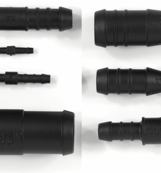

Old hose on an old car. Time to get creative with alloy joiners and silicone elbows.
Gohn
if you do end up making your own hose out of several joined sections
make sure your joiners have barbs/ridges to clamp the hoses securely to
I made up a hose that was impossible to find like yours and the joiner burst out one day and it could easily have destroyed the engine if I didn't notice straight away314533143_ScreenShot2022-07-28at10_58_07PM.png.66ef415e44eb48990e7ffd9b37073bd3.png
