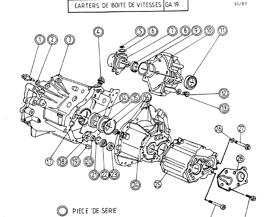

This might shed some more light on this issue. Gearbox starts at (PDF) page 59. It sure has the look of the PTS box.

SRDT
The gearbox in the picture is the six speed BE1 made as a kit to transform a regular gearbox, any part circled twice is retained from the stock GTI. Compared to a 5 speed with a close ratios gearkit and shorter final drive it's only a few more parts.
When Peugeot switched to the BE3 the bellhousing became special, I think it was sold as a complete gearbox at this point and that's probably what you have here.
The design was later adapted for the road going 306 GTI6 and Peugeot Sport started using stock 306 parts as much as possible.

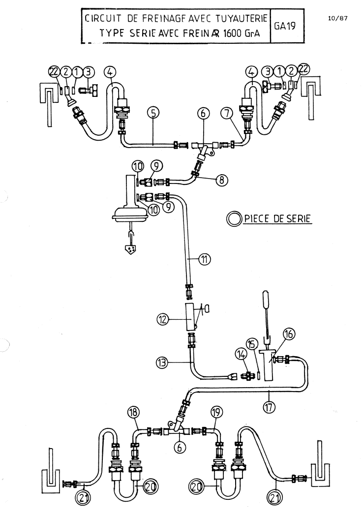

But this one:
WTF is that about? Why all the 'joint cuivre' and 'Tuyau cuivre' pieces, translates to copper piping. But part 20 makes no sense to me?
Sorry for the hijack, I'm just fascinated ^_^
The double ringed parts are stock parts kept in place. So #20 must be part of the standard 1.6 brake piping.
 Part 20 will be the flexi fitted between the beam / radius arm & body rigid pipes.
g
Translation states it's copper
That makes sense as the last piece on a standard  1.9 was flexible  unlike the later psa cars using the same trailing arm and caliper

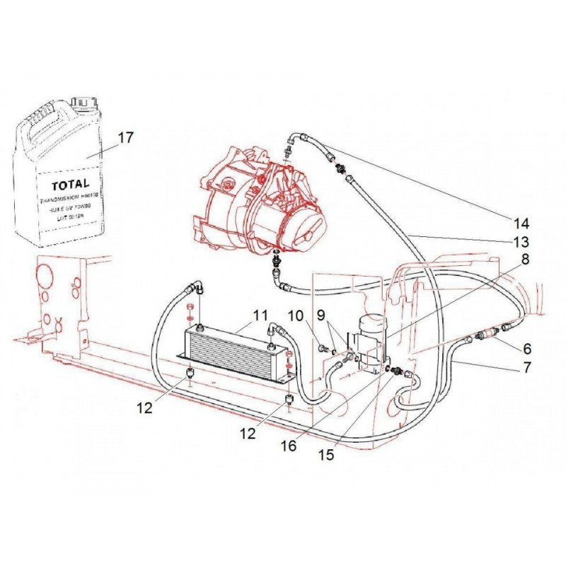

Is your other gearbox the same from the outside?
I find it hard to tell TBH. Looks like a generic 6-speed box to me, apart from that second drain hole (?) underneath. No special markings, etc. visible
SRDT
It looks pretty much the same. It could have been the newer 306 style cases or the shorter dog box.
That 2nd drain hole, is where the cooler connects. My BE3/6 doesn't have it.128477412_gearboxcoolingc20-bv-saxo-t4.thumb.jpg.07930191aec6250995c3d8558d8cc128.jpg
DanteICE
Since it's got a pump, does it have positioned squirt jets inside to spray directly onto the gears?
SRDT
I can't find what's going on inside, the Saxo Trophée T4 gearbox is 4WD with a custom transfer case so maybe it's used to cool that part.
