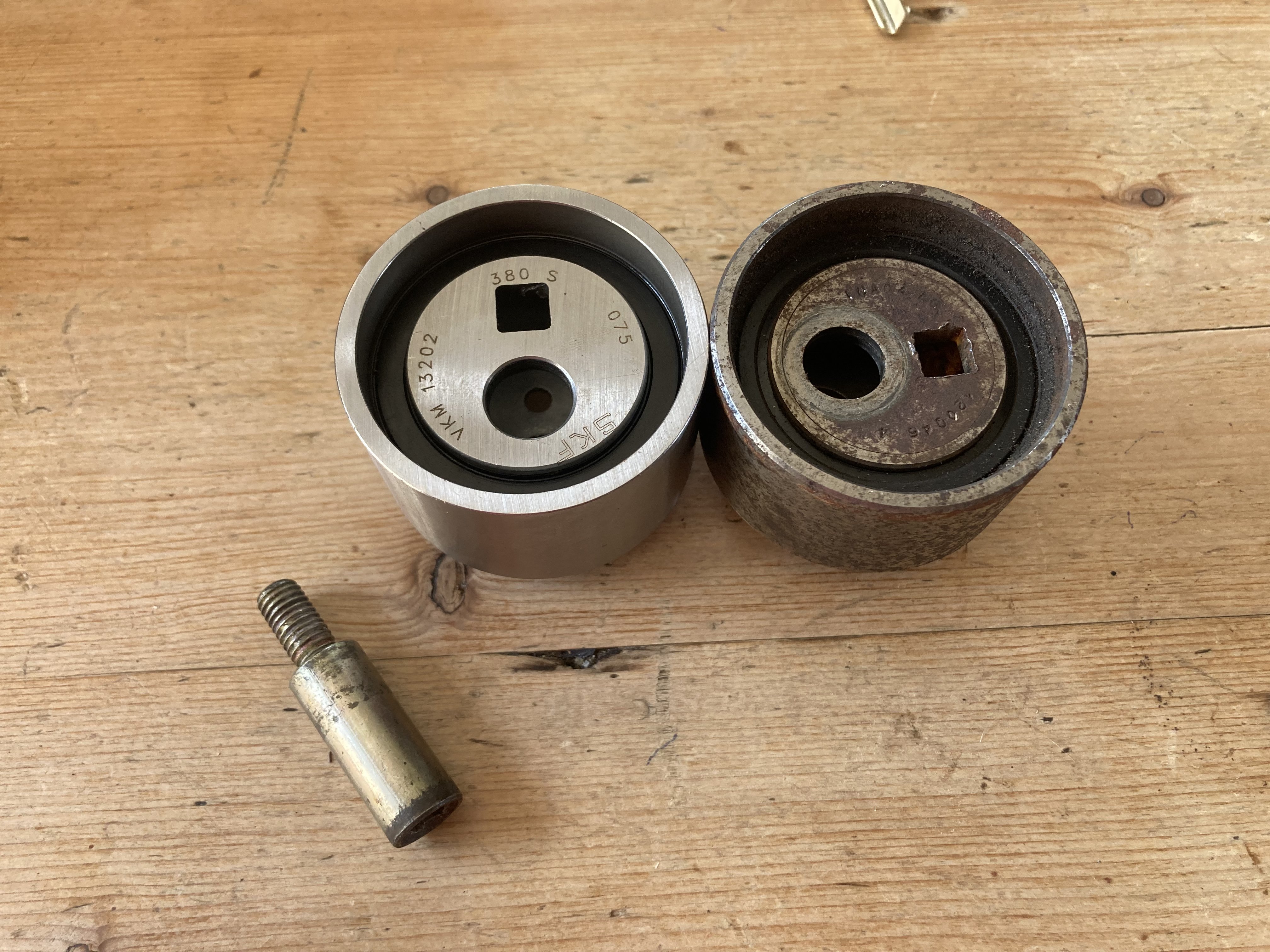

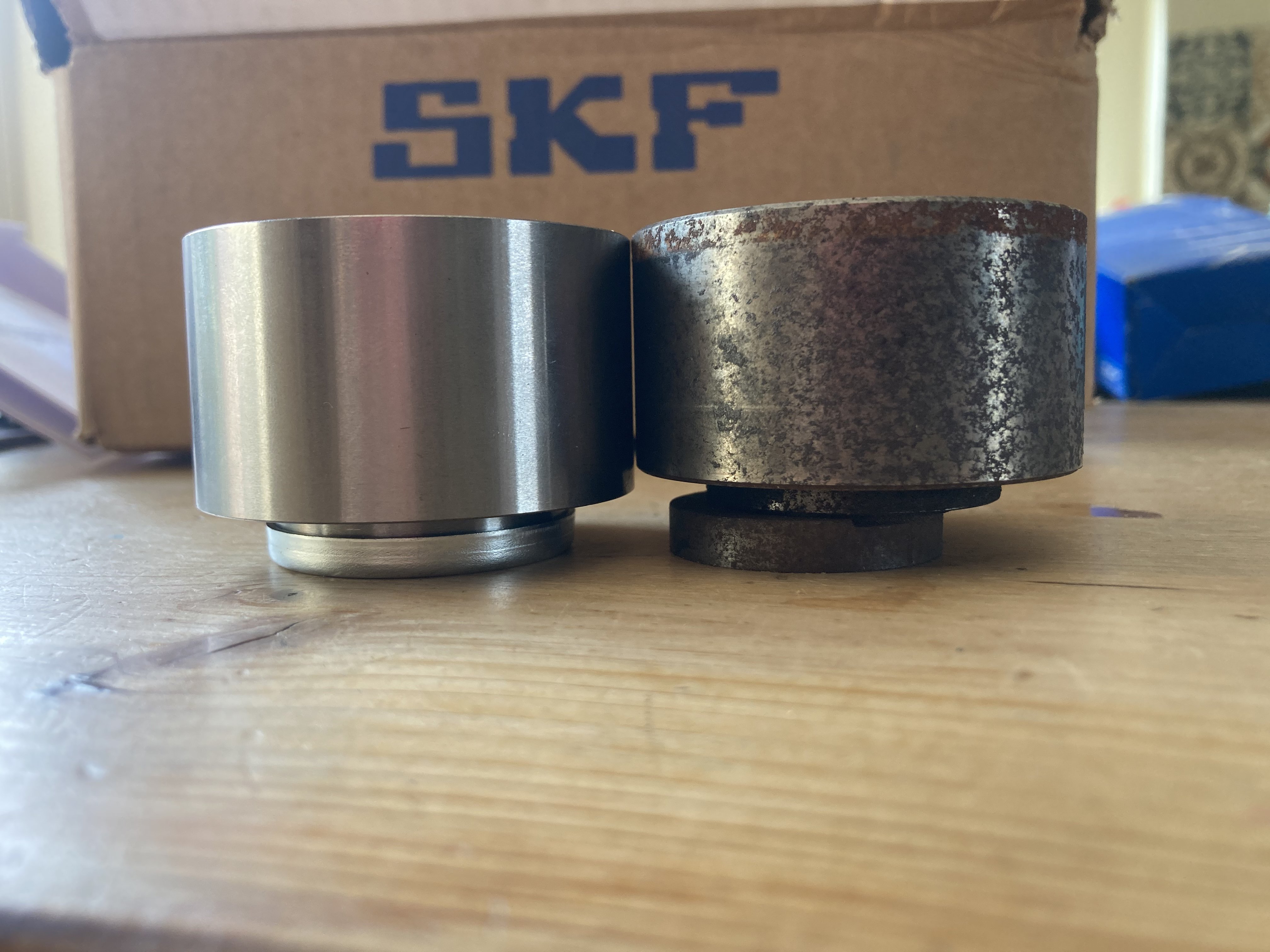

So for anybody that’s interested I’ve got a pair of SKF vkm13202 tensioners from a xu10, which are similar in dimension but have a slightly different pillar mount. Slightly larger holes and the posts need to be slightly longer, you could possibly put a spacer under the xu9j4 pillar to extend it but the slop in the hole put me off a bit.
I’ve just ordered a pair of 0820.17 pillars off Peugeot which I’m hoping are the correct ones for the tensioners, failing that I’m making some.
Bit of faffing about but all being well I’ll have a dayco belt and skf tensioner for just shy of £85 so not too horrific!

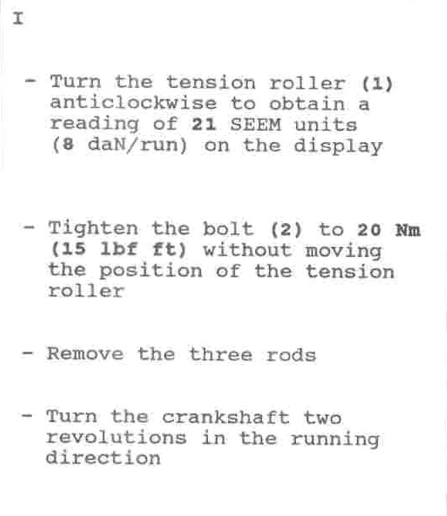

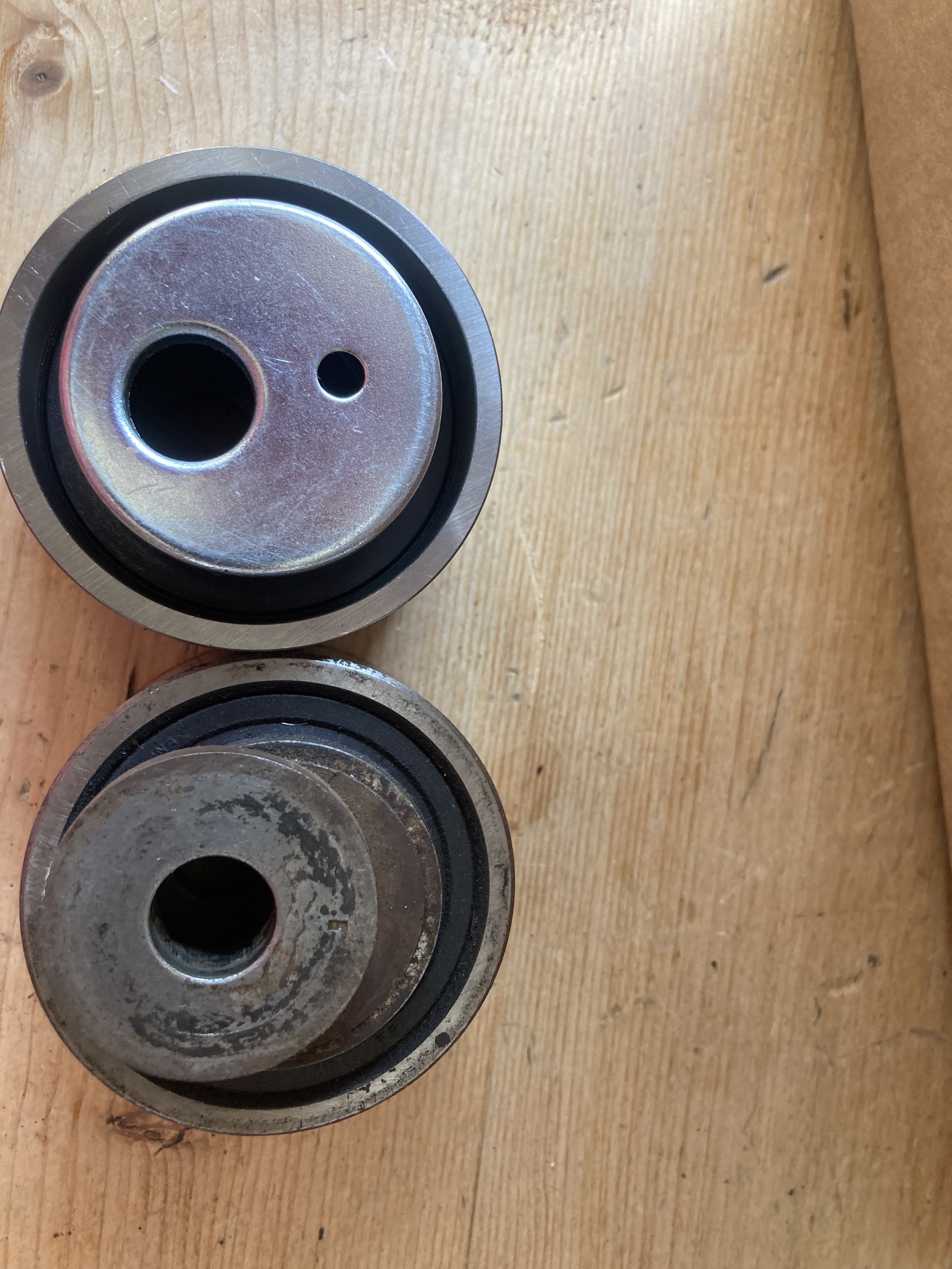

For anyone interested and for completion of the thread, what I’ve done with the new tensioners works but after sleeping on it I wasn’t happy with it.
The new style pulley doesn’t have the eccentric piece on the base which means when you try to rotate the front pulley anti-clockwise to tension the belt it fouls on the Allen headed block plug. I initially rotated it clockwise, this however lengthens the front belt run but worse for me is that the force from the belt is constantly trying to undo the pulley. It’ll probably be fine in practice but it didn’t bode well with me and I’m almost certain the correct procedure is to rotate both tensioners anti clockwise for this exact reason.
So I’ve ended up with the new style pulley on the rear and an old style pulley on the front, the front pulley was from spoox, I couldn’t find stock anywhere else, not cheap at £72 plus postage although Peugeots last list price was £68 +vat each!
so there we go, not such a cheap cambelt replacement in the end :rolleyes:
Anticlockwise indeed.
