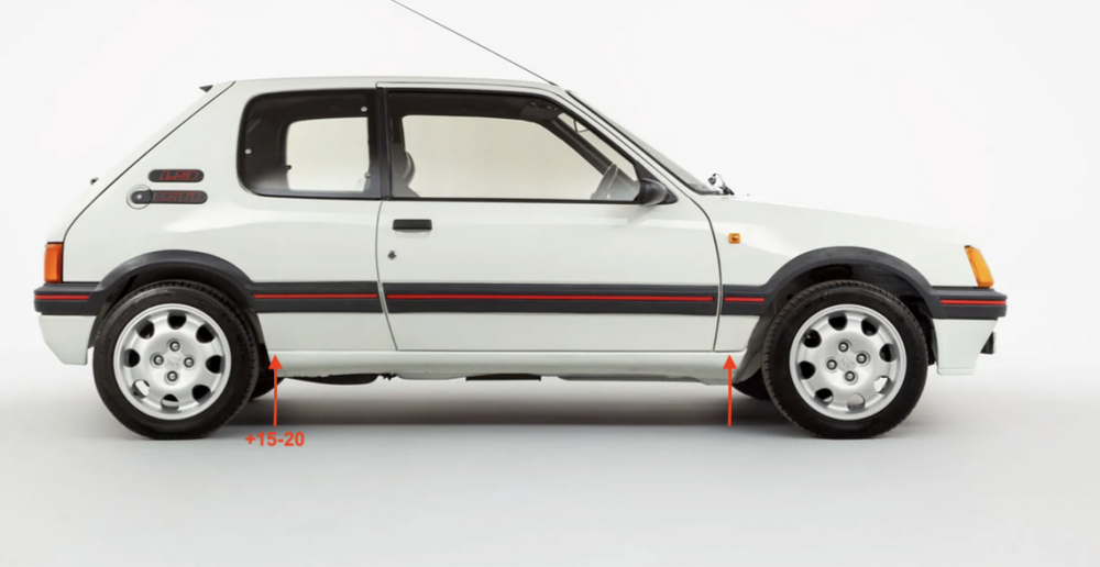

where do I best meassure the rake?
I use the edge of the chip guard material along the sill.

1 cm higher in the back means weekend work.
is 2 cm what I’m aiming for?
thanks guys.
Edited by mmt
At least 15mm, yes.
