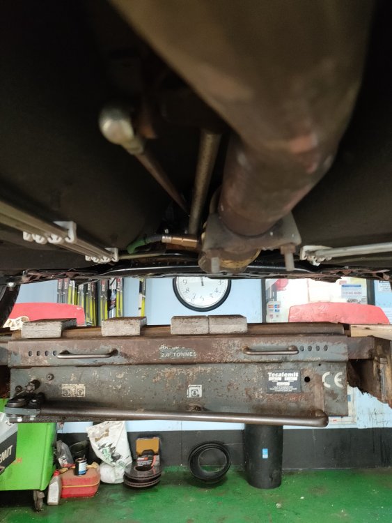

Im going to first check the sensor angle, i think its horizontal, i may be able to angle it downward so condensation naturally drips off as well.
Its just after the collector on a 4 branch manifold

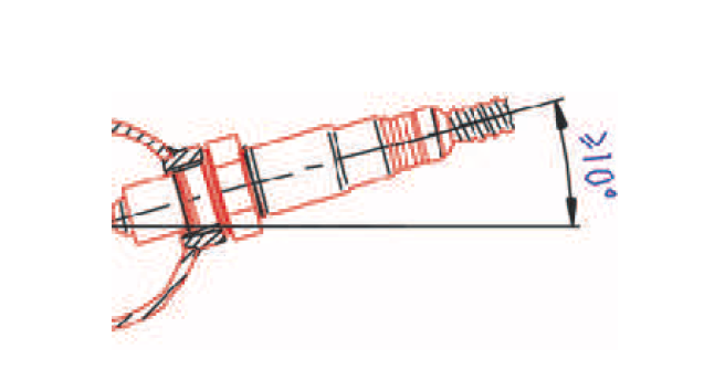

The sensor housing should be pointing slightly upward.
Data Sheet_69034379_Lambda_Sensor_LSU_4.9.pdf

Yes thats what ive been reading, 10 degree angle to prevent condensation collecting in the tip. I suspect mine is flat so need to check. If it is i will slice the pipe, rotate wand weld it back up, that or fit a second boss at the correct angle and put a bung in this one.

Not the best photo but i suspect its a little less than 10 degrees but is angled down.
