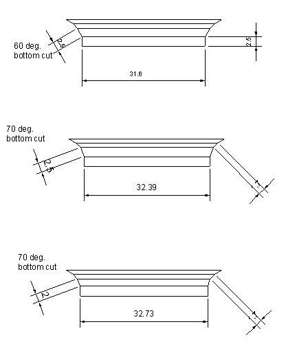

I’d be worried if he’s asking you. It doesn’t sound like he has a lot of experience cutting seats. Is there a speciality head place close by? And how does he cut them? Modern seat cutting is done with a single tooth, carbide cutter, which is cnc, driven by a computer. They require no lapping because the finish is so superior and a profile can be cut down into the throat, minimising the need for hand blending.
Also important, is not just the angles but also the width of the seat. Regardless, I post some profiles for you tomorrow that I use.
Sorry, this is for a 16V inlet valve, but you'll get the idea.
