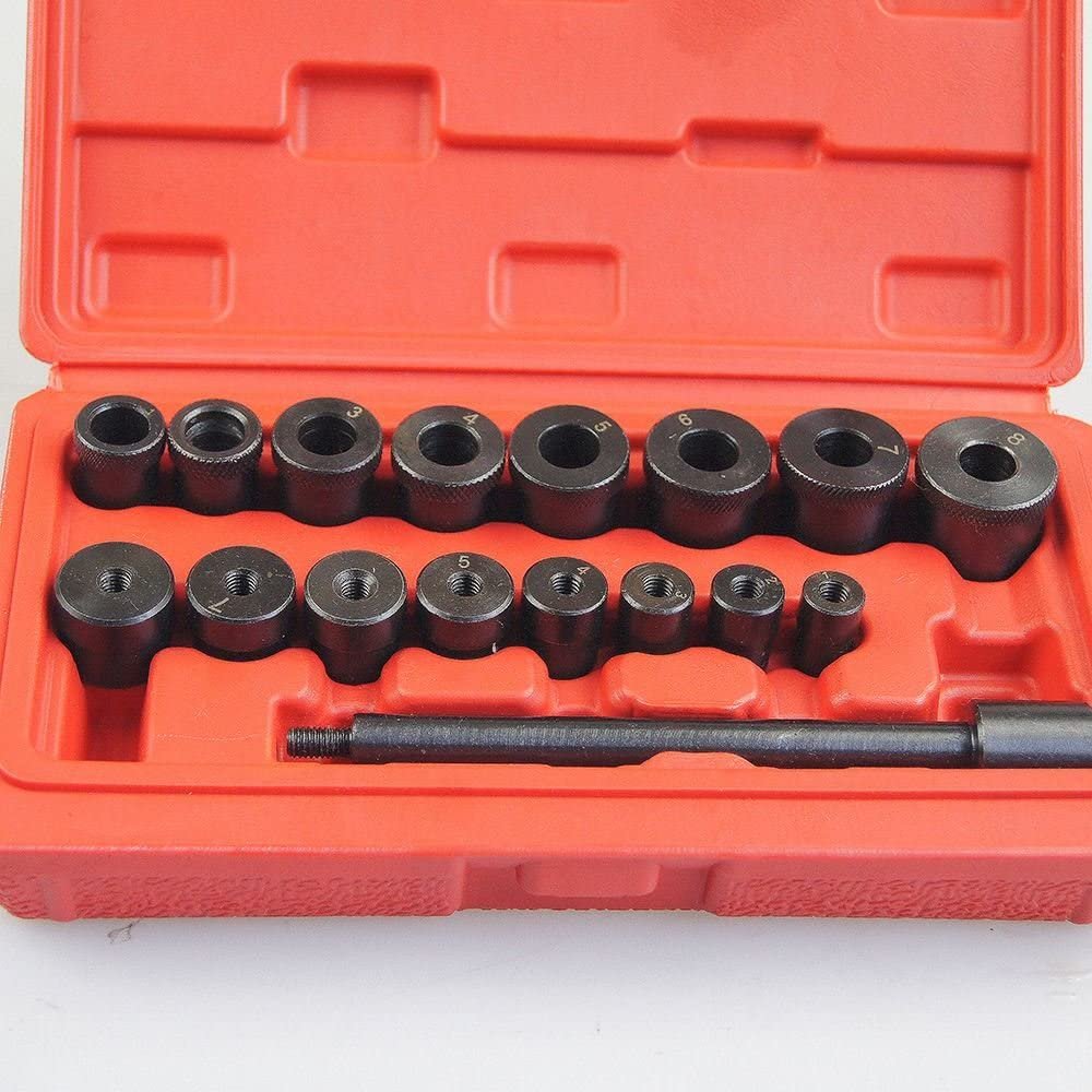

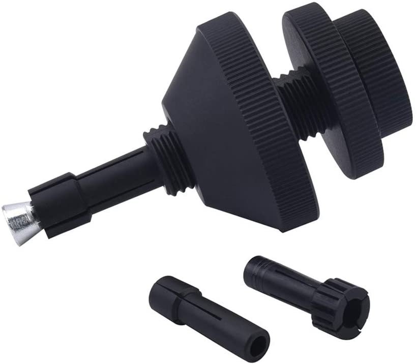

Yes, I know a socket extension bar wrapped with tape can work, but specific tools seem to be reasonably cheap. I'm familiar with the type in the red box as I recall using my brother's to help him replace the clutch on his Golf. But what about the black plastic (supposedly heavy duty) one? Has anyone used one of these, and with good results? It would appear to have the benefit of being "infinitely" adjustable, whereas the arbor type can be a poor fit, which isn't helpful for accuracy.

Thanks for all replies. Impressed to see concensus of aligning by sight/feel! Whilst this will be my first time changing a clutch on my CTi, I've changed others on other cars, and usually had "fun" getting the gearbox shaft entered, so just wish to avoid any doubt. Interestingly the Valeo kits over here don't include an aligner, whereas I see UK ones do!
