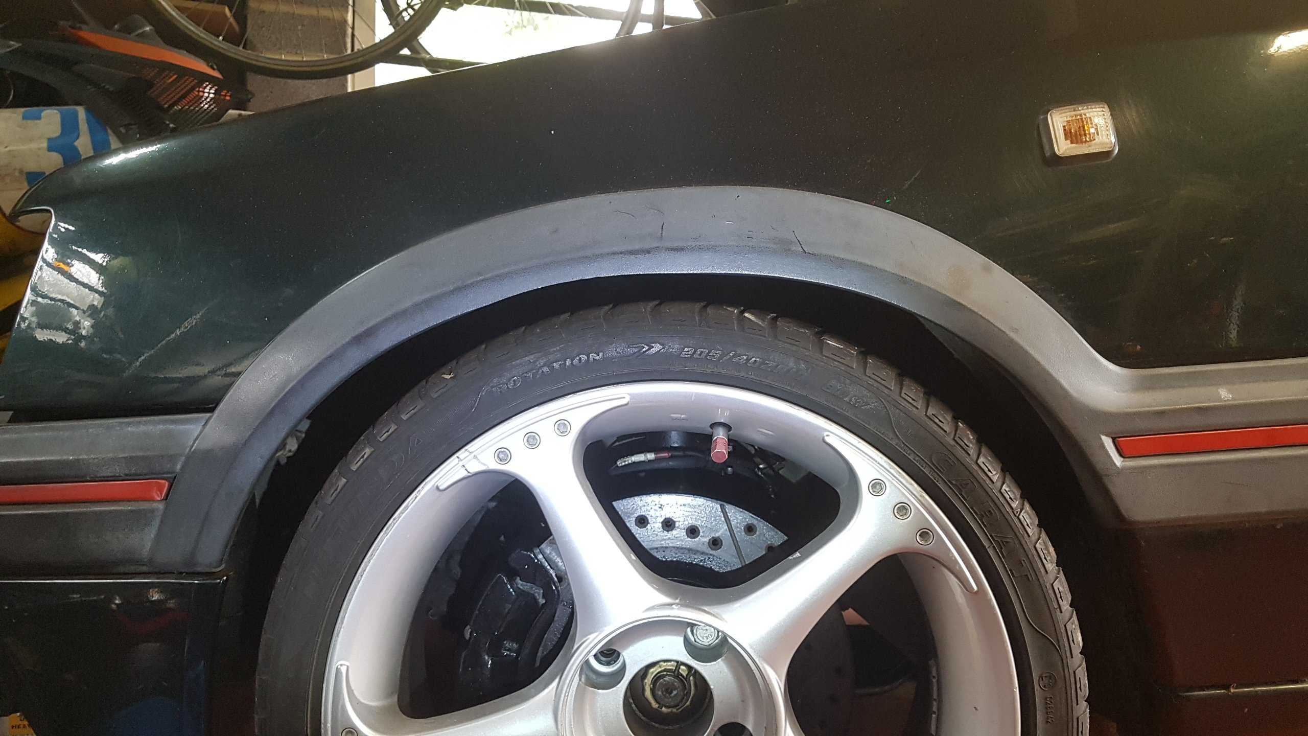

Got a 1994 1.9 in Sorrento Green :-). I know it's been lowered, so I really should have done some measurements before removing beam/axle :-(. Everything was seized to hell, so I ordered new axle from IMaxles. They're now asking what ride height I want it set to. I've got 17" alloys with 205/40 tyres on, and can JUST get my hand between tyre and arch trim at the front. Anyone give me a clue what I should tell them to set my new axle to so the rear matches the same ride height? They're saying they can drop it by 10-40mm. Thanks!

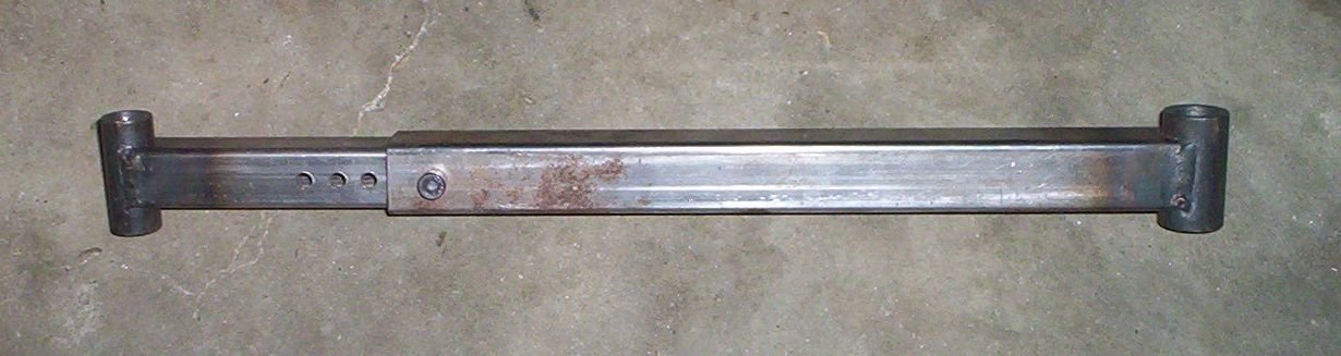

You just need to drill 2 holes in a strip of metal at that distance and fit it as damper. The fiddle the bar in and do similar on the other side. It also guarantees that you set both sides at the same height.

Attached is a pic of my shock length tool.
