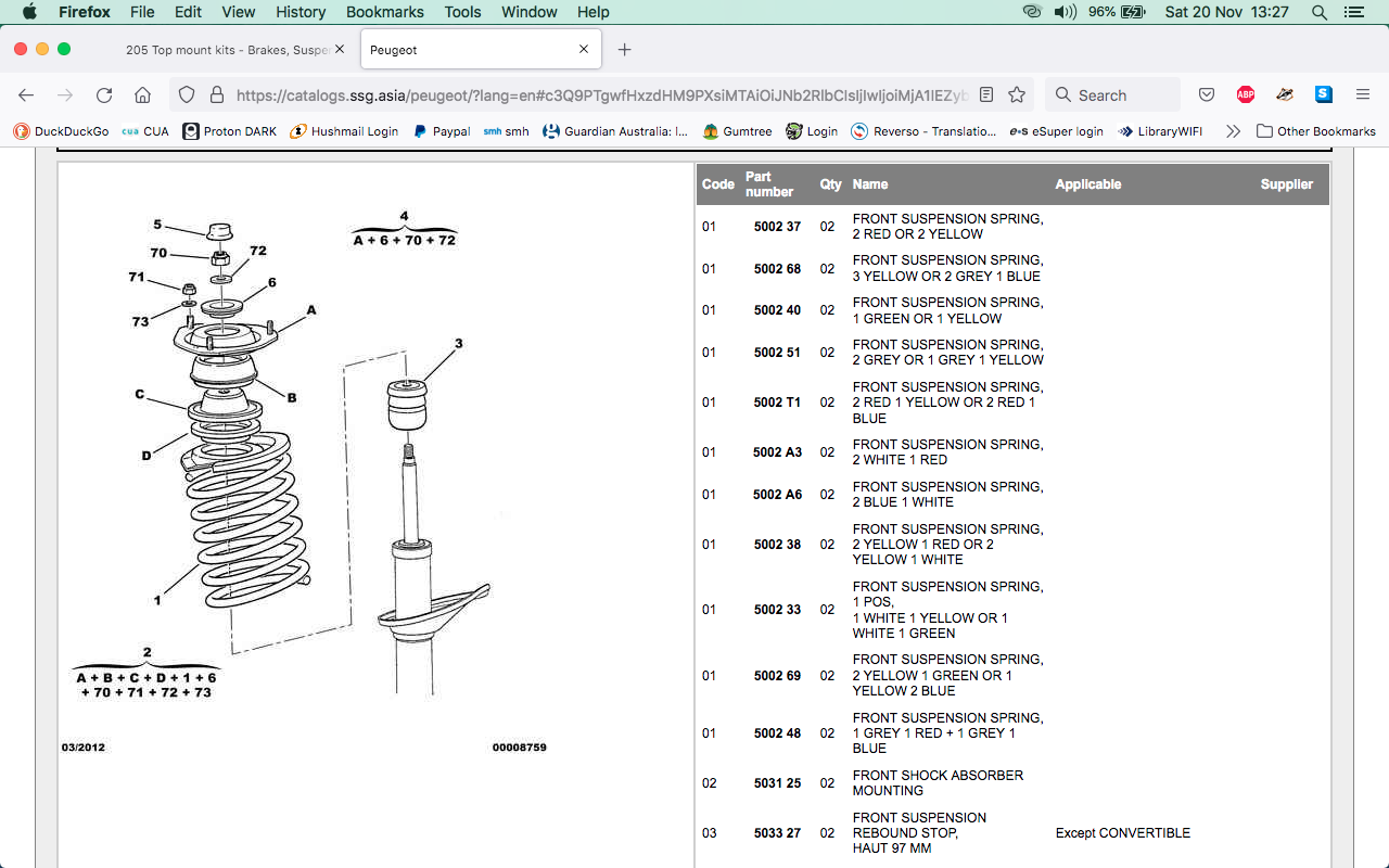

At last got round to checking for free play in this joint, following advice kindly provided.
Result? I can't detect any free play in the ball joint. What I do find is that the entire strut moves up and down, which I suspect is what the tester observed but uselessly misdiagnosed. This is supported by the fact that whilst there is some movement similarly, checking the OS one, it is nowhere near so pronounced.
In this picture, I'm seeing cup 6 moving up and down as I lift and release the (jacked up) wheel. Does this mean I need to replace item B and/or D? Anything else?
The car has now covered 231,000 miles, and the struts and springs are undoubtedly the originals. The car handles fine, but would I be best renewing the lot given the work involved?
for the up and down play there is always some but if its excessive then its likely the top rubber donut is deformed, no need to replace anything else if its all in decent nick though probably worth bunging in a new bearing whilst its apart, I think the sasic branded kit even comes with both as a set.
as for it all being original with 231k miles on it and "being fine"    i highly doubt that, try a car with fresh dampers and you'd be hugely surprised!!
with the base model suspension having a TCA using the arb for fore and aft location it can be harder to find the play, jack up and support the car on the subframe so both sides are off the ground to take any tension out of the equation,  grab the bottom of the wheel and pull in/out whilst feeling for play between the pin/hub and the arm, you can also place a lever over the arm and under the track rod and push down.

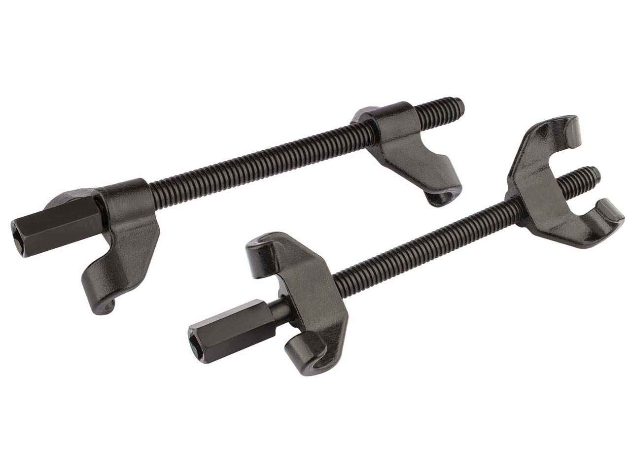

Many thanks. I'll probably do some bodge to get it through its CT, then investigate properly. One of the few tools I don't have is coil spring compressors. Did buy a set back in the 70s to do some work on my brother's Capri. Whatever we did, the clamps moved towards each other as we tightened, to the extent that we gave up as it was too dangerous to carry on. I don't normally throw anything away, but the experience was that bad, these were chucked. So not only do I need to buy a new set of spring compressrs, I have to be sure they're not the same garbage! Point taken re the dampers, good opportunity to replace them.
I have a couple of pairs the same as these. They are perfectly adequate for a 205 front spring.
