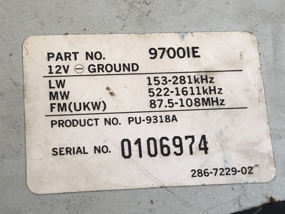

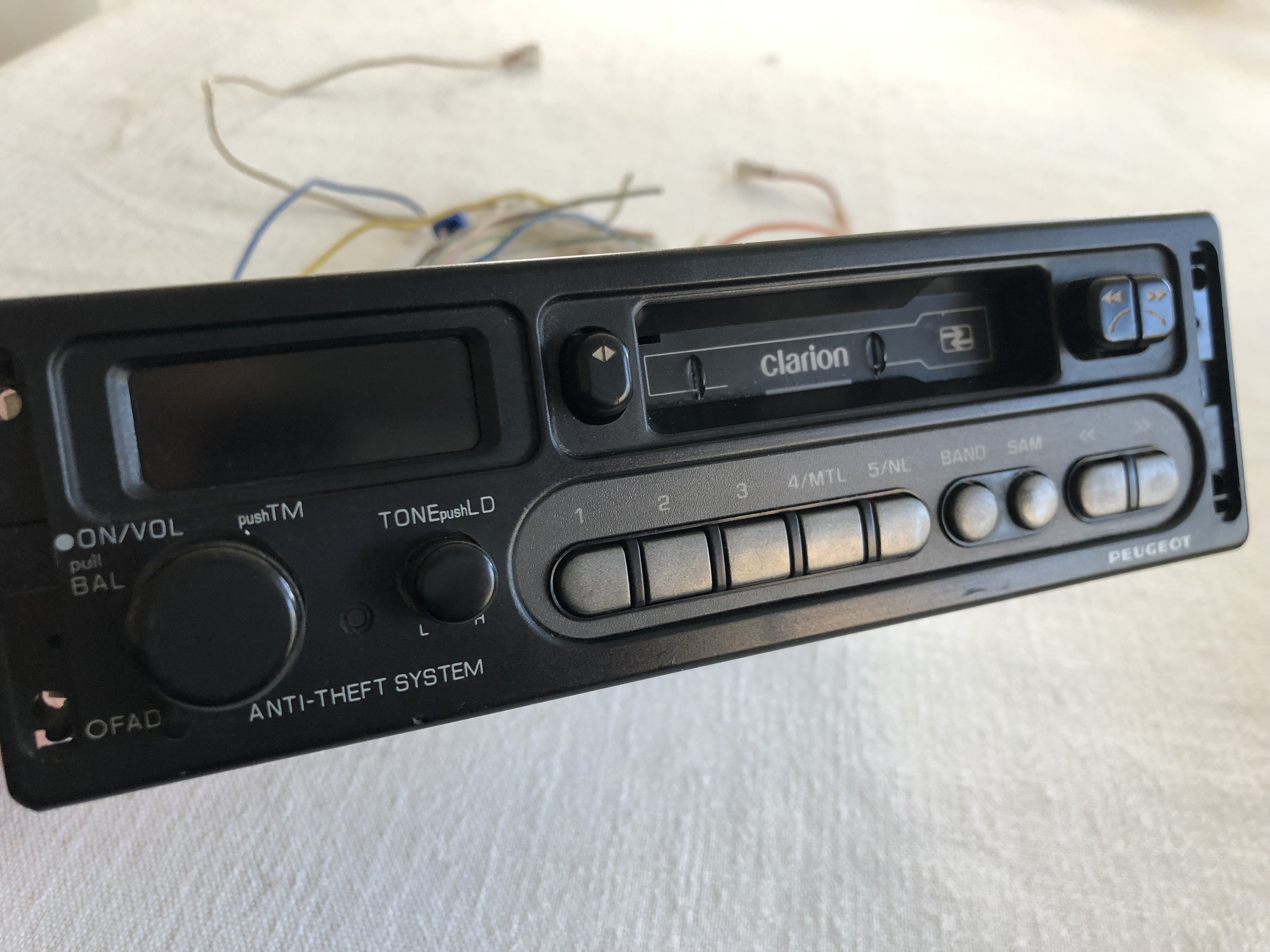

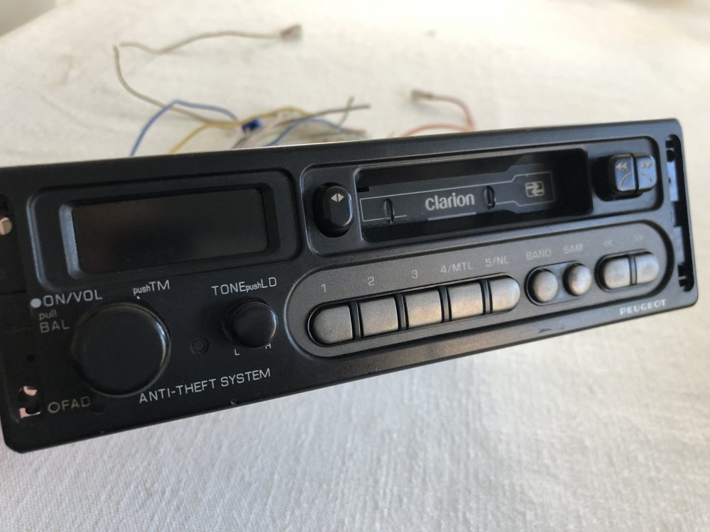

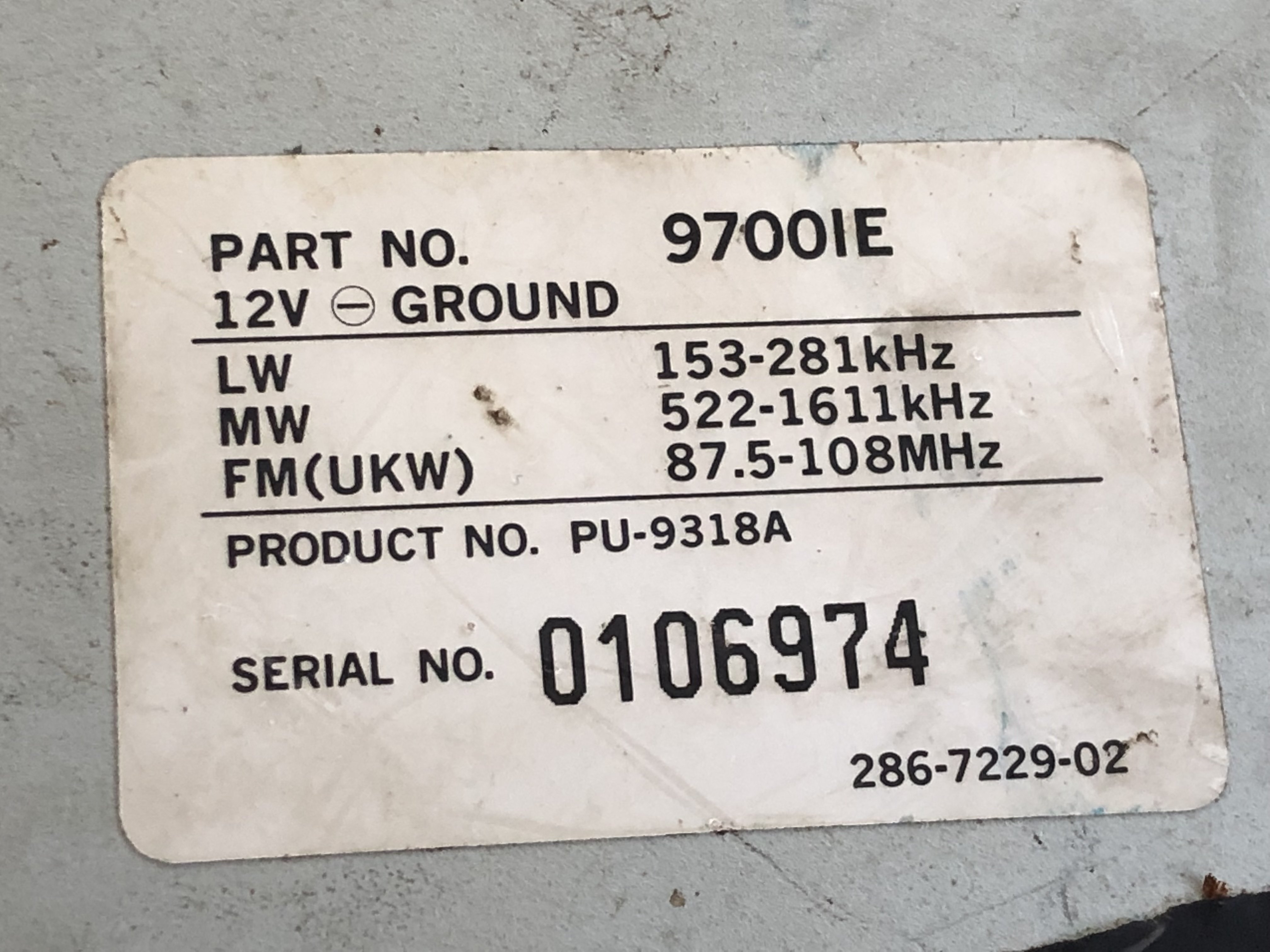

RobScott   1 Posted January 5, 2022 Hello all. I have just signed up and am brand new to this forum. I might ask a few stupid questions so please go easy on me! I’m sure the answer is on here somewhere already but I have a Clarion Stereo which I have bench tested, it powers up ok but I don’t have a code for it. Can anyone help me to decode it or let me know someone who can please? I’m attaching a couple of photos which show the front panel and the sticker on the case which shows the serial number. Share this post Link to post Share on other sites

Gohn   71 Posted January 6, 2022 I just went thru the same but the OE stereo units issued to the 205's in Australia were Eurovox and they're way easier to use than the annoying aftermarket versions its obvious but just check all over the stereo, sometimes owners write the code in black texta or something also sometimes the little white card is stuffed inside the fold out owners manual (if you've still got it) so check all thru that in my case a local peugeot dealer got the security code by checking the Serial number of the unit on their system apparently they can also cross check it with the VIN of the car it came out of  Share this post Link to post Share on other sites

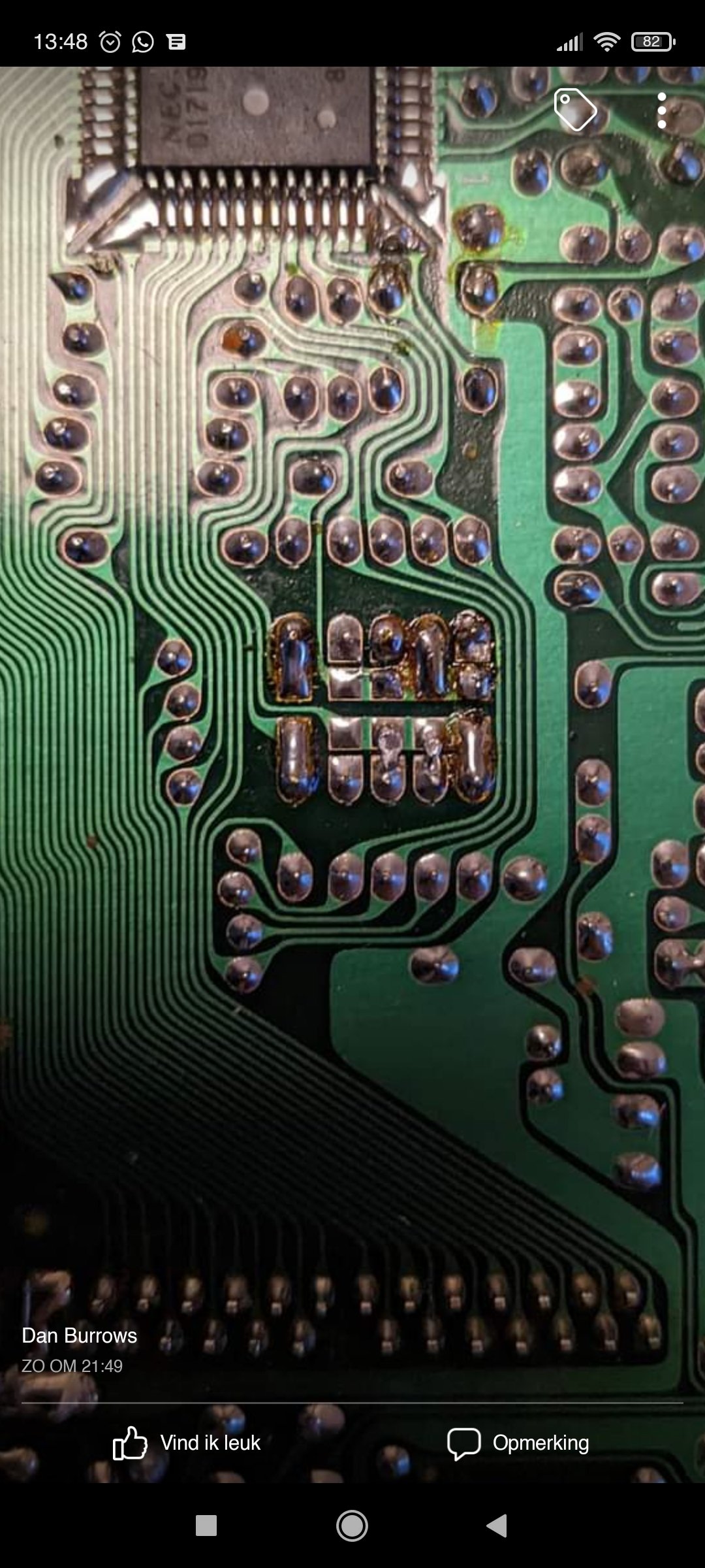

Anthony   1,003 Posted January 12, 2022  On 1/11/2022 at 10:52 AM, RobScott said: Hi, if I tried this method of entering possible  codes one by one what keys do you need to press to go through each code please? Can you just repeat pressing the keys 1,2,3,4,5 forever and as soon as the unit detects the correct 4 digit code it will accept it? Basically, yes - start with 1111, clear the code by holding the "Band" button if it doesn't work, then try 1112, so on and so forth. Can take a while if you're unlucky enough for your code to be in the 5000's but there's no lockout for too many incorrect codes  If you get stuck, pop the cover off the bottom of the unit and send me a picture showing the solder links on the PCB near to the microchip - I can decode it from that. Share this post Link to post Share on other sites

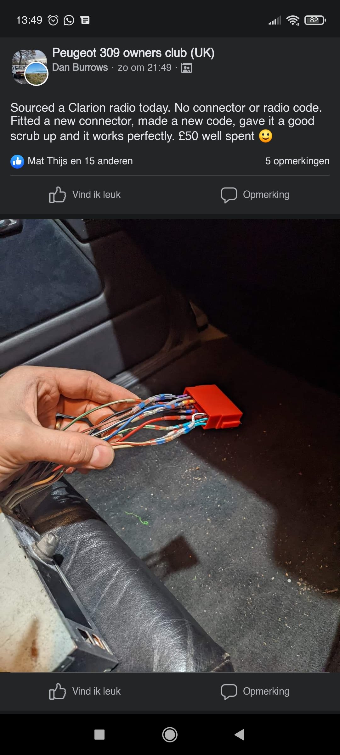

Thijs_Rallye   89 4 Cars Posted January 25, 2022 On 1/11/2022 at 11:53 AM, RobScott said: Hi I tried this but no luck unfortunately. I just came across this topic on fb. Might be worth looking into. Credits to Dan for posting this.  Share this post Link to post Share on other sites

Thijs_Rallye   89 4 Cars Posted January 26, 2022 5 hours ago, Gohn said: rewiring a motherboard It's just setting the code by connecting and disconnecting pads. Pretty similar how the PLIP module can be (re)configured.  I still have to find the first friendly dealer who actually wants to genuinely wants help with these old cars. They mostly even can't even be arsed to sell you parts because the car is too old and they don't want to search.  Maybe it's different in Ozzy or the UK. Share this post Link to post Share on other sites
RobScott   1 Posted January 26, 2022 7 hours ago, Gohn said: rob have you actually tried a peugeot dealer yet ? dunno if they're local to you but Fish Bros are bloody nice  you've got the serial number, and probably even the vin  its a way easier option than rewiring a motherboard or whatever's on zuckerbergs datamine Hi yes I gave my local dealer a call and they think they can provide the code from the serial number and will charge £26 for it. So this is the route I’m probably going to take. It is not the original unit for the car so the serial number and vin won’t match, I hope that’s not going to be a problem. 1 hour ago, Thijs_Rallye said: It's just setting the code by connecting and disconnecting pads. Pretty similar how the PLIP module can be (re)configured.  I still have to find the first friendly dealer who actually wants to genuinely wants help with these old cars. They mostly even can't even be arsed to sell you parts because the car is too old and they don't want to search.  Maybe it's different in Ozzy or the UK.  Share this post Link to post Share on other sites

Thijs_Rallye   89 4 Cars Posted January 28, 2022 On 1/26/2022 at 10:35 AM, Gohn said: feel bad that I suggested it  Don't be sorry mate , no need to.  @RobScott If you decide to try the pad reconfiguration make sure your board looks identical to the one in the pictures. Share this post Link to post Share on other sites
