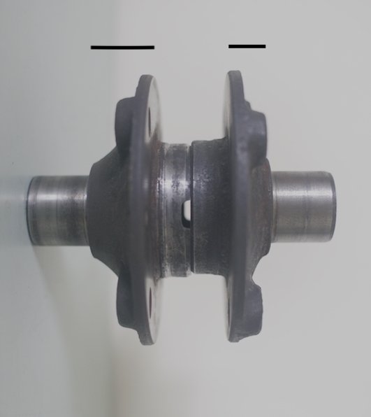

I've only got 2a(Base Model) and 2b (Deep Offset) hubs, but have put up some photos with bearings removed to try and show what they look like.

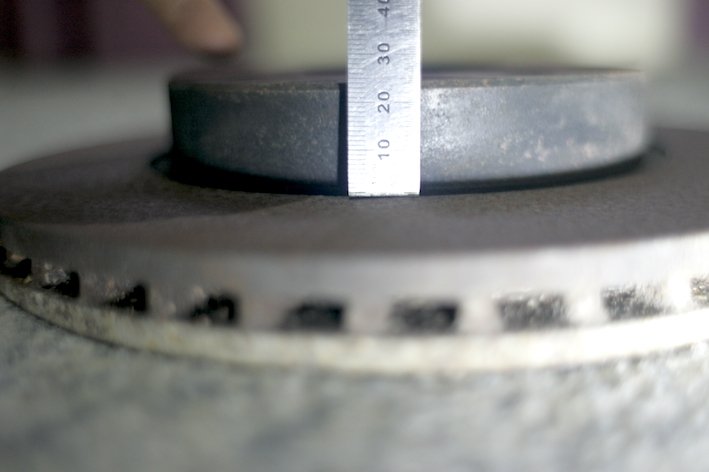

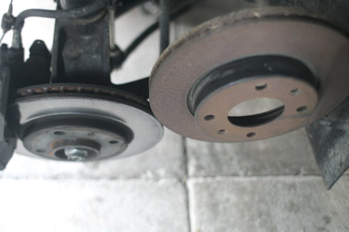

The Deep Offset Vented disk measures about 24mm from friction surface to top of wheel mating face, and is also shown next to the Low Offset Vented (on the car)
The Deep Offset Hub is easy to see with the centre circle cutouts and the deeper wheel mating face cup
