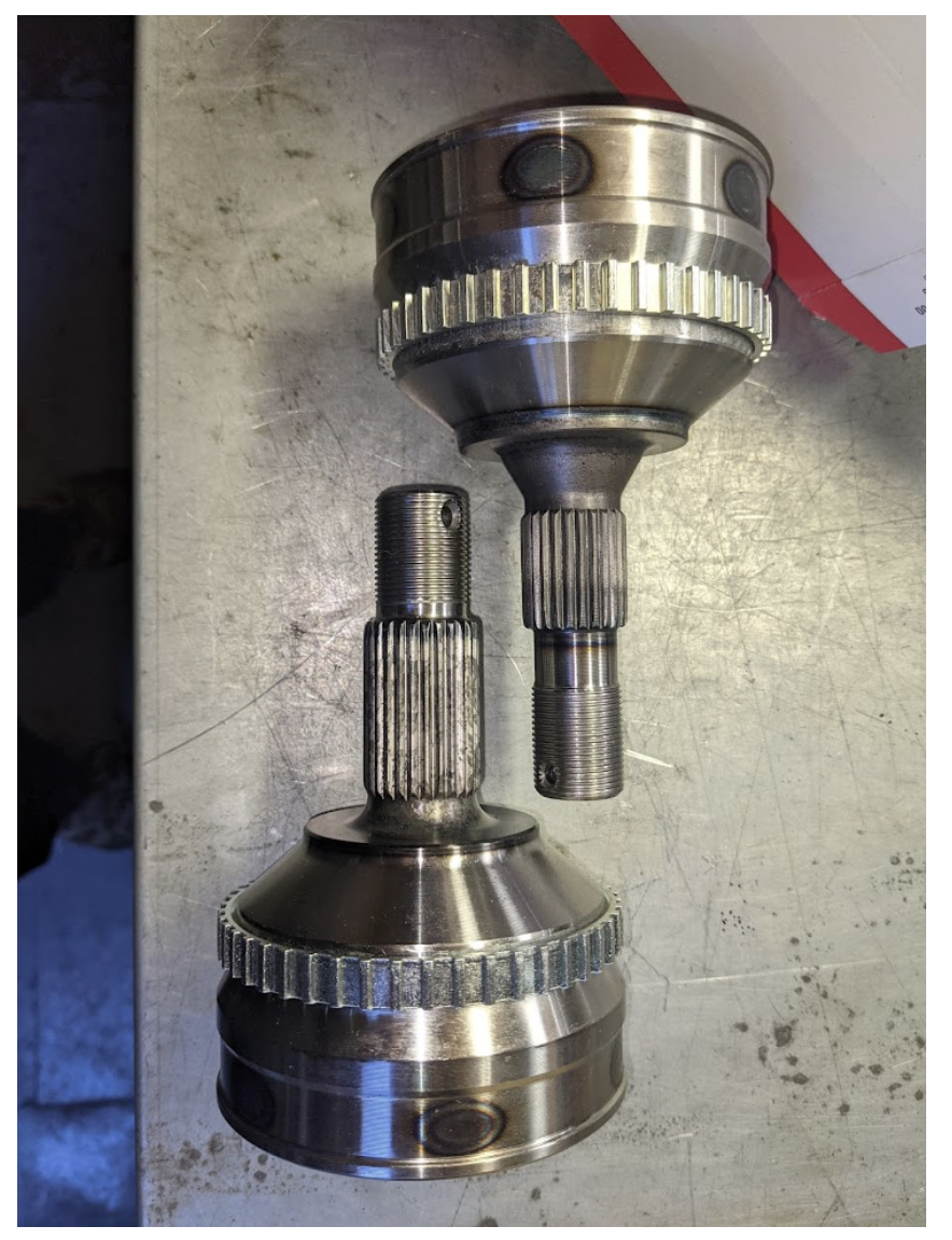

Hiya chap ;) added some pics for you...
fLgEMnLdsLPyJQGsEA06l5wN6ro8X3CUGlwQ2iPj4TAw8AjzXMxBXg7sAx28X8fN03hT9cIkyoORsqlg
wRB10Bk2waHYk_KWihTGPURFcTVy42hwDwqSCfTu
Left is Shaftec 405 CV, middle is a non-ABS cup I use just to make a rolling chassis, right is an ABS cup that's been brutalised by the angry grinder.

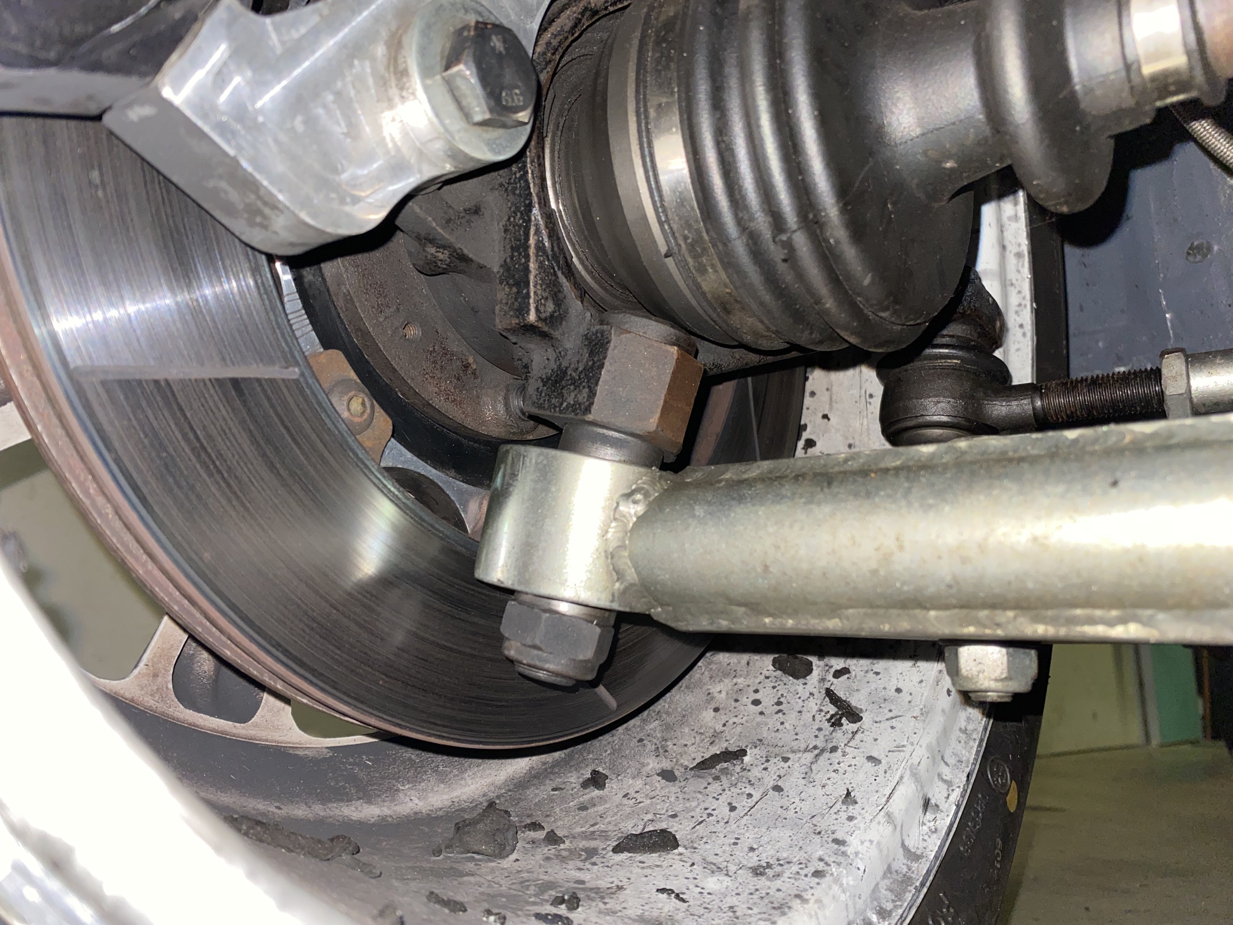

Best I could manage without taking a wheel off. You can see how I've turned it parallel to the head of the pin, with approx. 1mm of clearance.

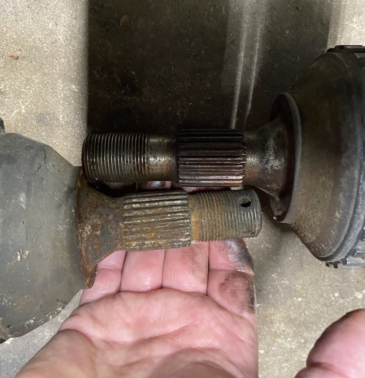

Just for my sake and zero ambiguity - are you saying 406 outers have a longer splined output stub, or are they identical to 405's so even with a spacer on the inside they still have plenty of output stub on them? I'm guessing 406 outers are the same as 405s right? Or no? Sorry, just checking!

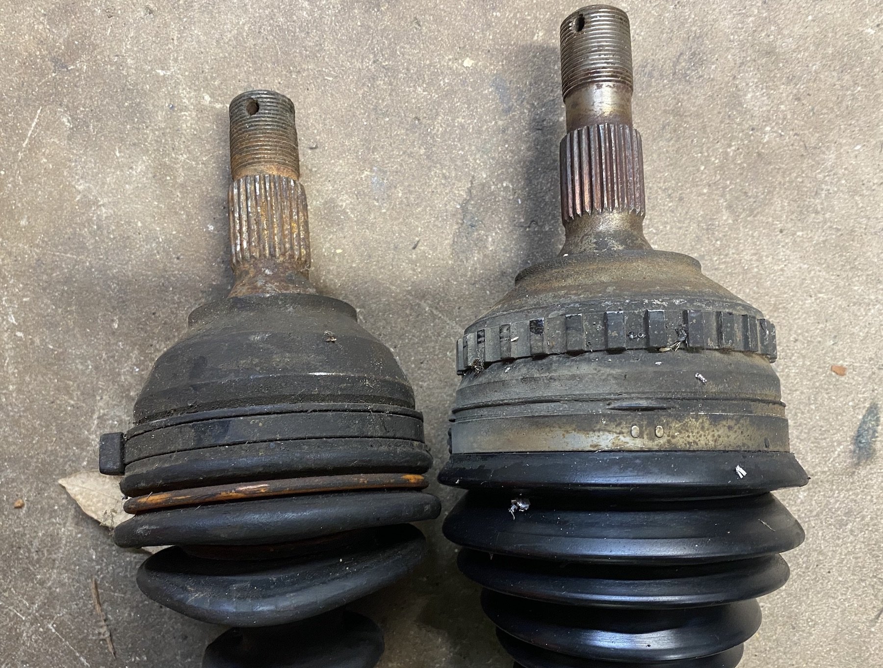

205/405 on the left, 406 on the right. The 406 CV is definitely bigger in diameter, not including the ABS ring. In the other pic, you can see why the 406 CV needs an 8mm spacer under the nut. I have no idea if they'll fit in my Group A hubs yet.

indeed 406 cv's are bigger o.d, same spline as 205/306, but longer stub as illustrated by peter.
