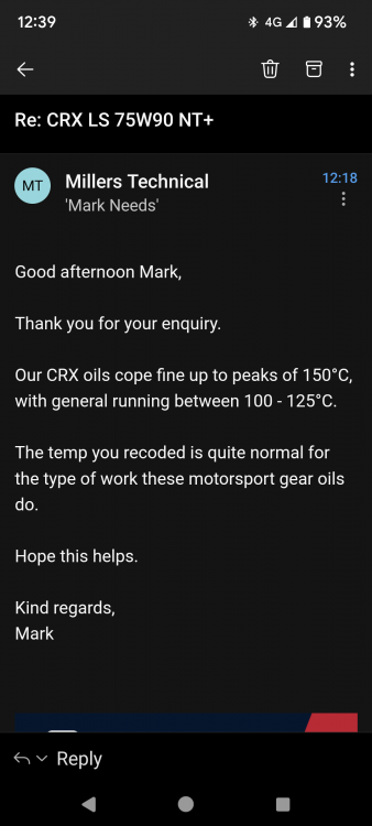

Had this email back off miller's about the oil I use, encouraging.
  • Like 2
