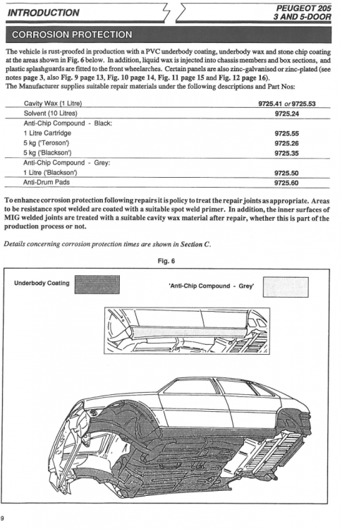

The henkel/teroson stuff I think is this stuff:
DanteICE
pugfrank
Thanks Geoff, are there more pages to this document? Its still confusing me to what I need to reapply to these areas to restore best protection.
Erm, nothing in terms of underside coating, there's stuff on dimension, what plastics were used for the bumper etc, and how some panels are precoated steal. Nothing that'd be useful to you for this job, I reckon.
Edited by DanteICE
pugfrank
Ok thanks Geoff.
