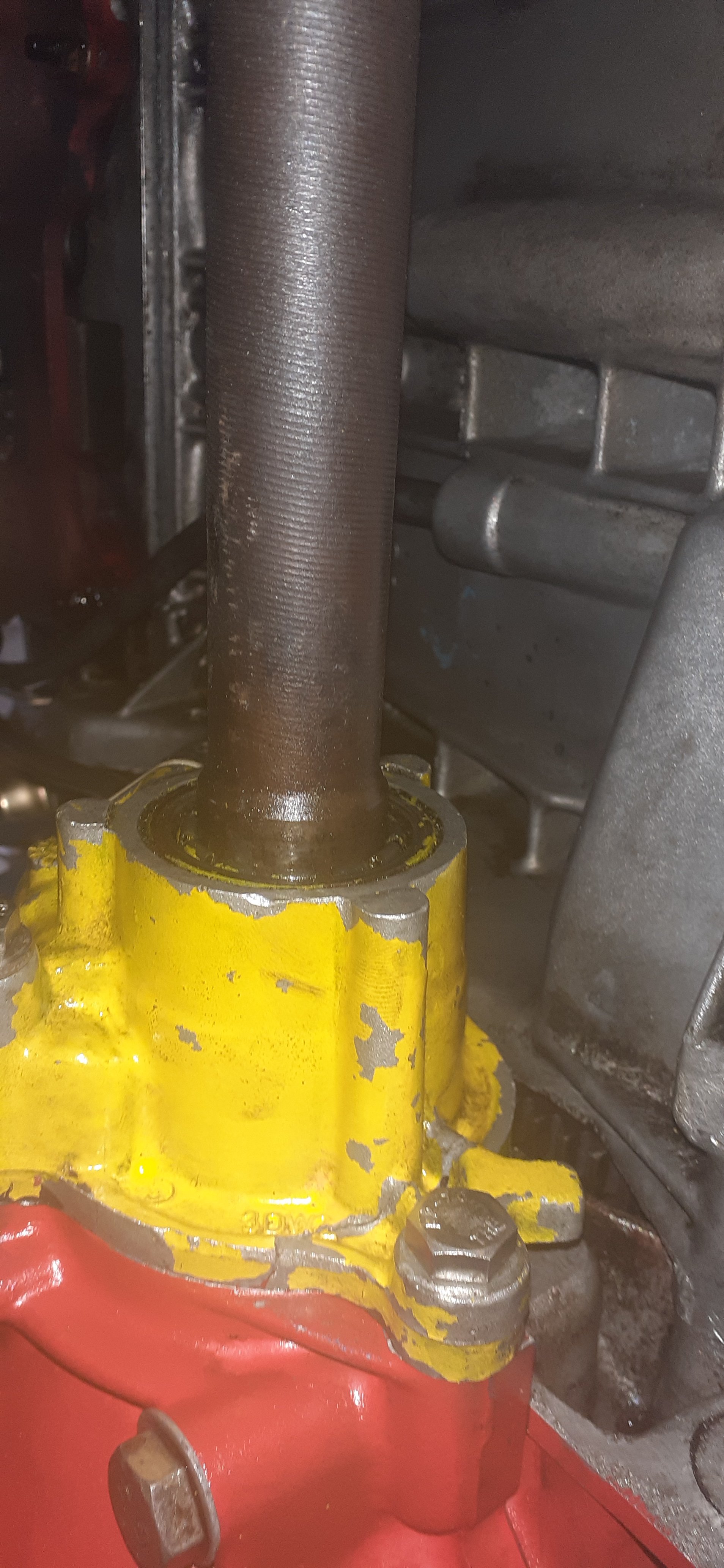

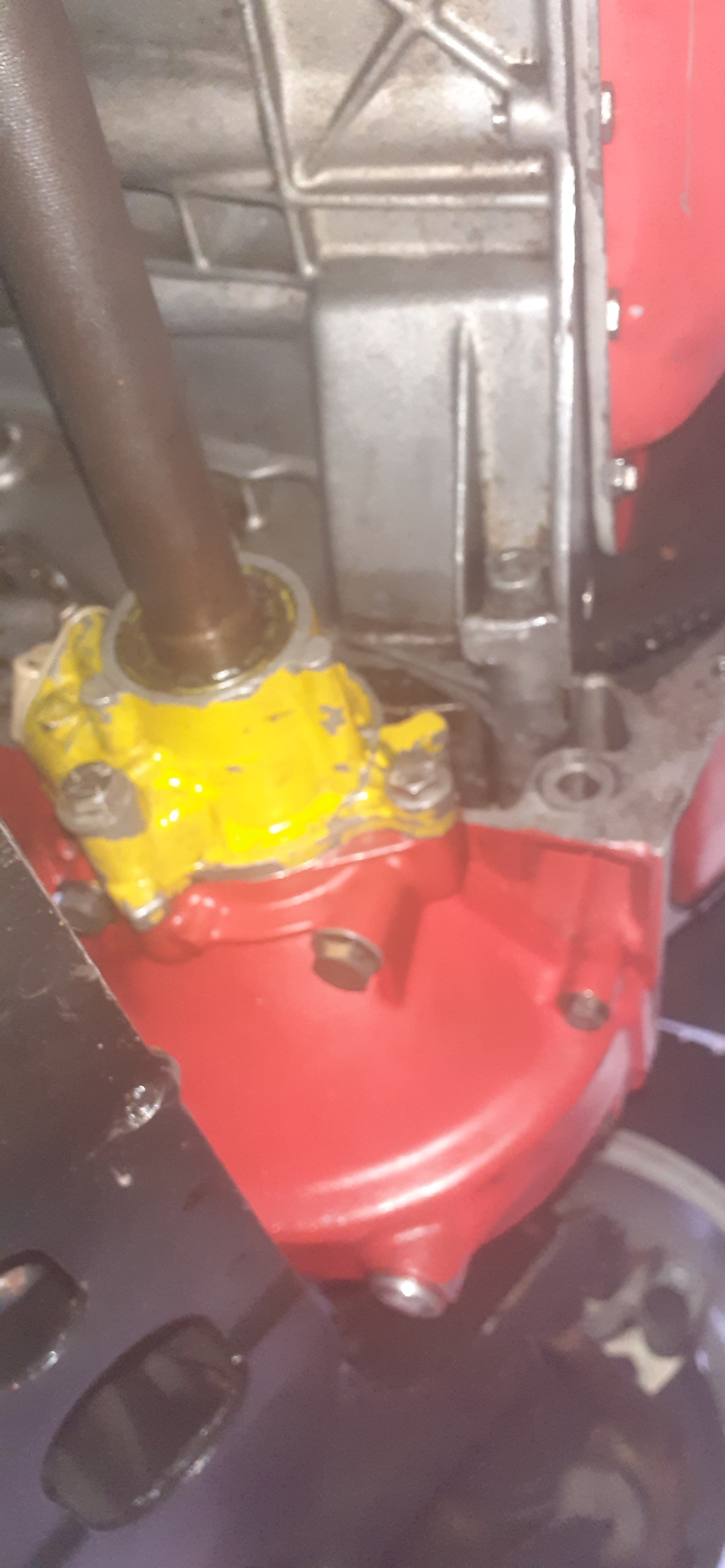

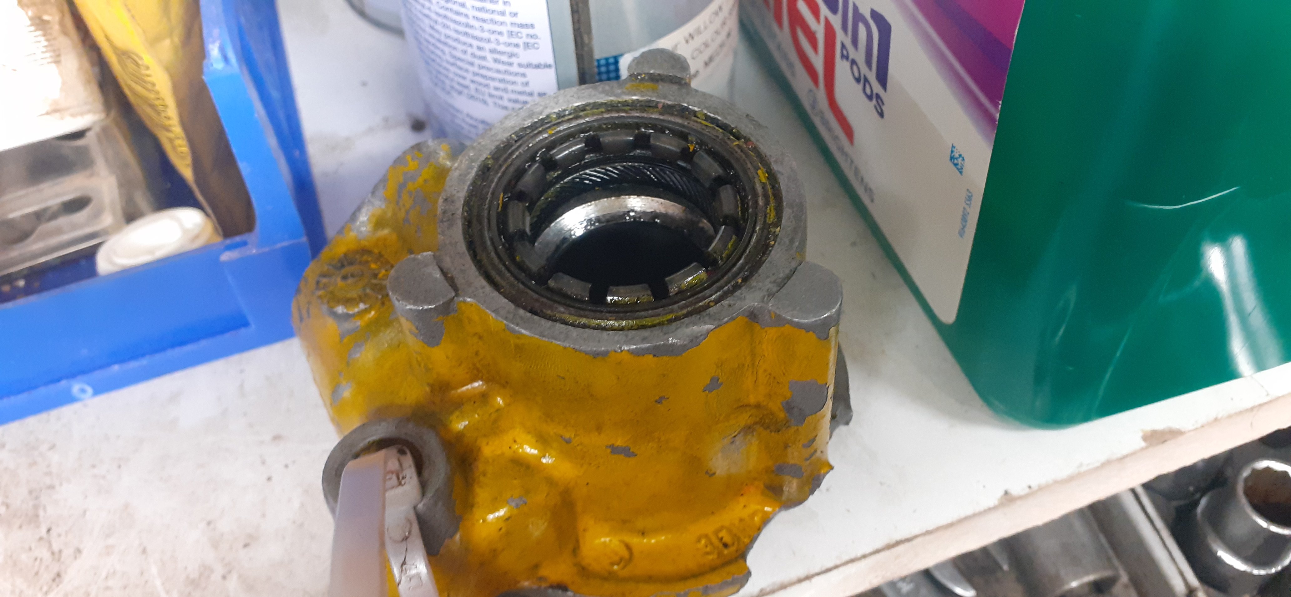

As part of removing the RHD drivers intermediate driveshaft I have noticed/taking this chance with it apart a problem with the speedo drive unit.
It doesn't seem to sit into the gearbox output position on the RHS - drivers side -offside UK

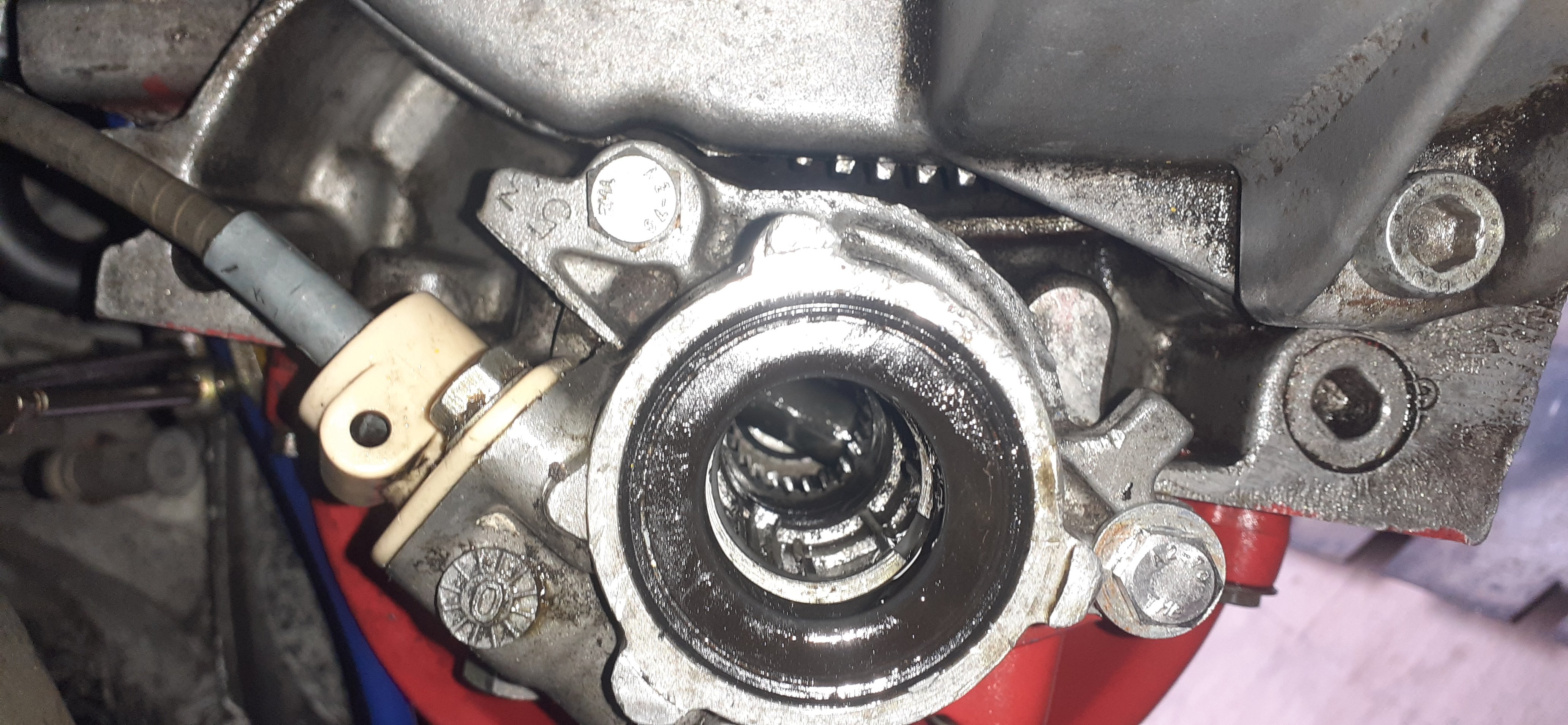

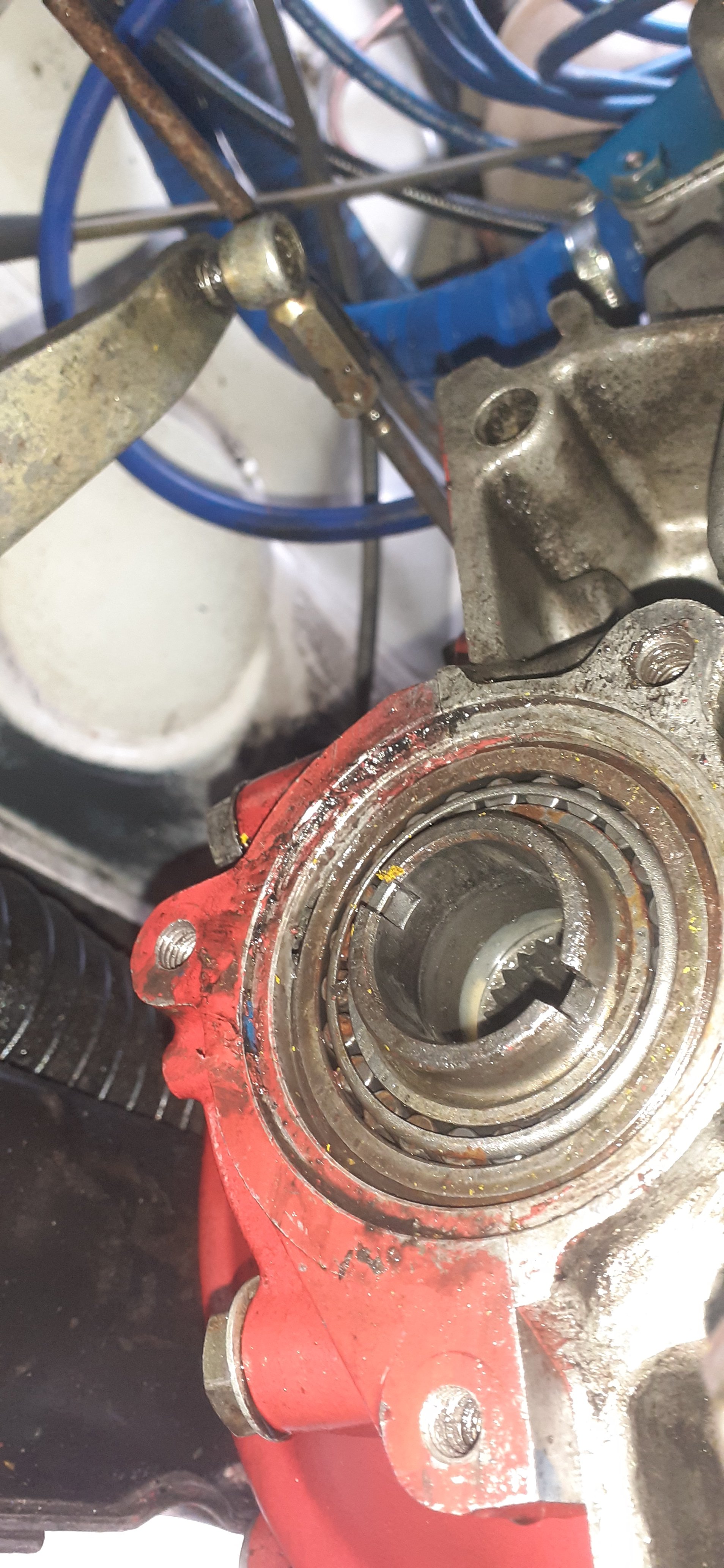

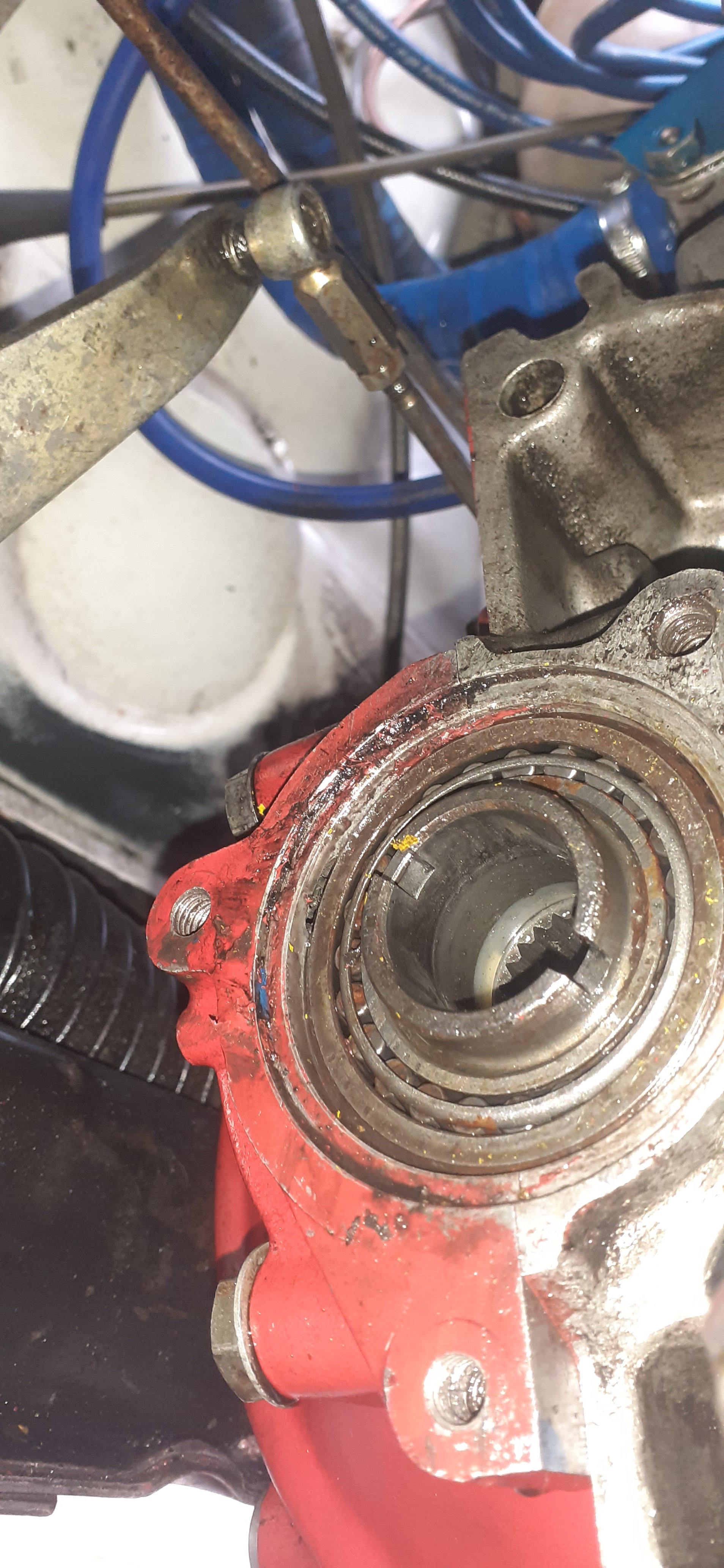

With it removed does the fitting position in the gearbox look normal? x2 pics

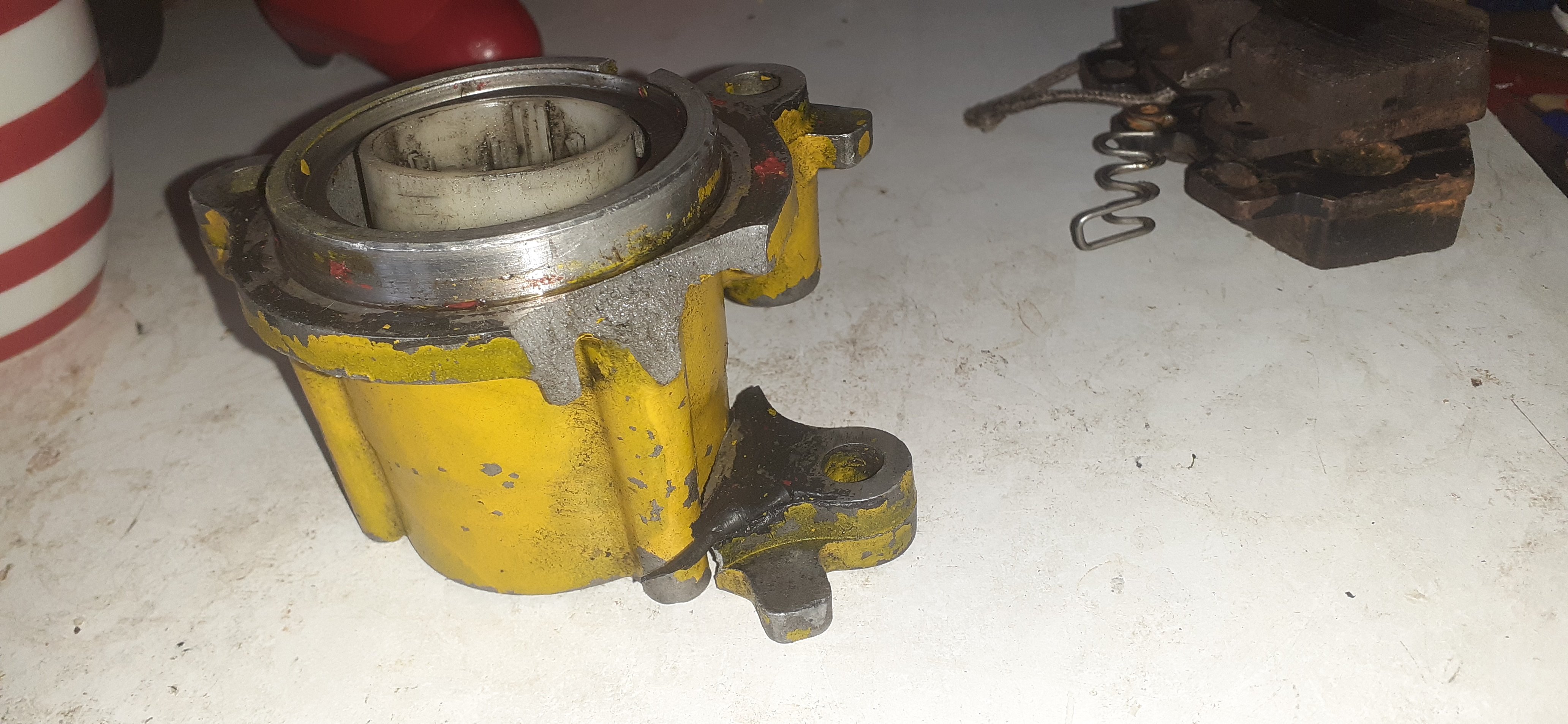

I also managed to accidentally drop it and break one fixing bolt hole - cursed several times - lesson learnt about not doing things
in a rush. Im praying that because this is not a load bearing component in shear - I can glue it and then just replace .....?
Will try that I guess - might be hard to get another one separately I guess unless buy a whole other gearbox.
Don't know why/cant remember why I took it off.
Looking now I could be missing an oil seal maybe, Ill check the parts cat. also now

Diff bearing is not in the right position came out too far , needs to be deeper inside , tap it back in then you'll be able to fit back the speedo .

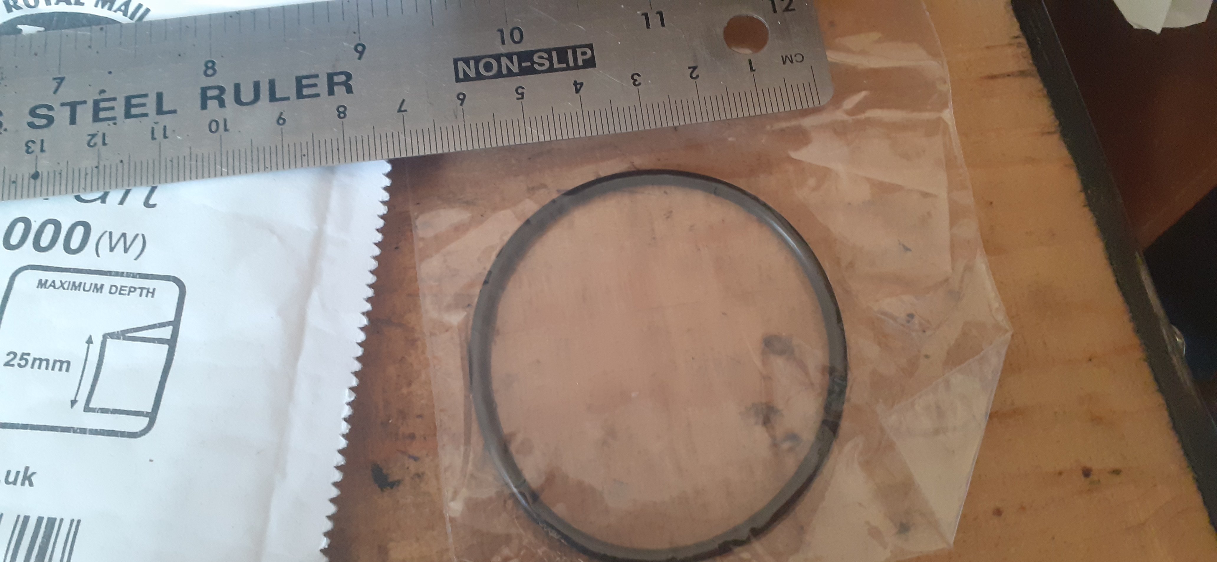

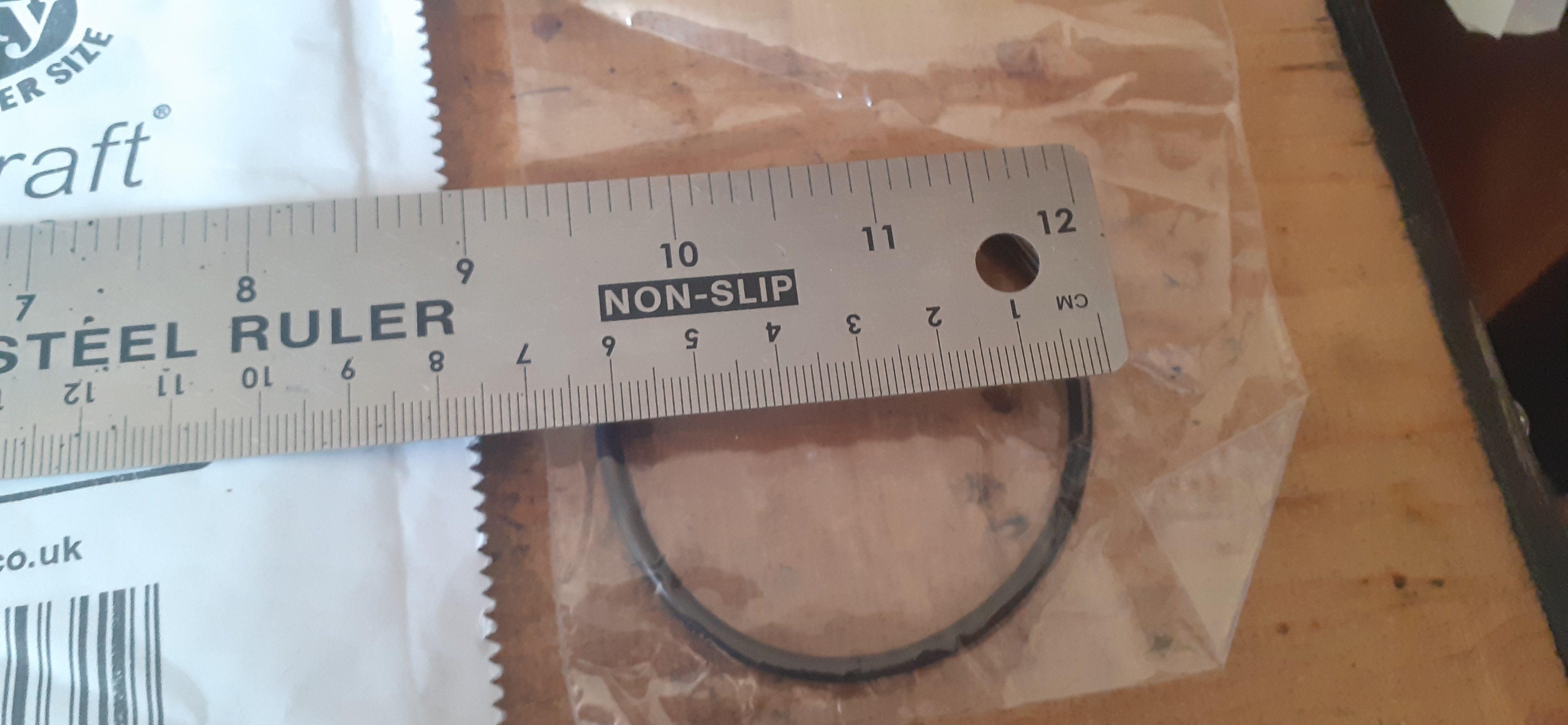

Bit unfortunate , you might get away with just the two bolts but odds are it might leak oil around broken area ... yes missing the O-ring as well :
http://www.miamistu.co.uk/pug/GB/205F/2/22D27A.HTM
... apply some RTV sealant over/around speedo groove and over the O-ring and then pop back on it might seal up and be ok. .. if not , will need new/second hand part as gluing that one won't work only TIG welding it back .

This part is also used to set the preload on the diff bearings, you can have the 10mm one or the 8.65mm one that uses shims.
It's unusual to find the one with shims but strangely it's listed as a spare part for both BE1 and BE3 gearboxes. For racing it is advised to use the short extension with shims and a bit more preload.

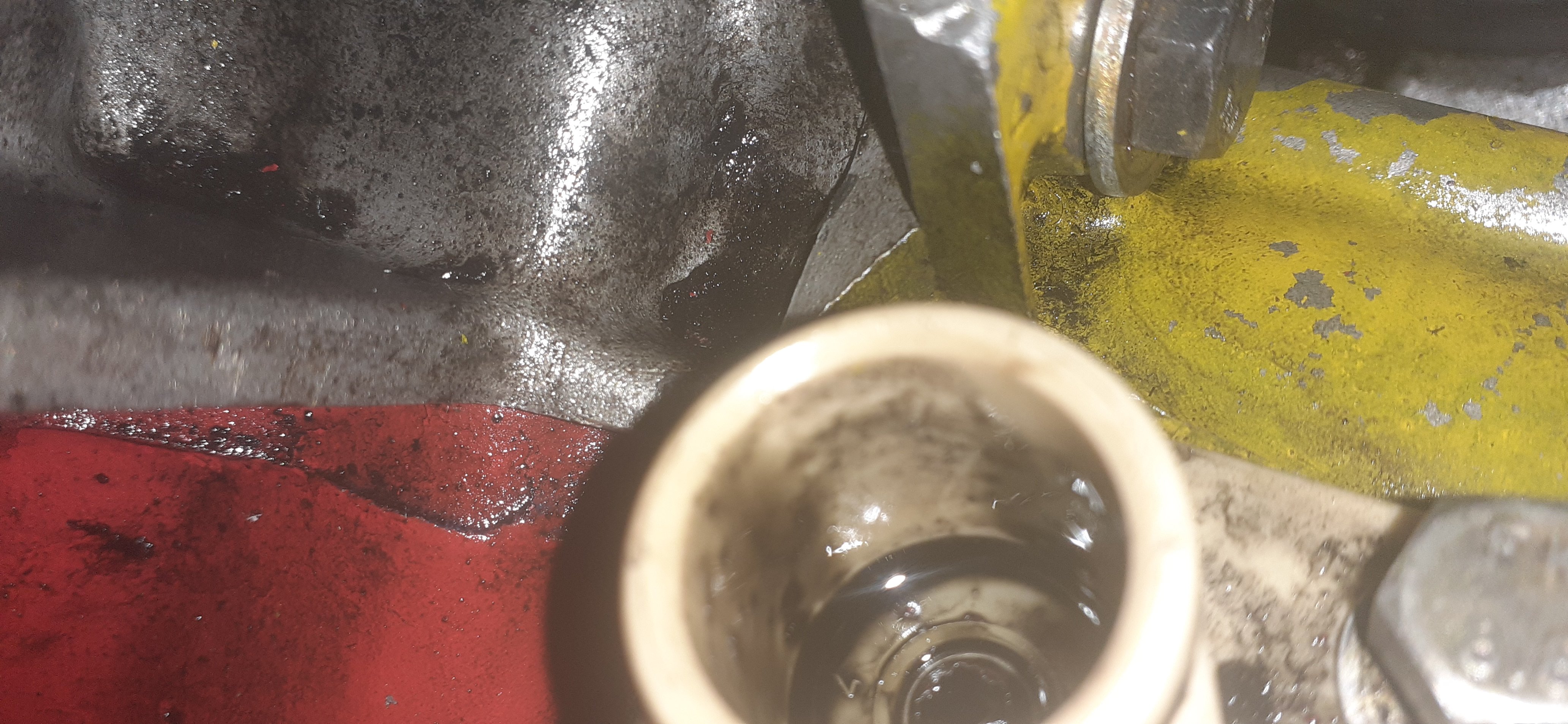

I managed to get the inner bearing pressed carefully back in thanks @DamirGTI
exactly as you said then the speedo drive went back -

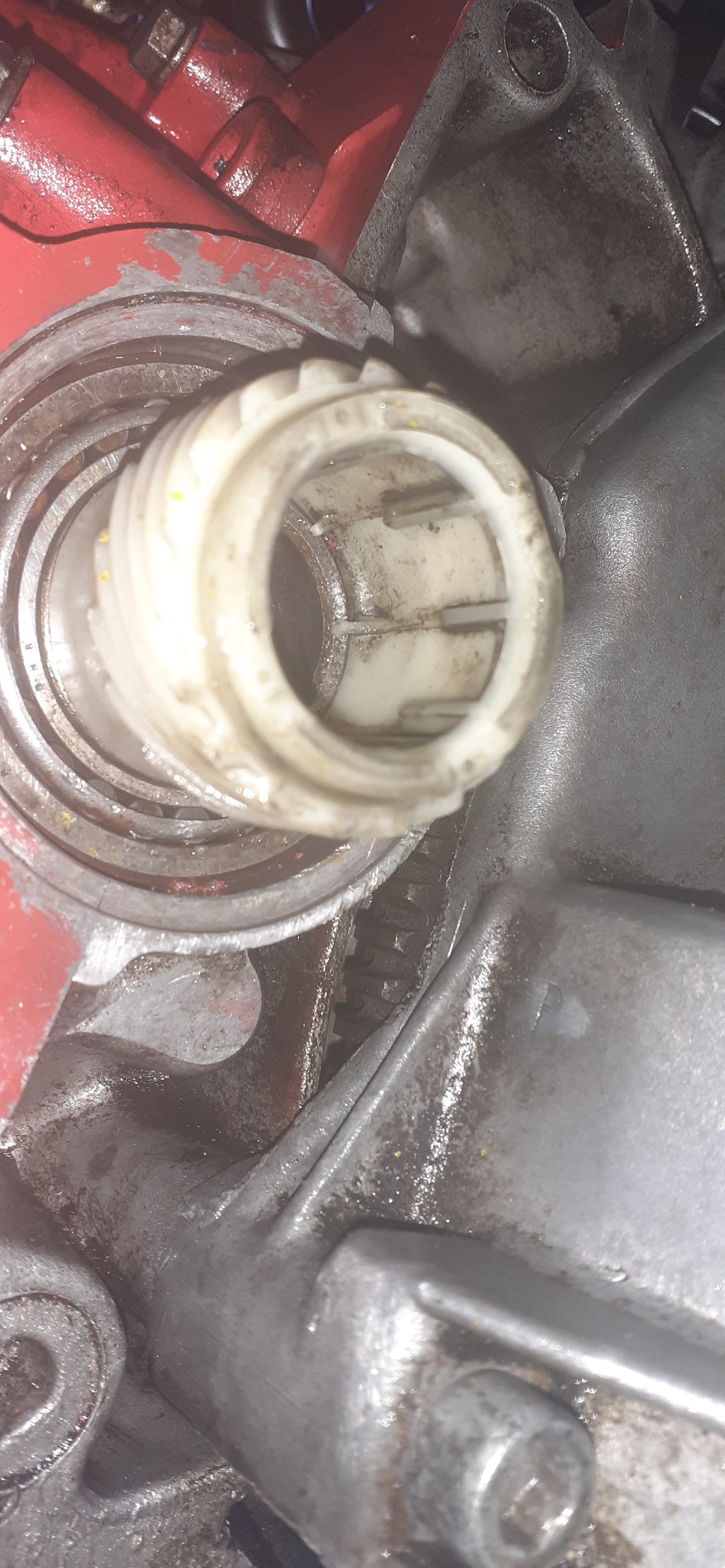

I also noticed that the white plastic drive fits into the bearing first
I haven't sealed it /not ordered the seal yet -
but it fits back lovely.
It seems to be tight all around now.
the broken bit even seems to fit relatively ok
thanks @SRDT
posting these pictures to update will look at this again tomorrow
but really pleased its looking so much better I thought it wouldn't go back at all.

You should be able to get a used replacement speedo drive housing easily enough, and for very little money. If it’s the type without a shim, then they are common as muck!
I would not run it with the broken one - it’s responsible for the diff bearing preload, so all three bolts are probably essential.

ok I will not run it with only two good bolts on this one  I ll start looking now and over the weekend.
I got the oil seal ring as pictured. I will check sits in there asap - it looks good

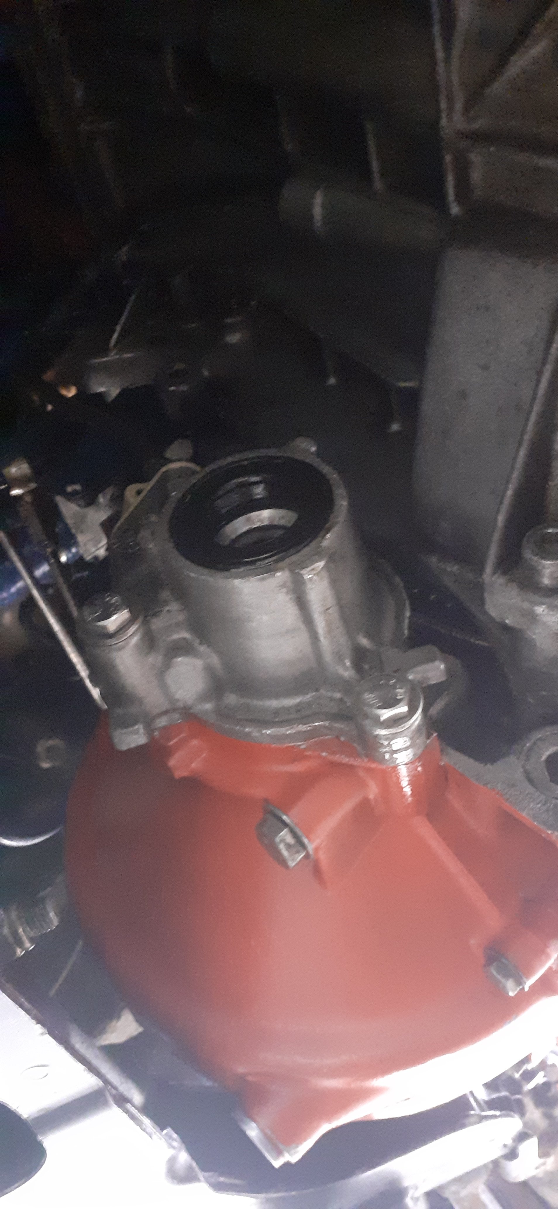

Richard309Sri XU5JA 205GTi
ok just catching up with this on Sunday

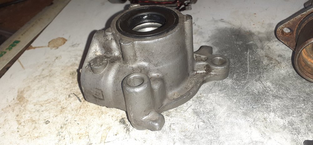

so I switched the speedo gear over. the plastic bits were not in the new housing .
I have installed the new oil seal and the drive unit -  as per photos.I cleaned it all and put some fresh oil
in and around before bolting it up.
couple questions........
i) what torque should the bolts be? maybe in the haynes or the french RTA I can find the values
ii) I am just sorting out the intermediate bearing bushing support and need to install the driveshaft back but
can I refill the gearbox with oil now?will it leak without the driveshaft installed?
iii) on the old one was the rubber seal damaged on the outside?as they look different ?
