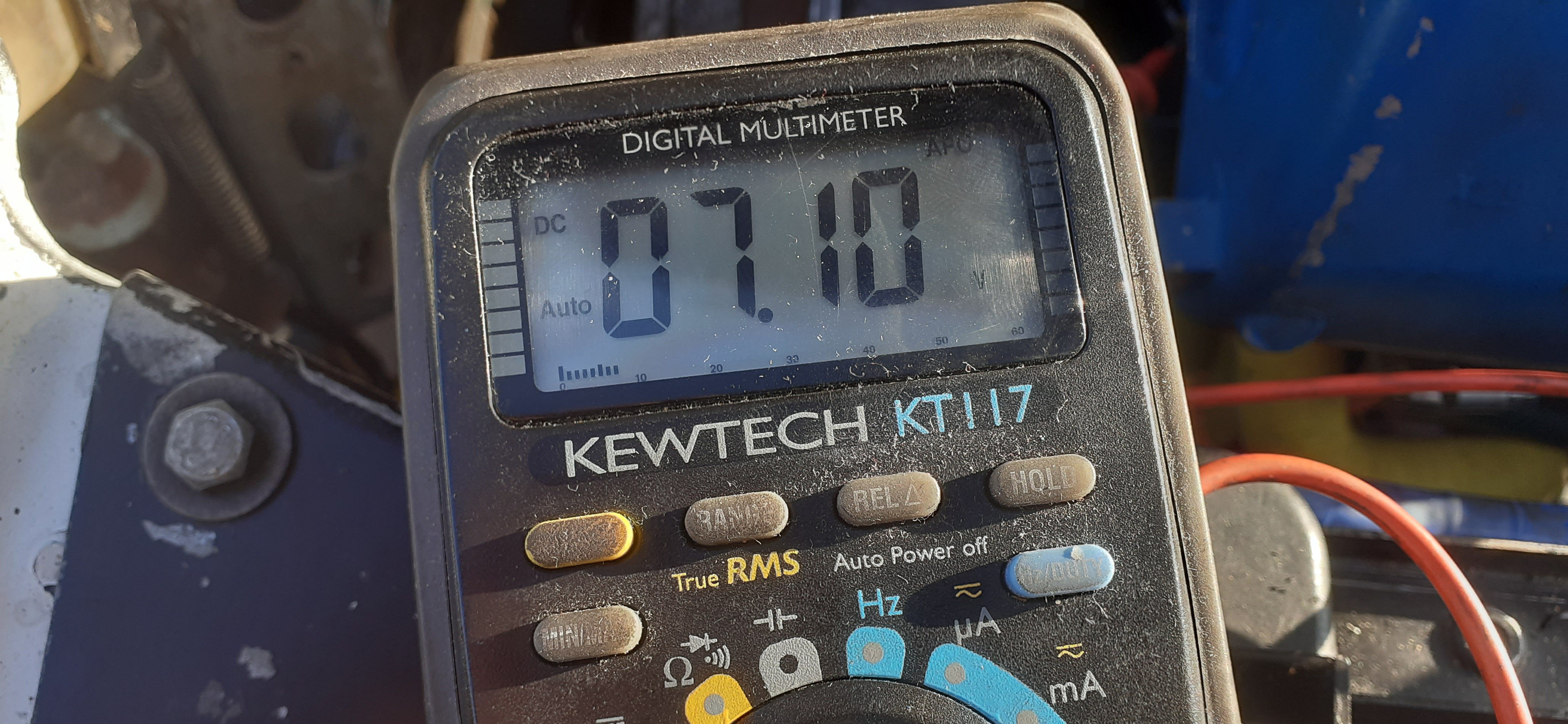

yeah the brown connector reads 7.10 V via multi-meter to earth** - photo 1

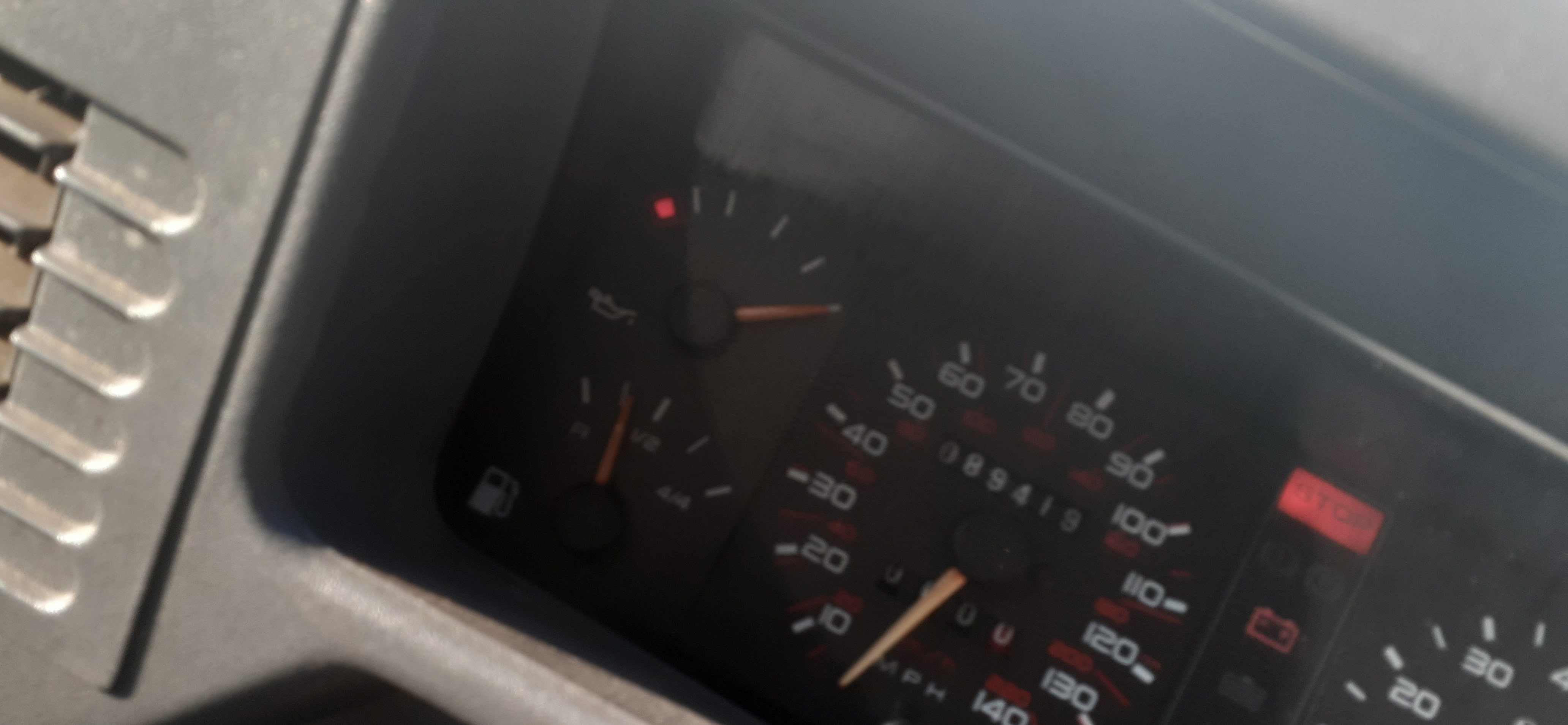

gives the needle not moving but light on on the dash

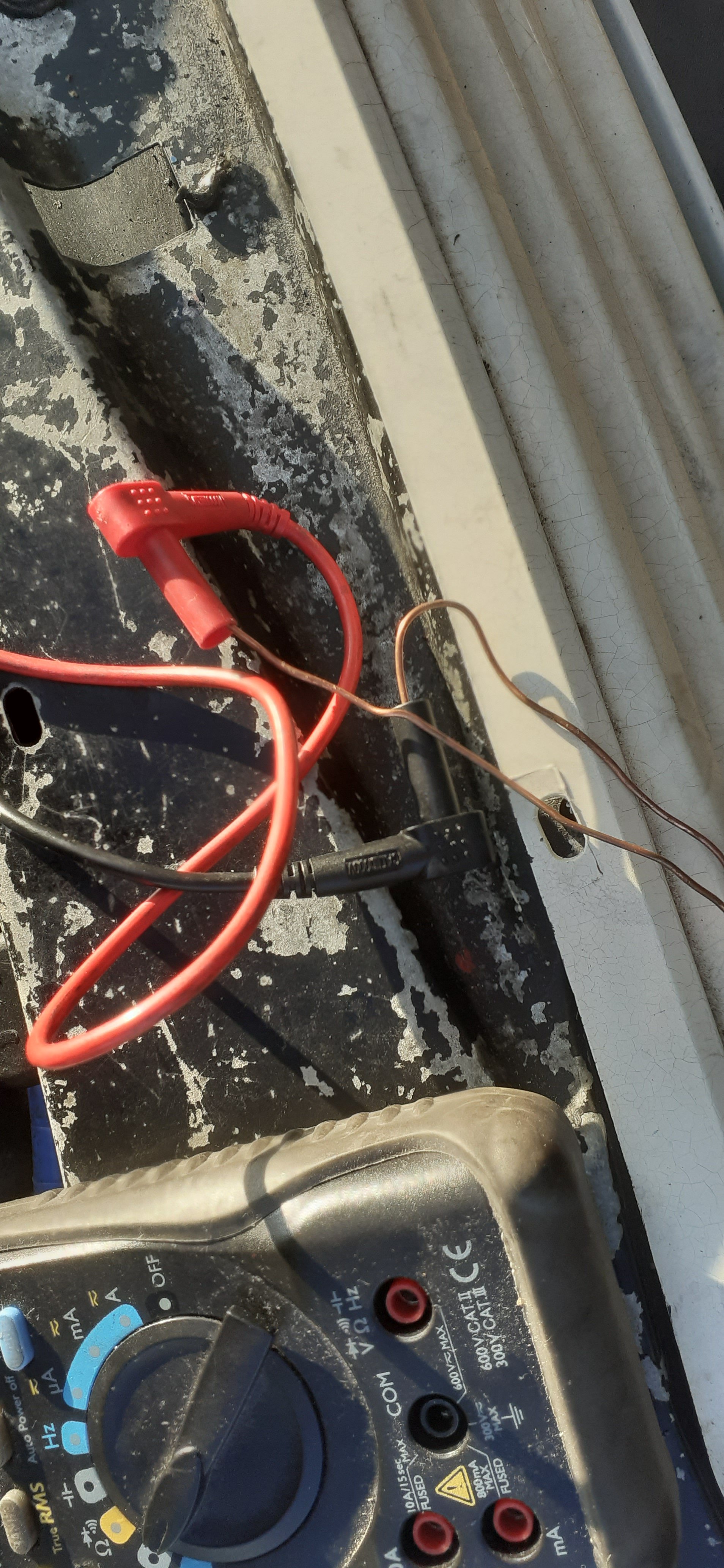

when I ground connect the probes in the same position photo 3  -

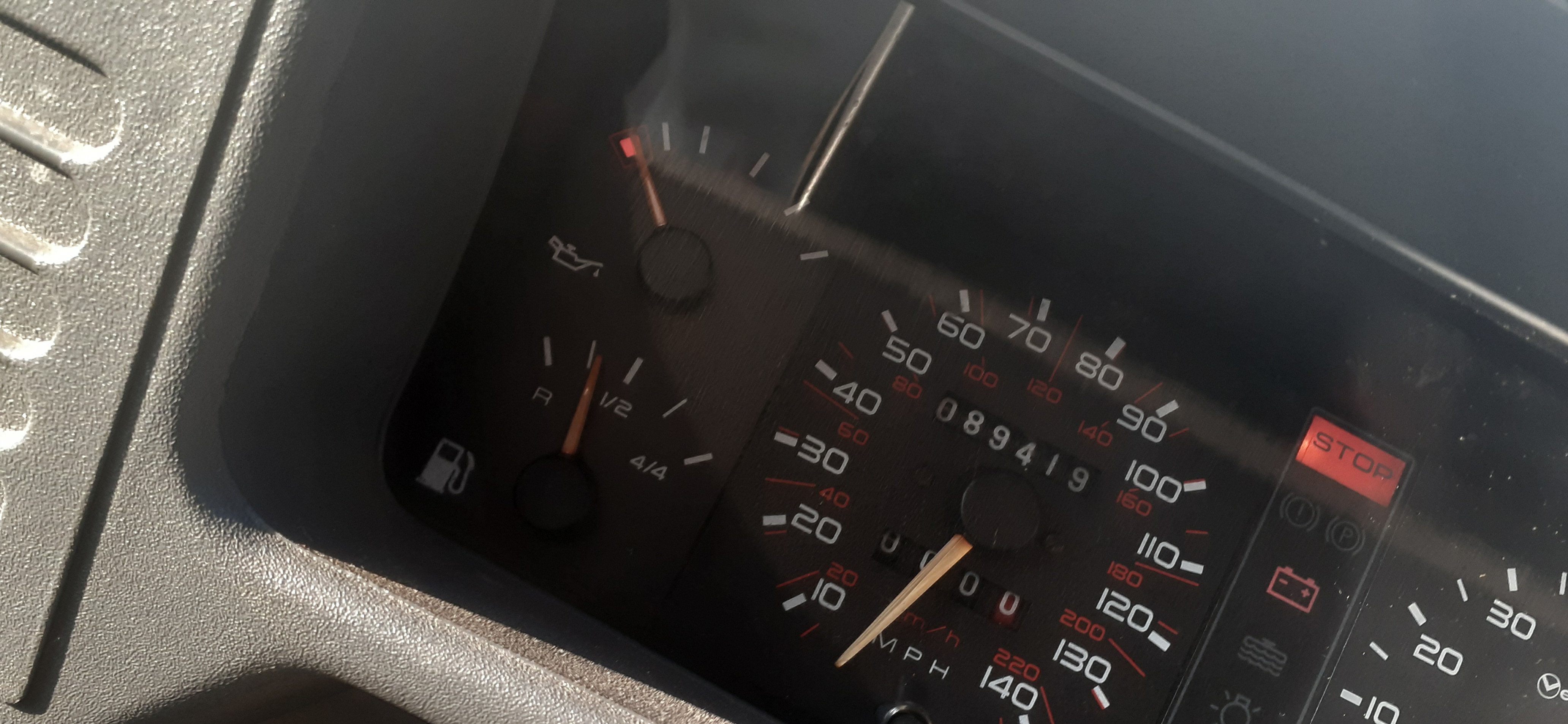

-so the connector is grounded - the needle moves to absolute max- photo 4.
the red light seems to on all the time
**I just connected the red lead of the meter to the brown connector and the black to battery -ve
