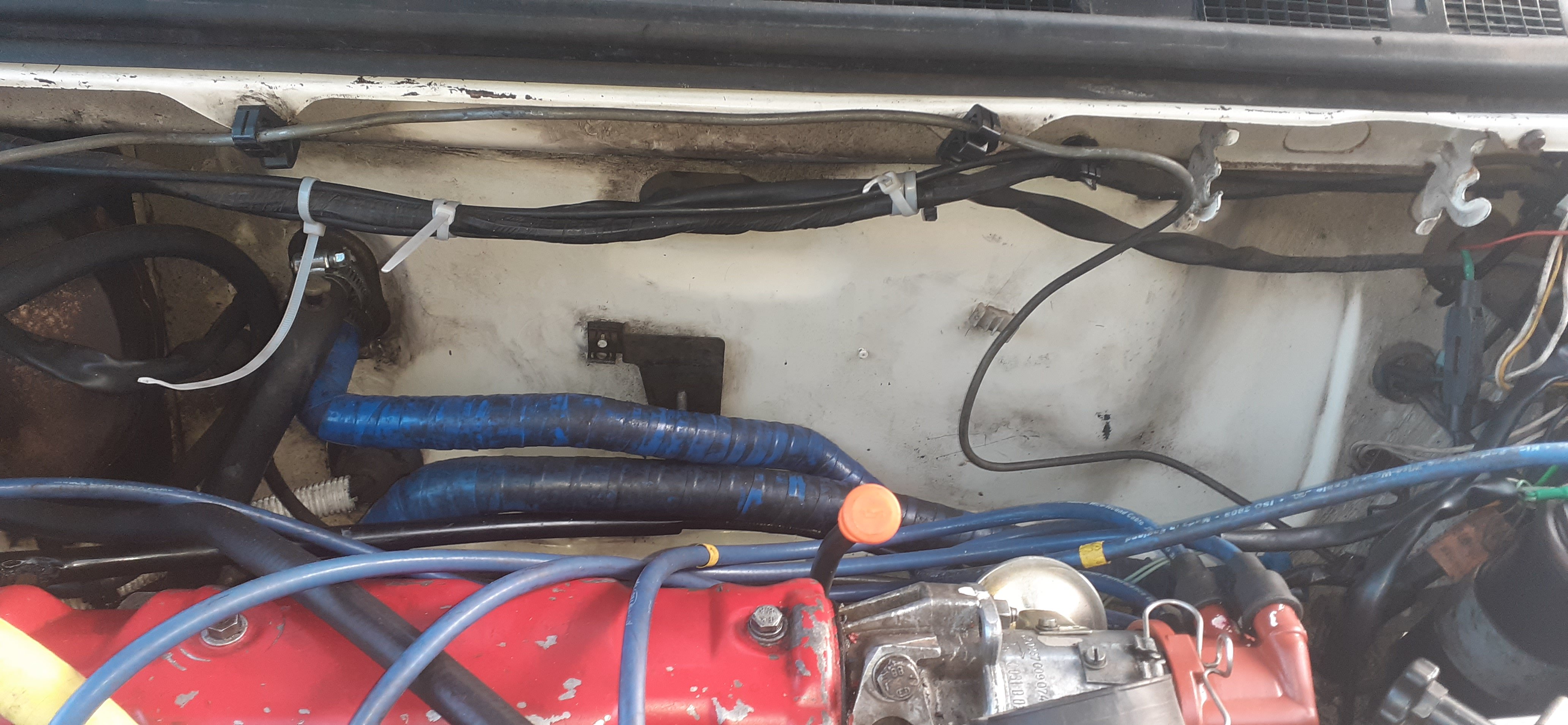

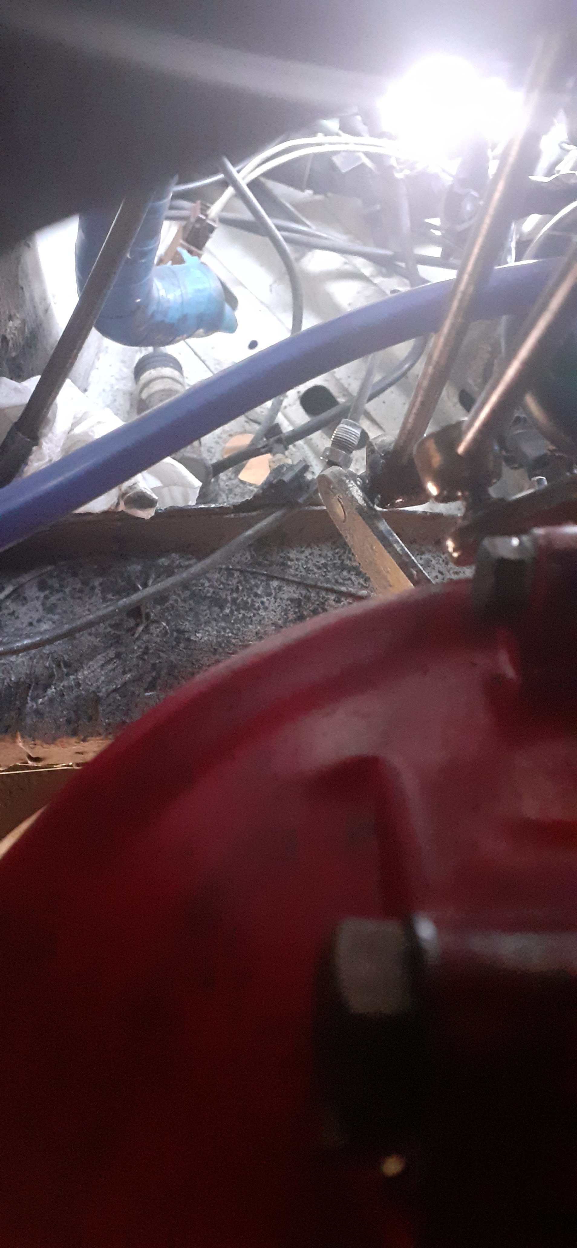

1. what angle the brake line limiter in the 309 should be? ref pic #1
I believe it is similar set up to the 205 1.6 GTi with drum brakes rear.  I also have drum brakes rear. I also have the rear brakes served from one rear port of the 19mm bendix MC
I got good advice from people incl. Welshpug before about the 1.6 limiter.
mine is slightly different to the 1.6 205 but in a similar position in the engine bay
I attach photo  of where the rear brake line turns up into the engine bay. it look like the fixing clip would take
the line up at about 35 degree from horizontal?
I should I have taken a photo before I took the old one off but it was ages ago and done not well planned out due to engine failure.
I have got both an original and brand new limiter, one** which will fix into this line next.  I did not change the original line that goes up into the engine bay so that cant be wrong thank god and also that means that limiter can only go one way around
so that is great also I cant cock that up :)

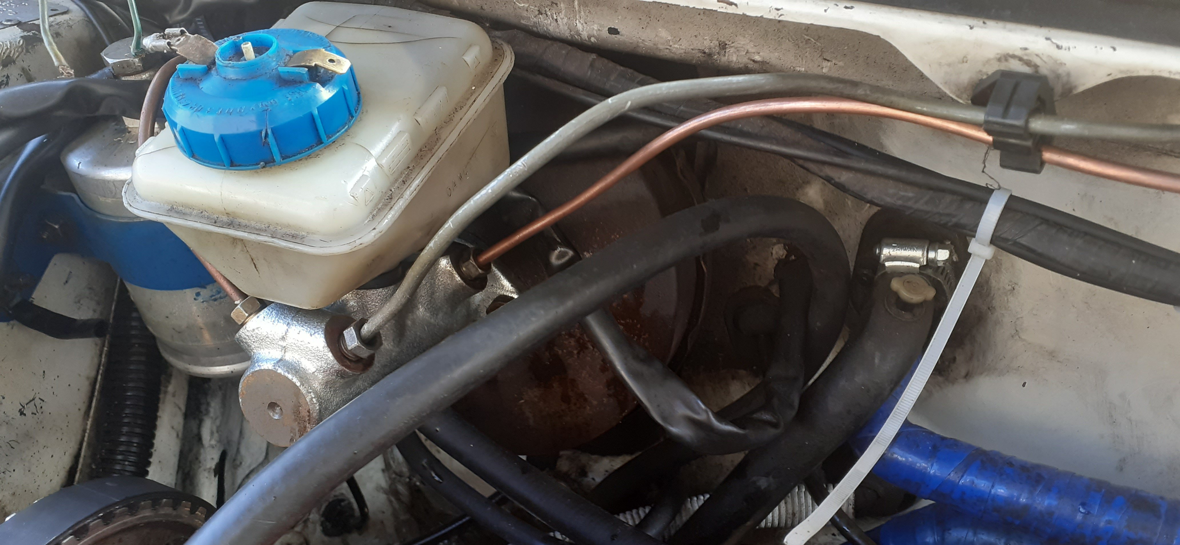

2. anyone know how long is the brake pipe that originally went from the master cylinder to the input of the limiter is?
The old one snapped and a piece is now missing.
I think it followed along the top of the bulk head - as per photo two ? it kinda bends around many times
there's a space in the fixing block for it. Its just how to bend it around and what angle the limiter is at
that will make the final length I guess. yeah parallel to the front right brake viewed from front.

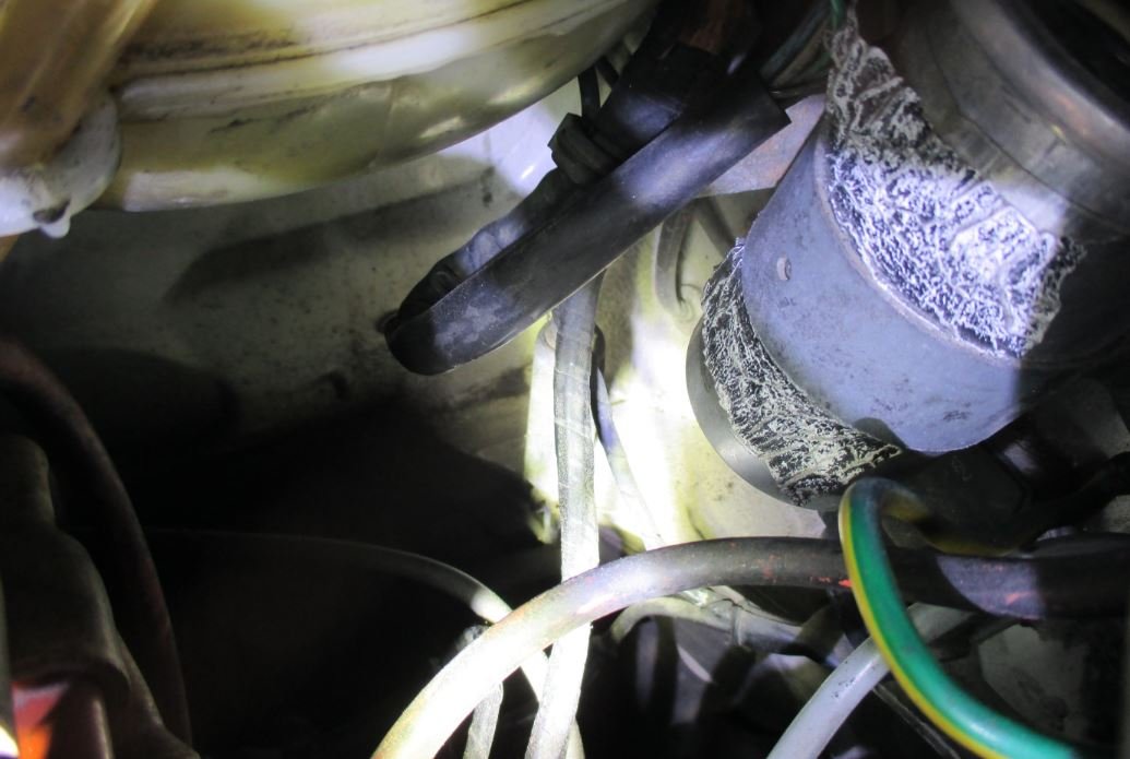

The limiter valve on my 309 SRi is fastened to the body seam by a clip at the outlet union. The seam runs from the battery area down to the bottom of the firewall.  The valve body sits nearly vertical but the top is slightly off to the left side of the car ( top slightly to the right when looking at it from the front). The top is also also tilted slightly backwards.
When looking at the image the valve looks much as it does to the naked eye. The ignition coil angle is distorted by the close-up lens.
I was under the impression that the limiter was laid at an angle and a ball moved up the ramp to shut the valve when braking forces acted on it. Now that I see its position I wonder if it works by hydraulic pressure. I cannot see how the ball would roll forward under braking with it mounted as mine is.
The limiter appears to be in an original position when I look at the piping.
I drive on a lot of gravel road and can lock up the front before the rear so I assume it is working although it has not been braked to that point on gravel since I reconditioned the rear drum brakes. Heavy braking on tarmac pulls the rear down nicely so they are working well with no lockup on a clean even surface.
Can wiser heads clarify the issue with the angle of the limiter?
I took a tape measure to let you know the pipe length from master cylinder to the limiter valve but that proved to be a lot harder than I hoped. To get an accurate length will require a more dedicated mission. I will do what I can as soon as I can get some time organised.

The limiter is behind the black bound wiring in the brightly lit zone if you are having trouble spotting it. There is not much space for a camera but the header tank, coil, and distributor cap locations should guide you to the body seam that the limiter is attached to. There might be a flat on the seam that the clip fits over.

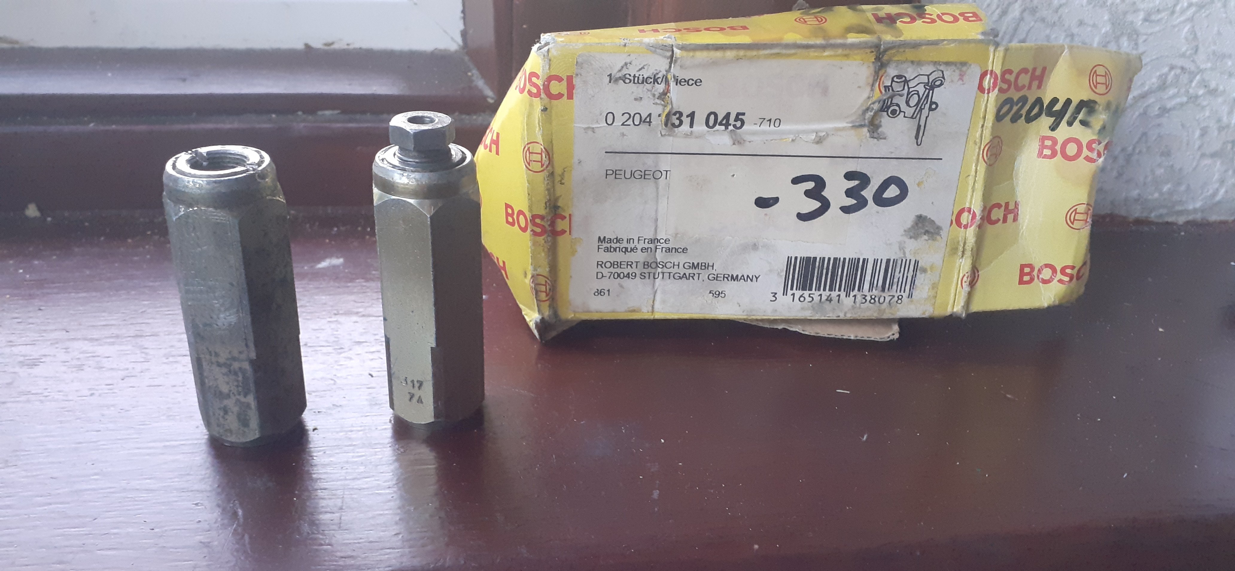

The 1.6 GTI limiter is bigger than the others.
I don't think the 309 had one of those ; just limiters that react to the pressure except for cars with ABR (ABS) and the GTI16.

1. I attach photo - photo 1 of my original one on the left and the new one I got and the new box it was in on the right. I thought my original one might be faulty so I got a new one just in case I could only source it from Spain
The bosch number I have bought as you can see in the photo is :- BOSCH 0 204 131 045
ok so what I need to do is now check that against the part number you have and check again using the parts cat. link as per welshpug bottom of every post.

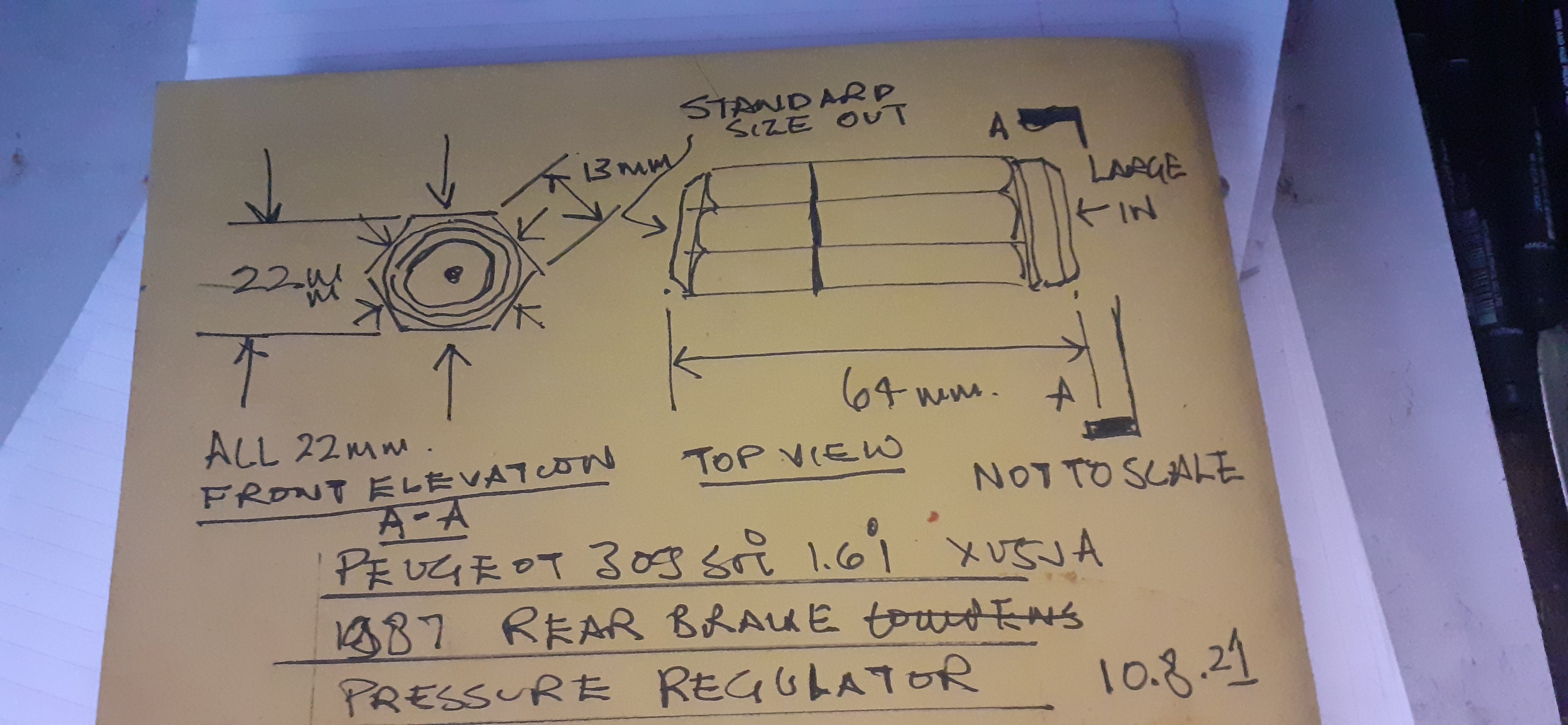

I just did a (poor) sketch of the dimensions - just for the record also photo 2
yeah looking at this again now it is not like the 205 gti 1.6 l one - the one welshpug sent me an ebay link to
so it very probably looking like this one is NOT an inertia one it doesnt like big as the 2051.6one at all
weird that I think I have seen ones like this on the 1.9 now but I wont go into that on this thread its getting too long

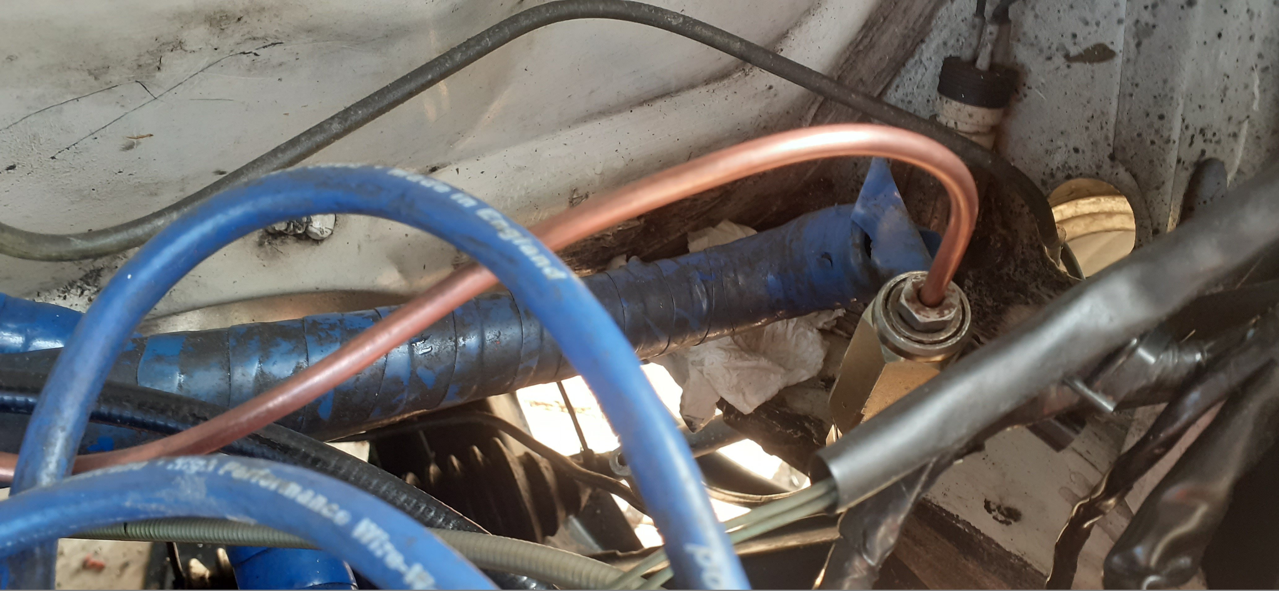

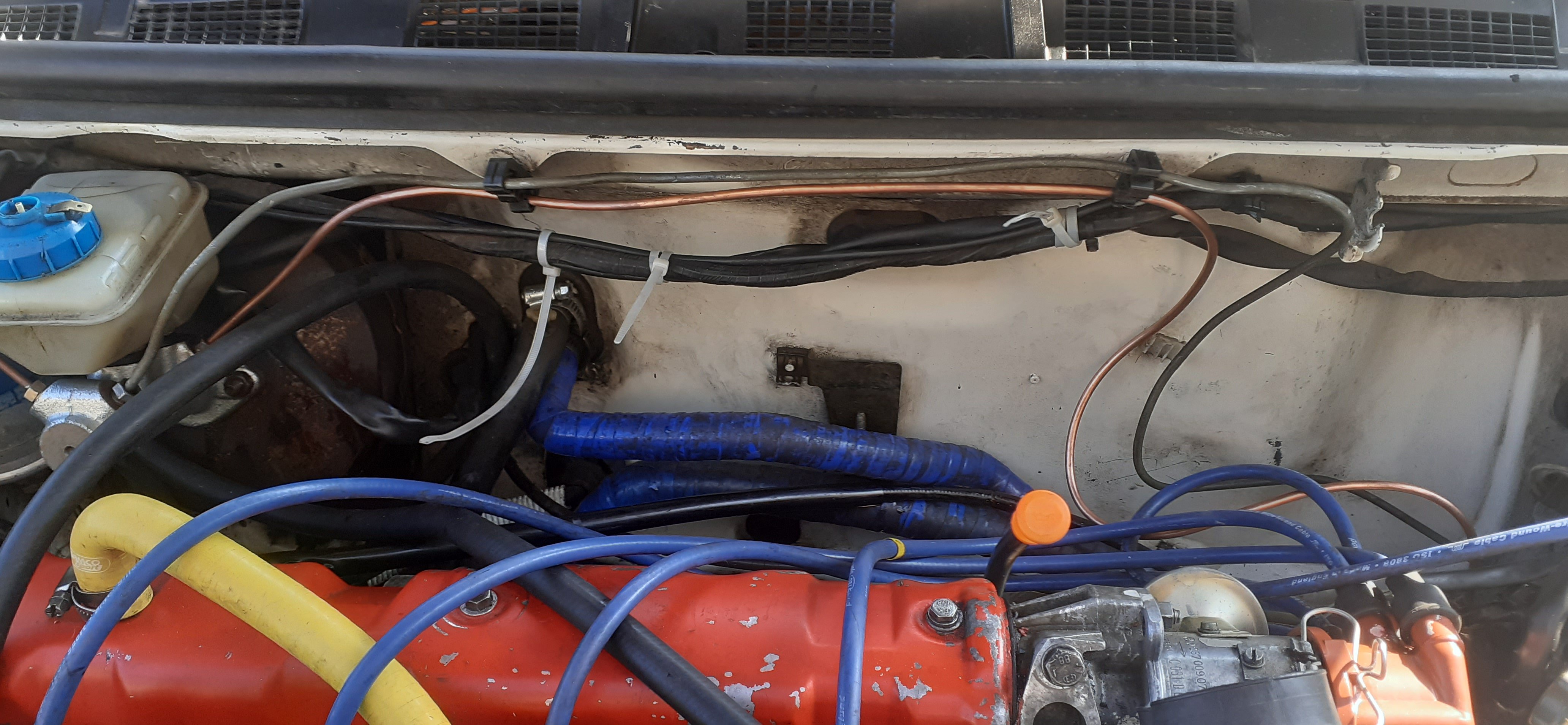

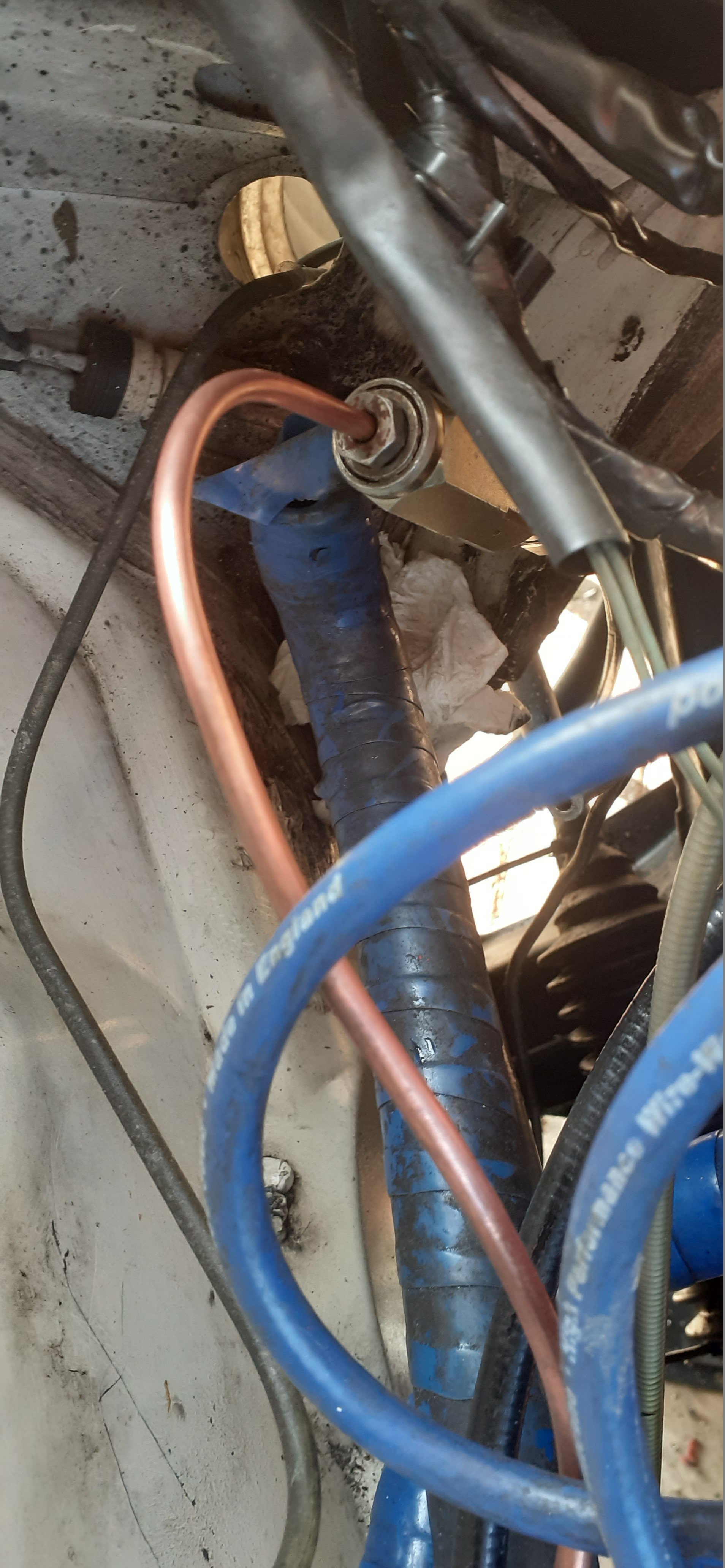

2. ok so I have set up that section of brake line - I have had a crack - to copy yours @309SRiguy
I ended up cutting and flaring a length of 1050mm - this actually gives me a bit of "wiggle room" to change the angle of the limiter a bit - the copper is really great compared to the steel original.
@309SRiguy thanks about measuring your one I can alter this one if I am badly wrong for sure.
Im still testing the output so I havent hooked up the rear line and brakes yer
I attach photos - I think its looking fair -having tech issues will do another post with other three  photos 1 for starters I will also take another one from under neath so it shows the angle better
I have done some testing also new one I got and old one - will do another post for more help        (sorry I cant get his pic horizontal Ill try again underneath)
