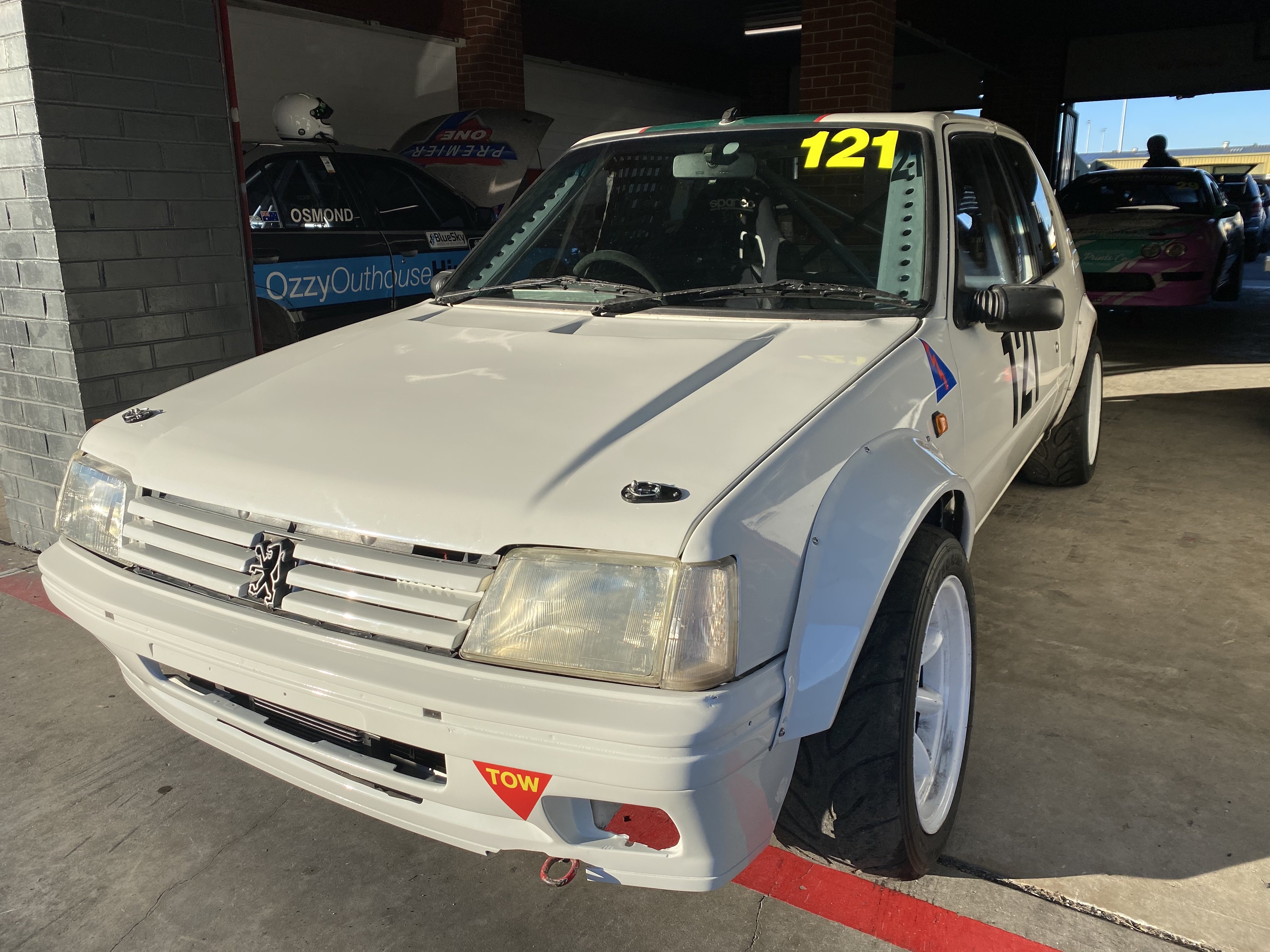

petert 607 Posted August 24, 2021 A pic for your reference. 1 Share this post Link to post Share on other sites

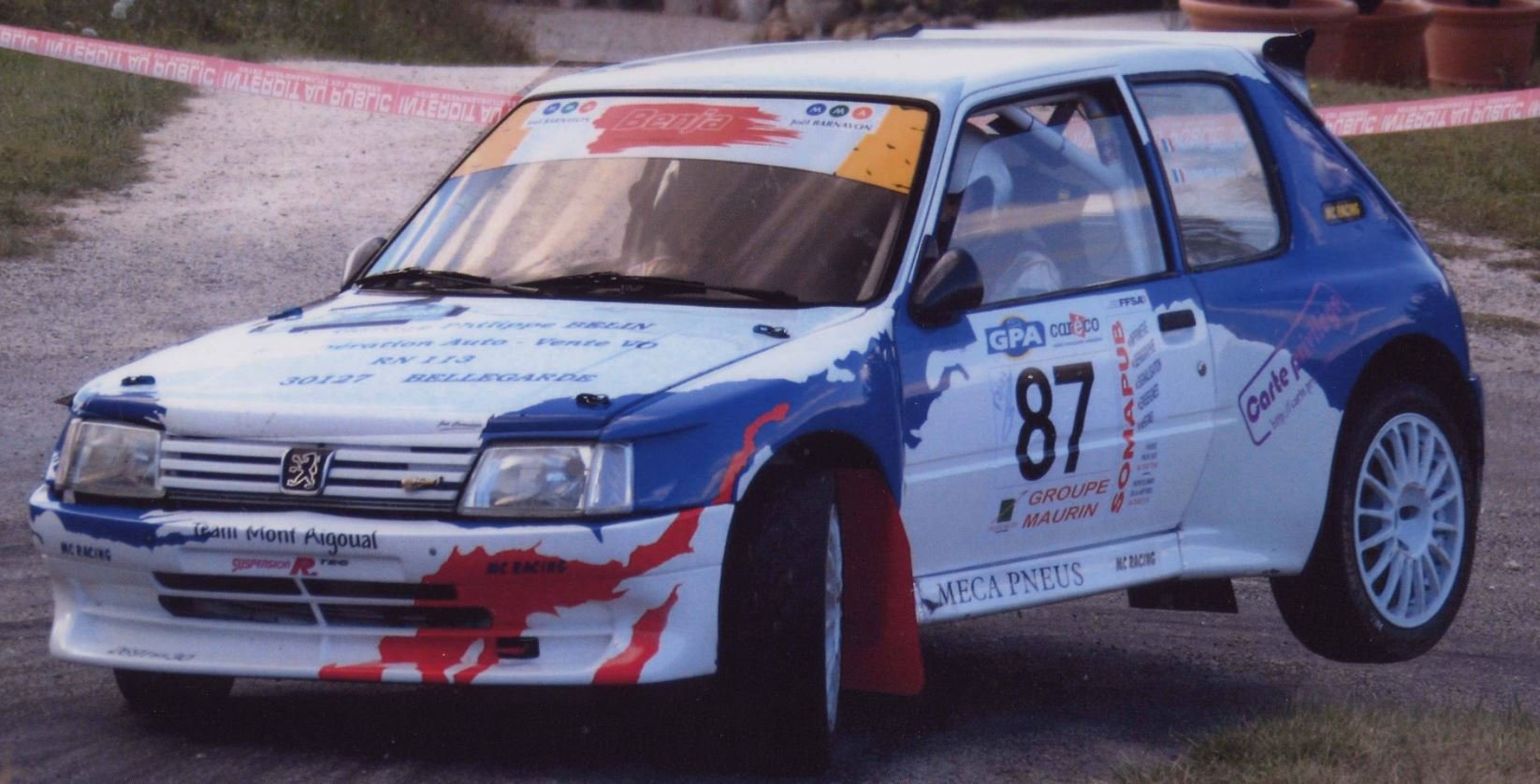

SeasidePete 2 1 Cars Posted August 24, 2021 She's a beaute! I mean this distance between the inside face of each hub. But I suppose what im trying to workout is the width of your driveshafts. I can compare to mine to work out if mine are wider than standard and therefore how much more width I need to add to get the wheels to fill the kit. With that said though im not sure we are talking about the same Maxi kit. Im ordering the full Maxi kit with new front and rear wings as apposed to just arches. This one: It doesn't look as wide as yours - not at the front anyway. Share this post Link to post Share on other sites

petert 607 Posted August 24, 2021 (edited) We’re definitely talking about the same kit. After crashing the car, I was going to buy a Maxi kit from Tony, instead of fixing it. I’d been in contact with Tony and thus I have the measurement. The pic is to illustrate the wider track. Edited August 24, 2021 by petert Share this post Link to post Share on other sites

petert 607 Posted August 25, 2021 It's too hard to get an accurate hub-hub measurement with brakes on etc. If you subtract 2 x (101.6 +4) from 1770, you get approx 1558mm. That's half the wheel width plus the negative offset. 15" is the right size wheel. Whether you run 7", 8" or 9" is up to you. Just get the offset correct. eg 7" +4 8" -4 9" -12 Share this post Link to post Share on other sites
