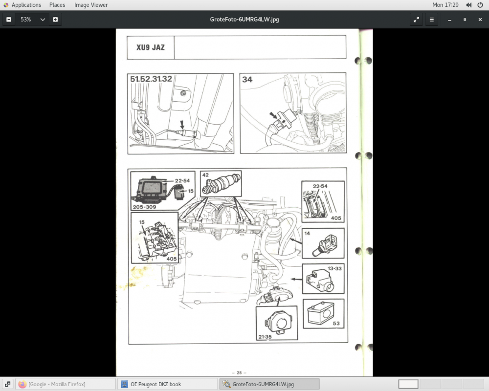

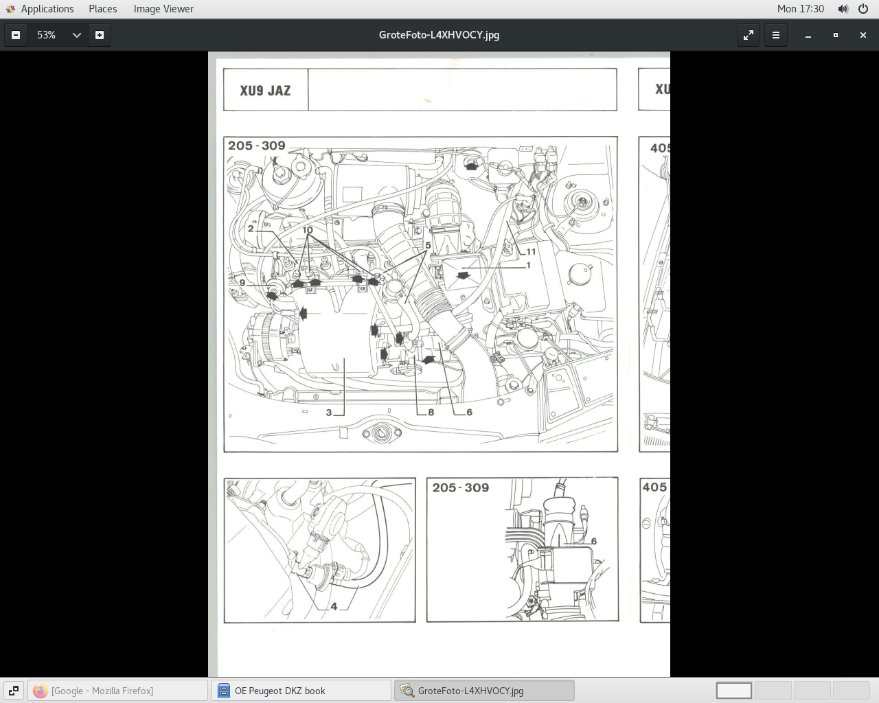

DamirGTI
Yes , it's connected to the inlet (it purges fuel vapors in the inlet manifold to be burned , mixing them with regular air/fuel mixture) , black valve golf ball size with one 2pin connector and two pipes/hoses on ... usually situated battery front , around/under throttle body area (No. 34 and 4 on the diagram) .
Check if all hoses are connected and hose clips tightened ..

Thanks for that. Is there a part number in the document you got the pictures from ?
DamirGTI
For the solenoid ? , if so it's : 1628 F0
