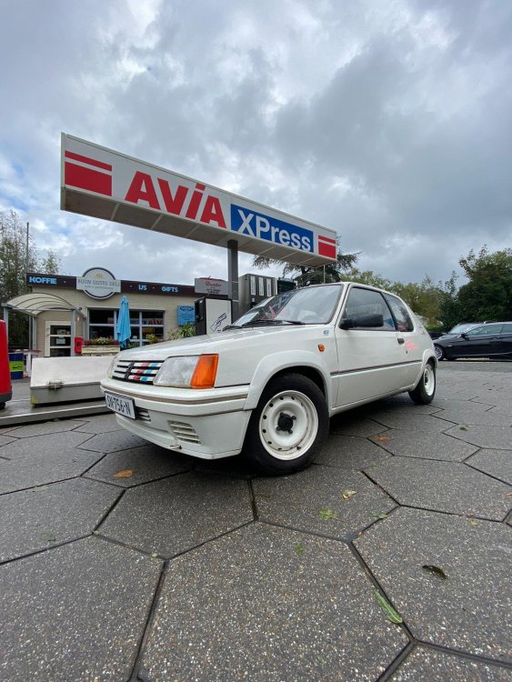

MVK 0 Posted July 2, 2021 Morning all, I've been asked by a friend who has a Euro Spec 205 Rallye to rebuild the engine this summer, as the oil pump apparently failed. Due to the engine being rather rare - and not sold in the UK - does someone have a maintenance manual/engine tolerance specs/torque values etc that I could have access to? Also, any hints or tips or common pitfuls for these engines. I have experience with the XU5 and the XU9 engines as i used to own a Mi16 that needed a lot of engine work. Picture is of the car for anyone interested. Thanks in advance! Matthew. Share this post Link to post Share on other sites
