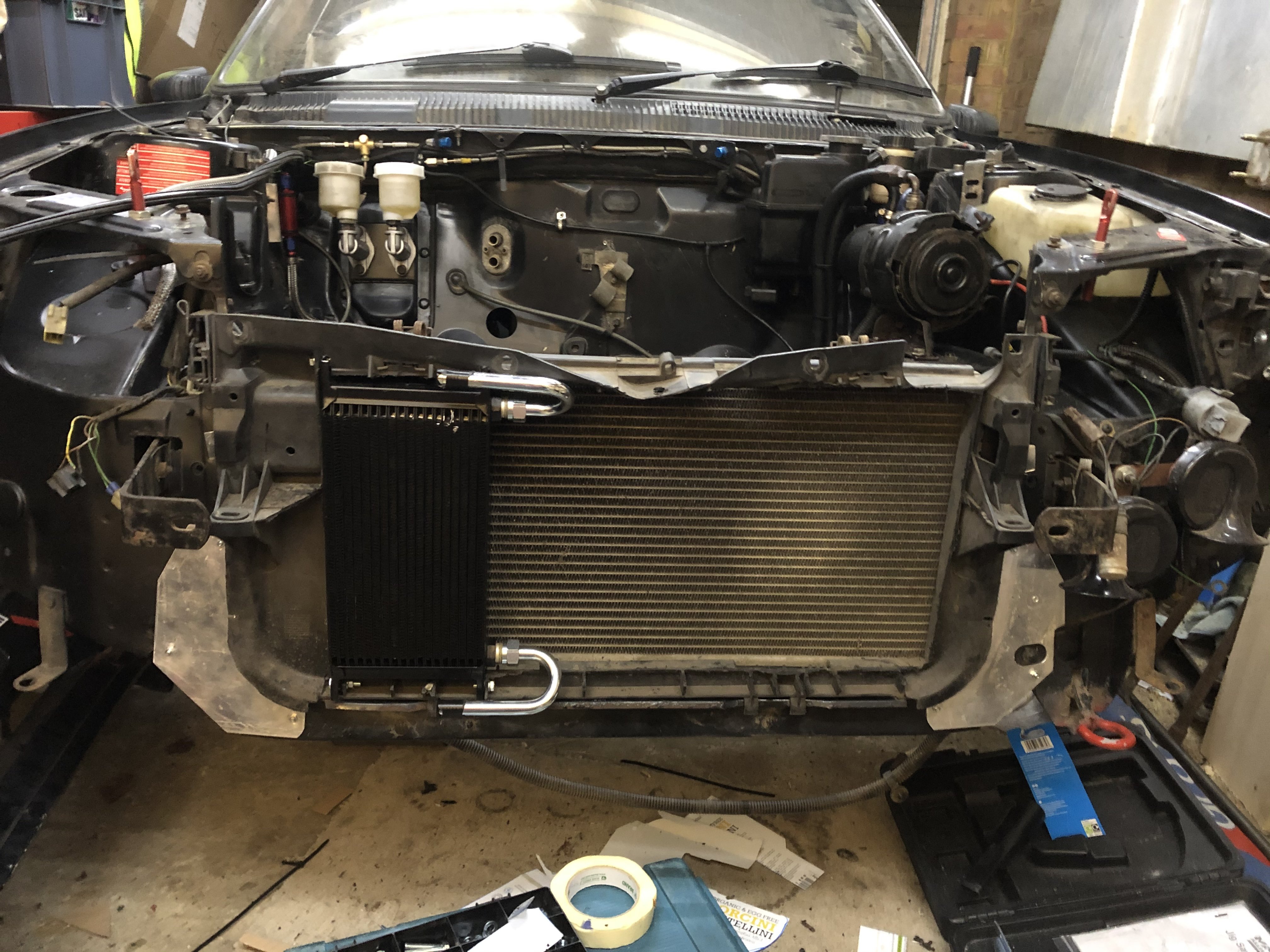

Hi, I use a std radiator - nissens, and a 19 row oil cooler on the race car.
At Snetterton last weekend it was a hot day, and oil temps were at 130 degrees, with water between 103 and 105. A bit too hot for my liking!
My setup can be seen here - uses a std cowl with fan mounts removed on a lowered cross member:

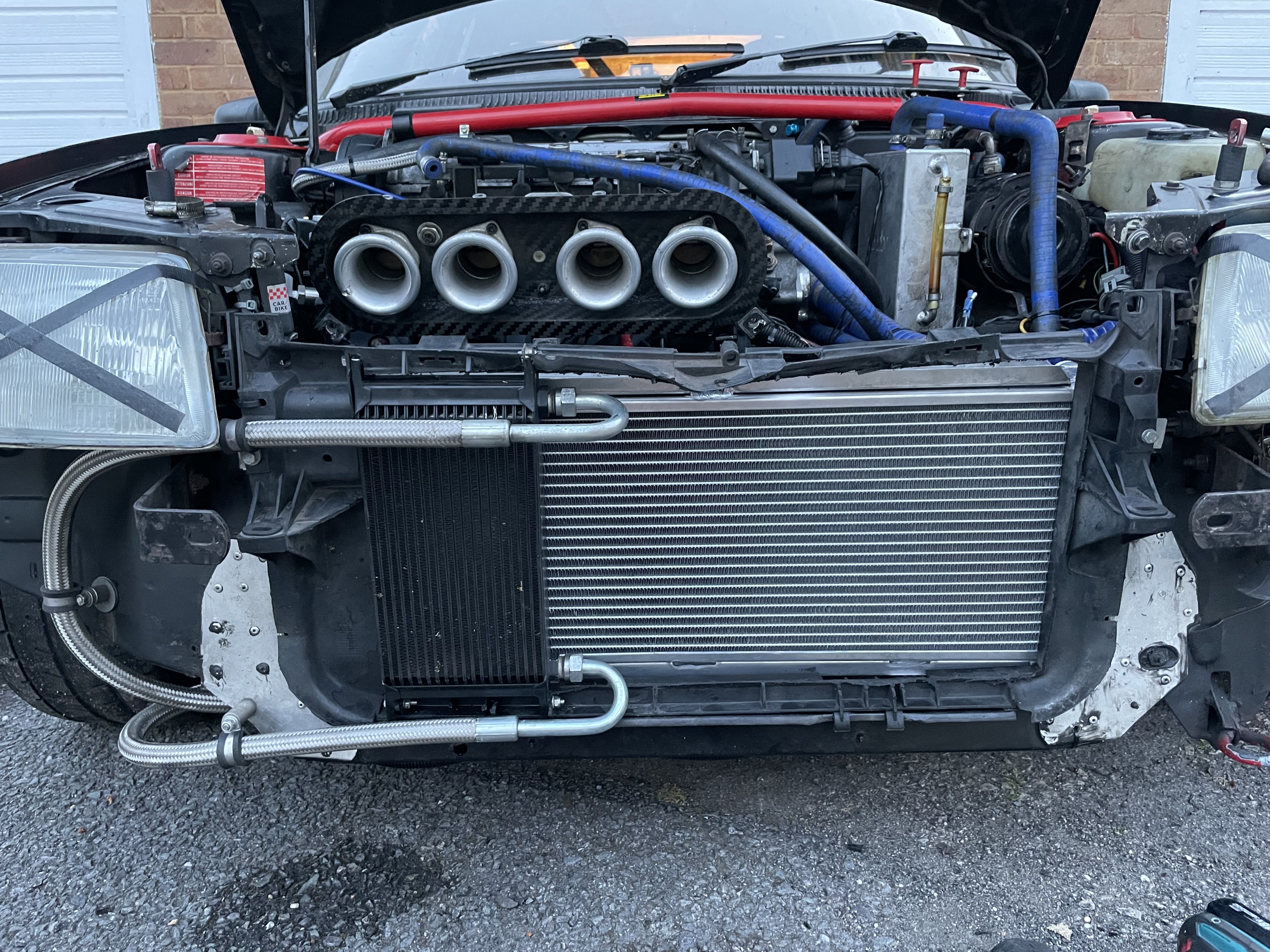

Update on this.

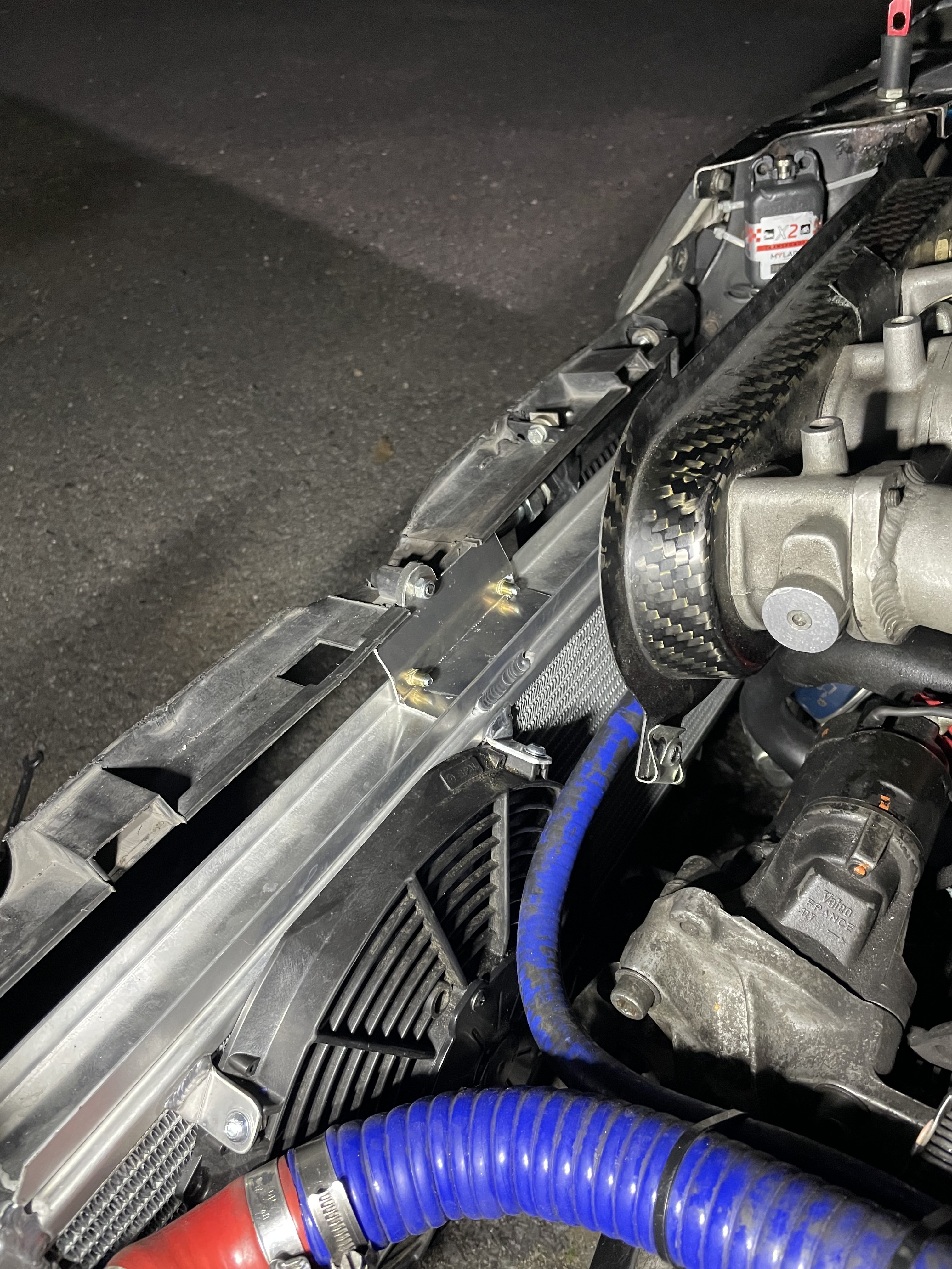

Radtec built me a 205 Radiator with a 50mm core - great service, no extra cost for the 50mm core, and they added proper brackets for my spal fan.
Took a bit of fettling to fit, as I needed to extend the brackets at the bottom of the cowling to account for the extra core thickness, and it was 15mm shorter than a std rad. @petert pointed out that the rads on the 205 AC models are about 15mm shorter, so likely it was made to the AC rad dimensions! One to watch out for if ordering an aftermarket radiator.
Anyway, an outing at Silverstone and it proven to be a success, temps now stable as follows:
Ambient temp 20 degrees
Water: 85 - 90
Oil: 110
Big improvement!
Only issue left is the 11 inch spal fan is not adequate to cool the engine sitting on idle for prolonged periods - didn't boil over but was up at 105 degrees after an hour of crawling through London traffic. I'm gonna live with that, can always switch the engine off if needed!
