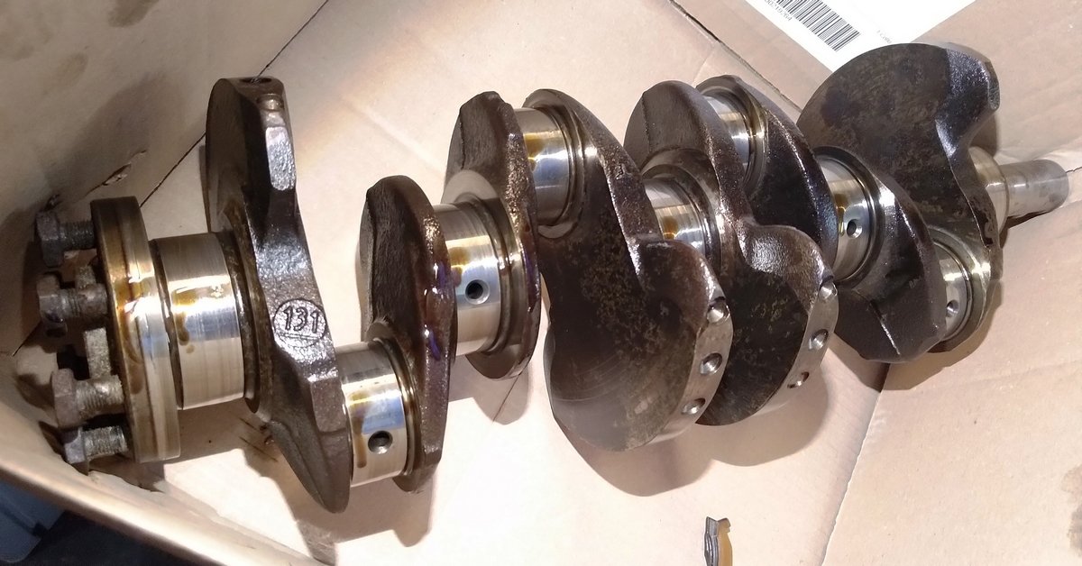

I'm currently working on a D6C engine for my 1989 BX 16v, I bought the car a few years ago without an engine.
The head rebuild has been done by the previous owner so I am doing the bottom bit now.
After taking the oil sump off I noticed that the pistons and con rods were numbered. The original crankshaft has been replaced by one with 4 counter weights, the casting numbers are 131 and A1.
Does anybody know if this is a forged or cast crank,  and if so,  where it originates from?
Cheers
wicked
Most likely just a 1.9 8v crank.
The numbered rods indicate that it might had a rebuild already; got no history with the engine?
Yes, it’s a cast iron crank, most likely from an 8V.
No history, bought it 2 years ago of a farmer.
Thanks for the info!

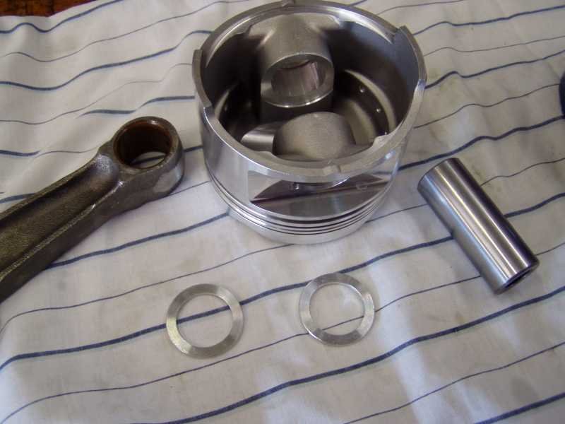

Usually, the pistons are fine and it's the liners that wear. Beware of cheap aftermarket pistons. The oem pistons are rod centred and I've never seen an aftermarket piston that is. I've had to machine the inside of piston and make thrust washers, in order to keep the thrust measurement in check. Otherwise, the rods will smash into the crank and crack the piston bosses. Additionally, the engine reconditioners need to be experienced in boring liners. Otherwise, they usually end up oval. New Westwood liners and rings are a cheaper option.
