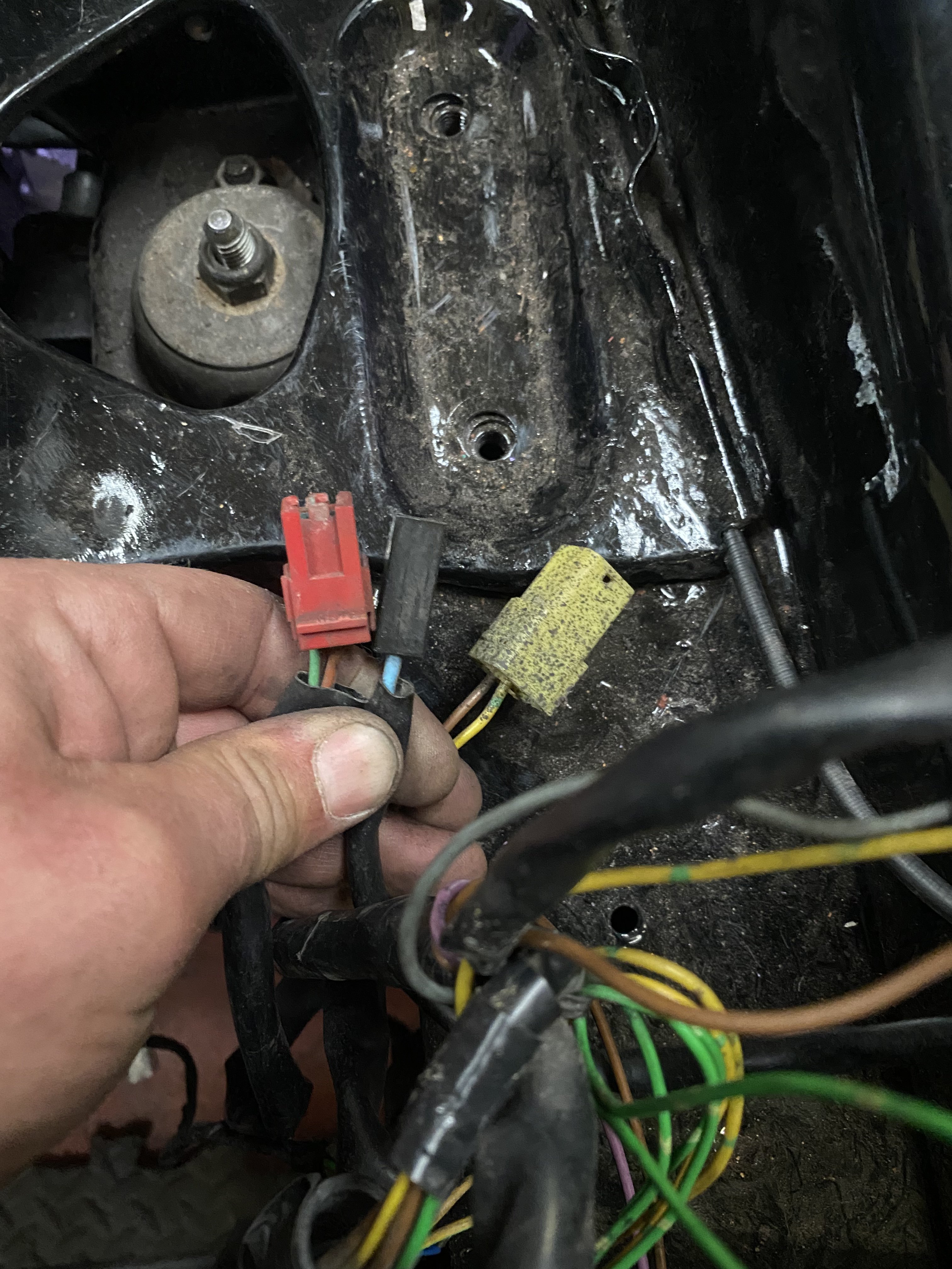

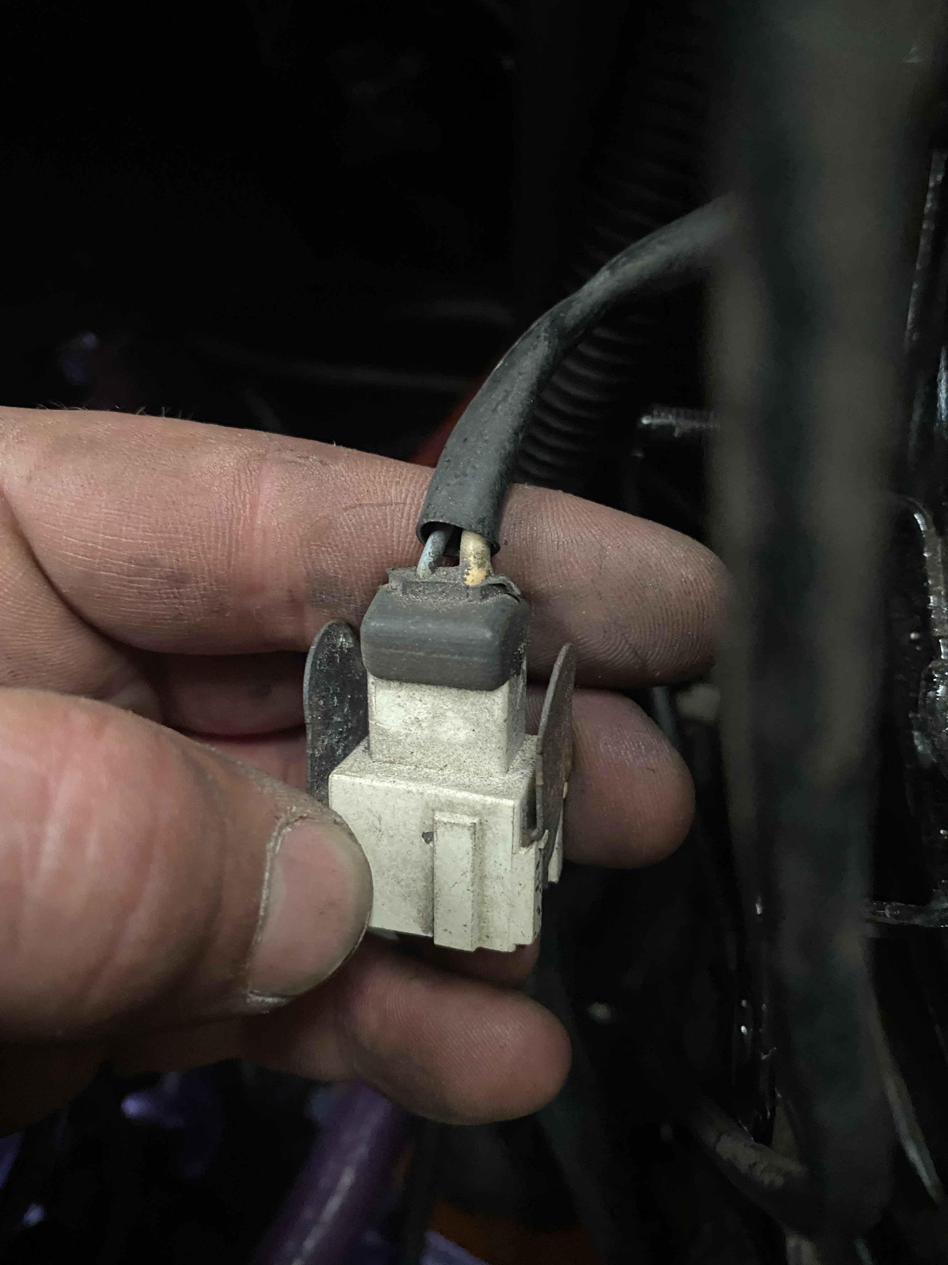

Can anyone identify these engine bay plugs
tcr
Sorting out a previously worked on car with half of everything missing
white is spare, red is spare on anything single fan, yellow female is driving lamp.
Gohn
the pale blue line looks like it could be the starter motor solenoid wire ?
it'll be numbered 46A if so
