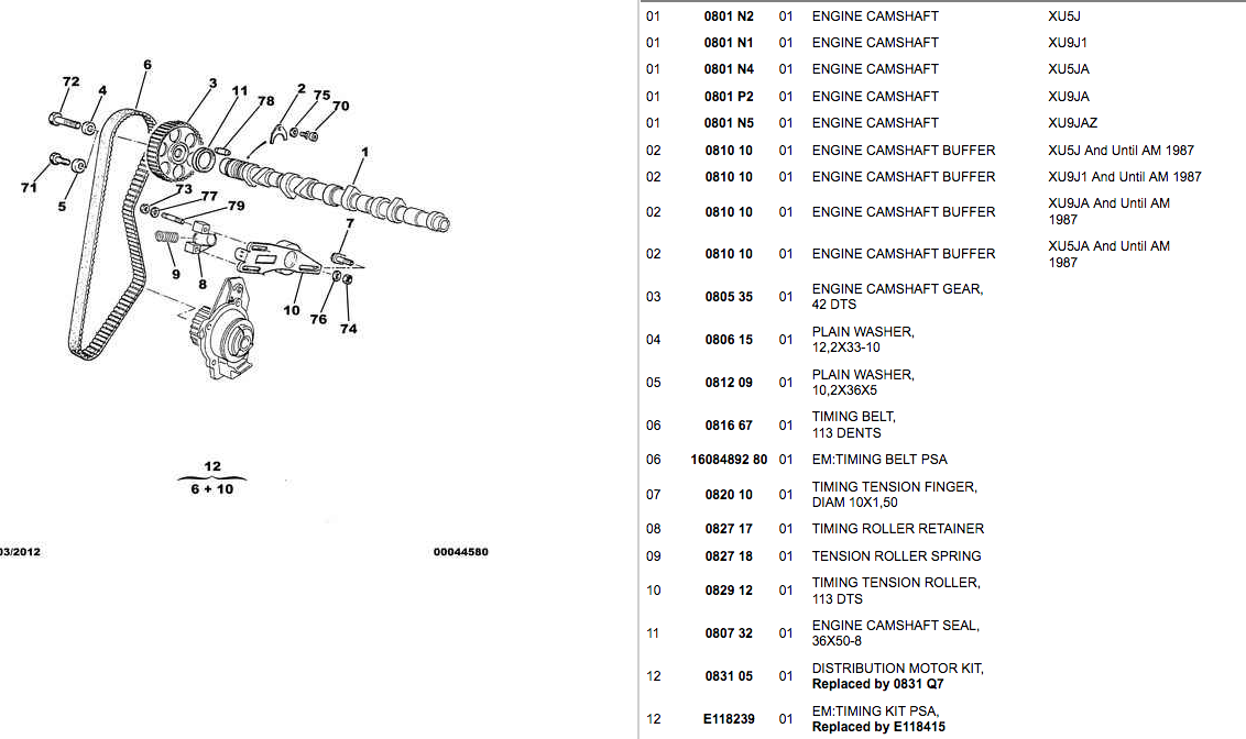

the catalog reckons your 1989 XU9 has a 113tooth tbelt
the pic below is for the earlier versions up to 1990 (so would cover yours)
487504982_ScreenShot2021-06-15at7_56_29PM.thumb.png.039d0805ec40b2110c11dbce205a290e.png
maybe the 114 tooth tbelt is for the versions 1991 and later ? (which I didn't bother checking)

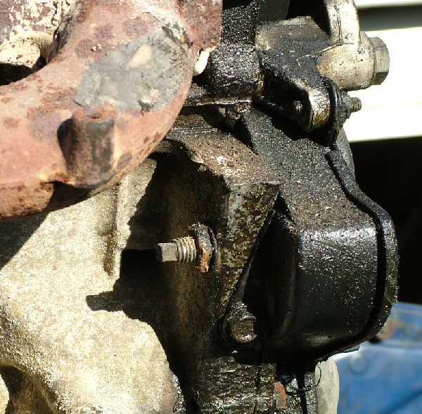

You can usually check what type of tensioner & belt combination is fitted to your engine without removing anything.
Initially, if you have the metal cam sprocket cover you will most likely have the spring tensioner as the later black plastic covers were used on the eccentric roller tensioners.
But, even this isn't an exact way to find out.
Looking down the back of the engine, just below the exhaust manifold there will be a stud with a locknut on & square end.
This should tell you if you have the sprung or eccentric tensioner.
Thats a nifty trick Graham
Does that square stud indicate you need a 113tooth belt and spring tensioner OR the 114tooth and eccentric tensioner ?
113 tooth. The square stud is for releasing the spring loaded tensioner and locking it in place after fitting the belt. There is a cam-ish shaped bit on the other end, which can be seen in the diagram above which you've posted.

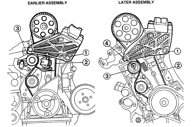

pug_ham
Sorry, I didn't make it clear in my previous reply but Thijs has answered for me.
This shows the difference between sprung & eccentric tensioners.
g
