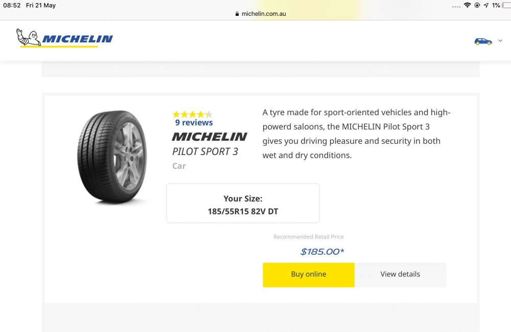

ps3 not available in 185 55, nor was pe2, nothing much sporty in that  size for some time.

are they new or old stock?  pe2 hasn't been around for a while.
